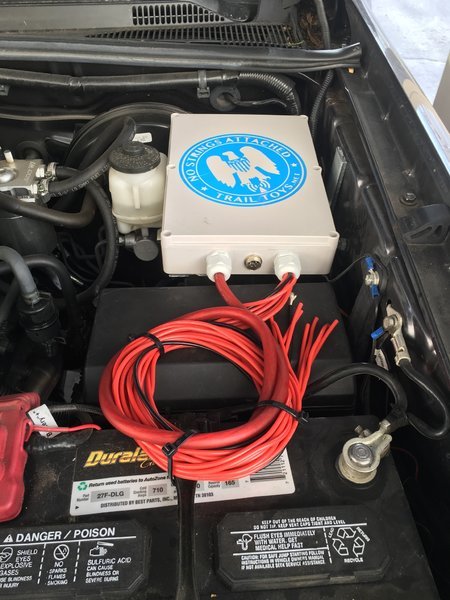

    Lookey what I got in the mail!!!!!!
    And @Blackout14 ....... I gots your patch....holding hostage :)
    Couple questions Nathan.
    1) Which fuse do you use for your block I've been looking at the Bussman 150amp have you found that's enough with a winch?. Is there something different you recommend or use?
    2) I saw a post about instructions that come with this little box of joy but I didn't have any instructions in my box or things on how to reprogram it.
    3. The little led indicator lights. Where do folks normally put that at? Do they run it to the inside or do they keep it under the hood?
    4) what kind of clip Or clamp do you use on the 4g big positive lead?

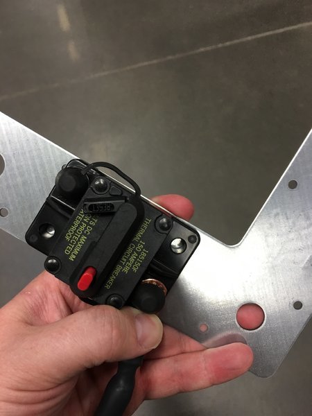

    I'm out at Katemcy this weekend John, so no pics with the post. I use a blue sea switchable circuit breaker rated for 150 amps.
    You're hooking up to the solenoid on the winch, so it's a low amp draw.
    You'll want an enclosed 4ga ring terminal, more like three, for the power wire.
    I'll answer more questions tomorrow when I get home.
    I used the blue sea switchable 150 amp circuit breaker. Again, it's a low amp draw powering the solenoid.

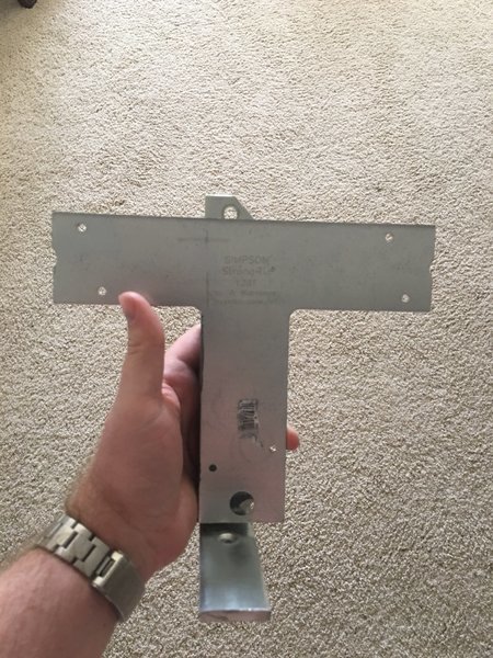

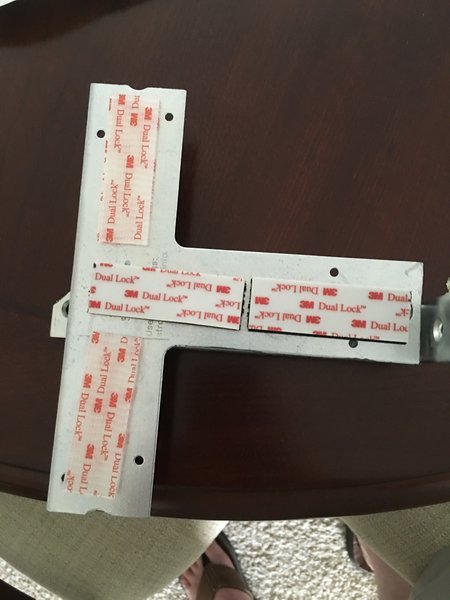

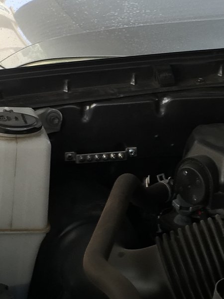

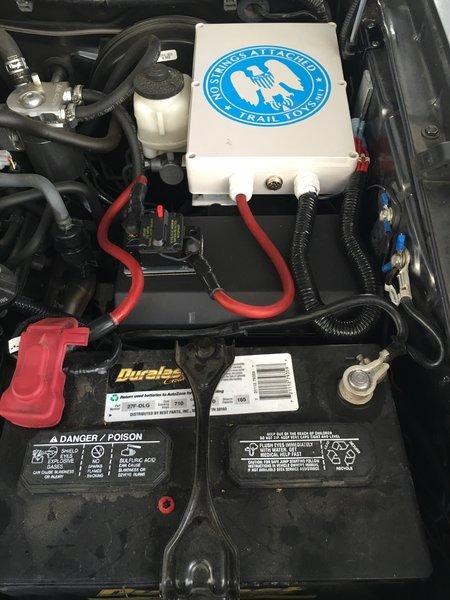

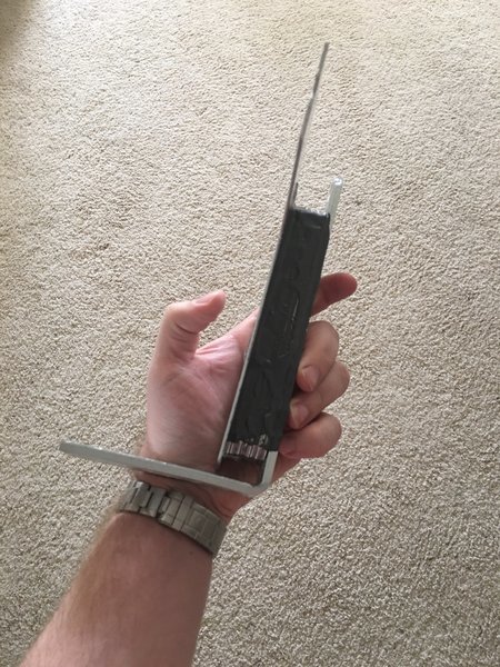

    Negative Bus that I got on Amazon....Rivited it into place.
    Letting the Epoxy Cure on the steel shims I used to elevate the T piece
    Cut a Piece of the T shaped bracket and epoxied it to the bottom of the inline Fuse so that I could more easily put Velcro on it.
    Theres the Velco on the T piece that I cut to fit into the spot
    What it looks like all set up. You can see why I used that T shaped Bracket and the wires all come up above the Fuse Box. Everything is velcro'd down that shit is NOT moving. It takes 10lbs of force per 2"s and I have 4 of those suckers down there. I can get to my fuse box very easily.
    The Finished Bracket all cured and ready to go into the truck. As I said it's not pretty.....but damn it works so nicely.
    You can see the Buildup here that I used

    I'm happy you're enjoying your NSA John. And the velcro trick works just fine. I've had mine secured with velcro from day one, no problems whatsoever.
