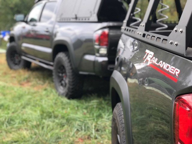

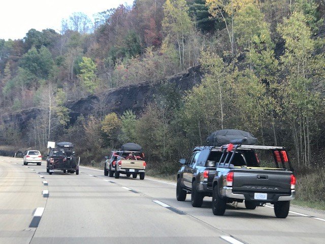

    Hey everyone I was headed to Overland Expo East 2019 [OEX] in Arrington, VA this weekend and saw lots of neat rigs. Some of the most unique were these Tacoma beds that had been converted into trailers.
    I saw them on the highway headed down to the event and snapped a picture. Then at the event I saw their camp but didn't get the chance to catch up with them. Did anyone get the scoop on how they made them?
    Thought I'd share the neat build and see what you all thought of them? Pretty solid in my opinion. Anyone else see anything cool or pics of your rigs?

    Yea I’m very curious as to what was going on! There were two matching trailers one tan and one MGM, with matching TRD pro rims. Super cool builds!
    How much is he selling custom frames for? And do they accept a Taco bed or is it a fully custom overlanding trailer?
    Also I didn’t see any axels under them not sure how they did that. So it’s not completely a taco bed just chopped off.
    Haha I’m not sure, maybe that’s all they could find on Craigslist? Maybe the long bed would look a little bit more proportional. I wonder if a long bed trailer with a long bed truck would look weird?

    The problem with using a Tacoma bed, is that the axle ends up too far forward. You want a 60/40 placement on the frame.
    Its going to be tough to get enough tongue weight on it to keep from swaying at speed IMO.
    if I were going to build a trailer out of a short bed Tacoma Bed, I would build the frame longer than the bed, set the axle in the appropriate location, then build a
    platform with the extra space at the front for more storage or whatever.
    That would be the correct way to build it anyway.
