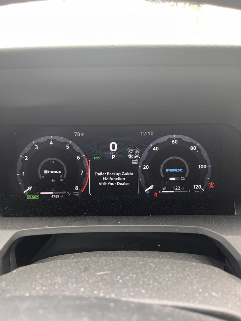

    This error randomly popped and hasn’t gone away. I don’t even have a trailer and have never used one. Annoying part is none of the cameras work now, no backup cam, 360, nothing. Called dealer and I can’t get seen until May 1st so two more weeks of driving with no cameras and an annoying pop up that doesn’t stop.
    Anyone ever seen this error and have any fixes?
