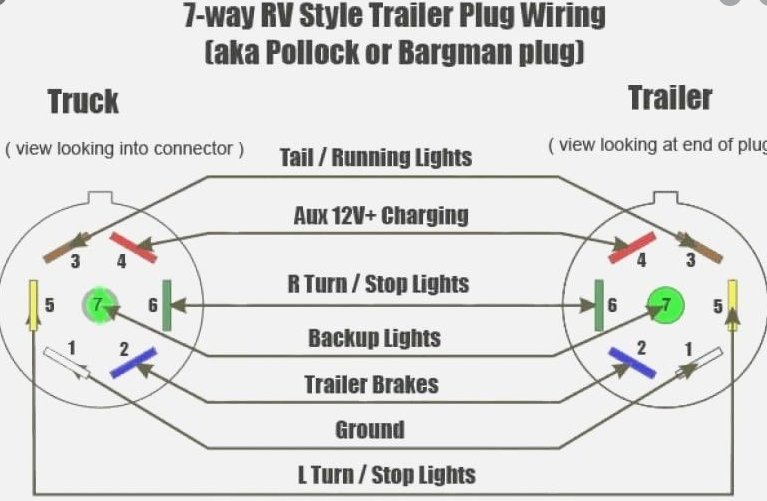

    Thanks -- You're probably right about the wiring at the taillight itself. i'm going to take a look later today. The running lights along the side do turn on with the headlights, which also fires up the bright filament on the tail lights. My guess, if I get into the back of the light on the trailer is that I would see 2 hot wires coming in on each light. one for the tail/running and another for the turn/stop signals. If I swap those it should light the correct filaments. I'll dig more into this in the afternoon and report back.
    For the 7 pin connector portion, I must be missing something because it's not clear to me what I would do different. Using the example below there is a single #3 Tail / Running lights input and then an input for each turn/stop (#1 and #6). So I don't know what I would swap in this case? If there were a L tail/running and a R tail/running I could just swap those with the L/R turn/stop, but that's not the case.

    [QUOTE="
    THANKS!!![/QUOTE]
    Yeah, disregard what I said, it won't work. I have no idea what I was thinking on that part. Sounds like the wires got mixed up in the housing
