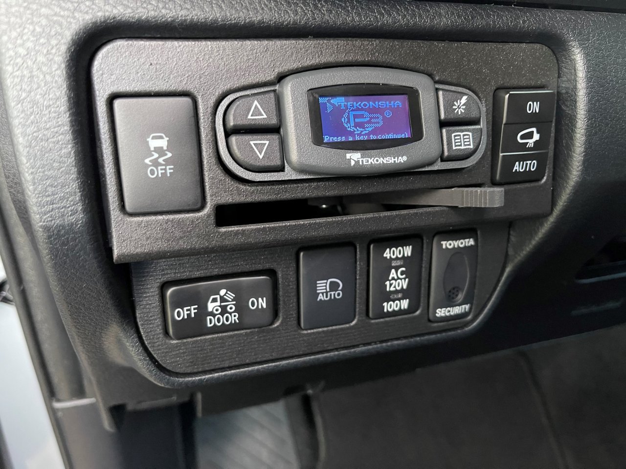

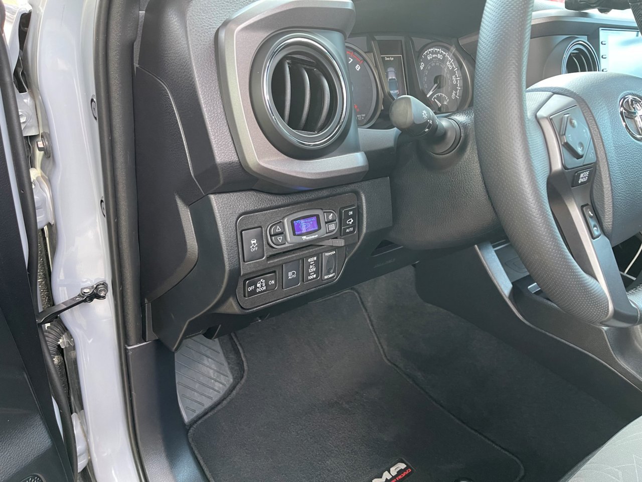

    here's mine with Meso's panel.

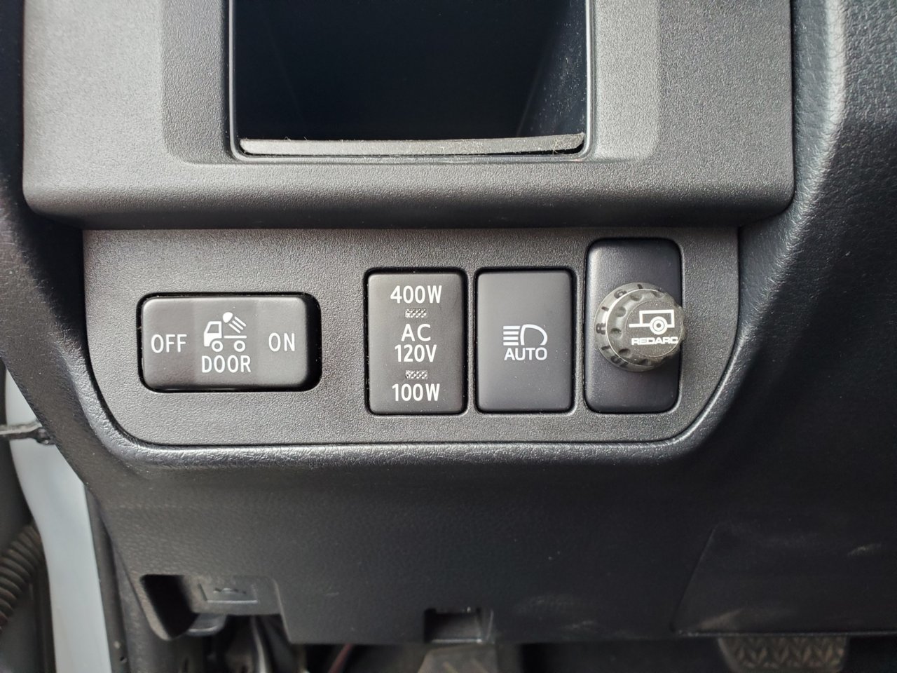

    I used a Redarc on my 2018. Love the clean look on install.

    130 for Meso's panel and 184 for the Tekonsha P3 + plug and play harness. (314)
