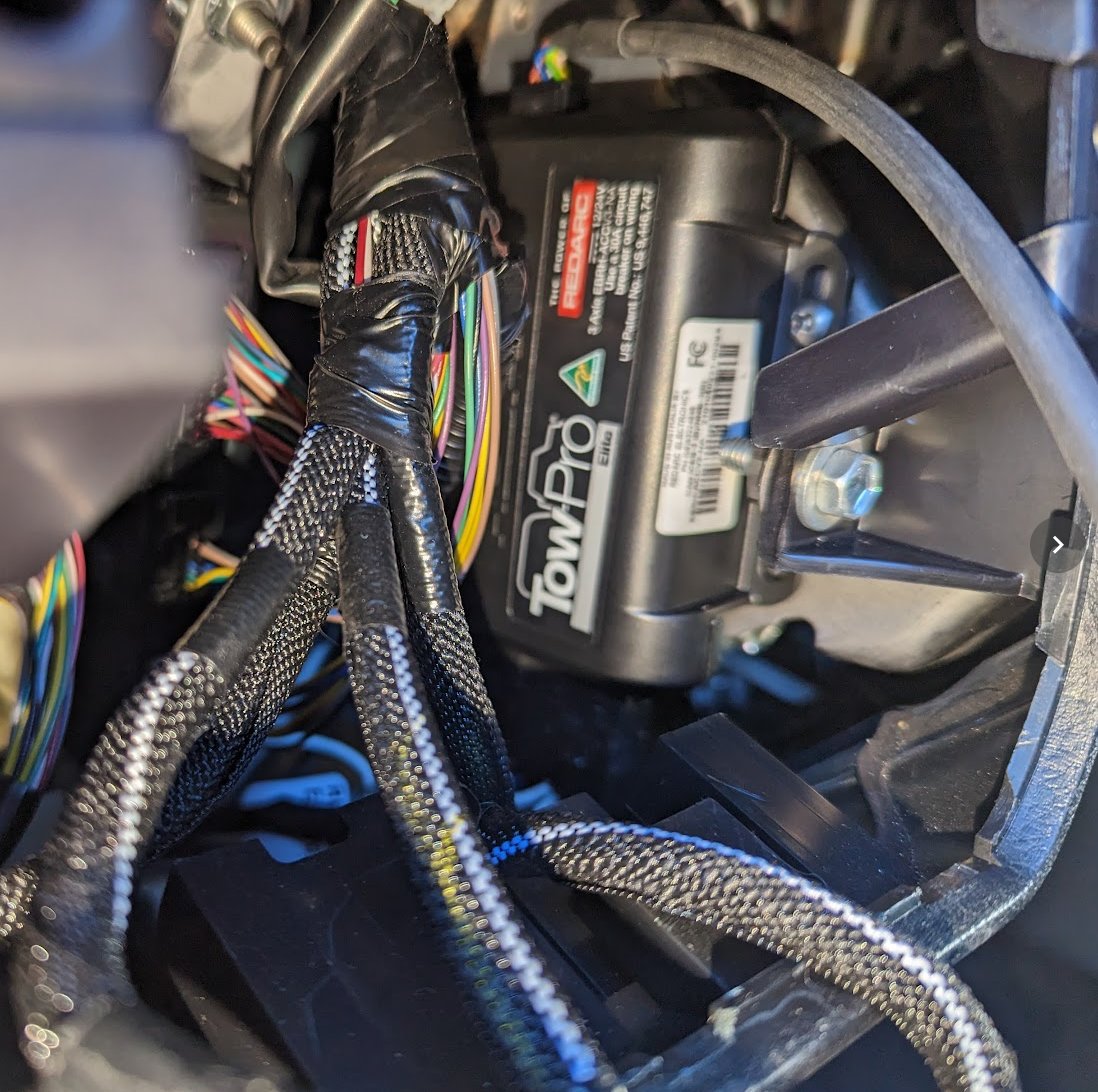

    Here's where I mounted my controller. In full disclosure, the controller took a little work to make it fit as shown in the photo below. I recommend purchasing a controller mount but keep in mind if you have a truck with the Premium package you may have to use the odd shaped dash blank like I did. As far as the module goes, I mounted it under the dash to the brake pedal bracket using heavy duty zip ties. It's VERY solid.
