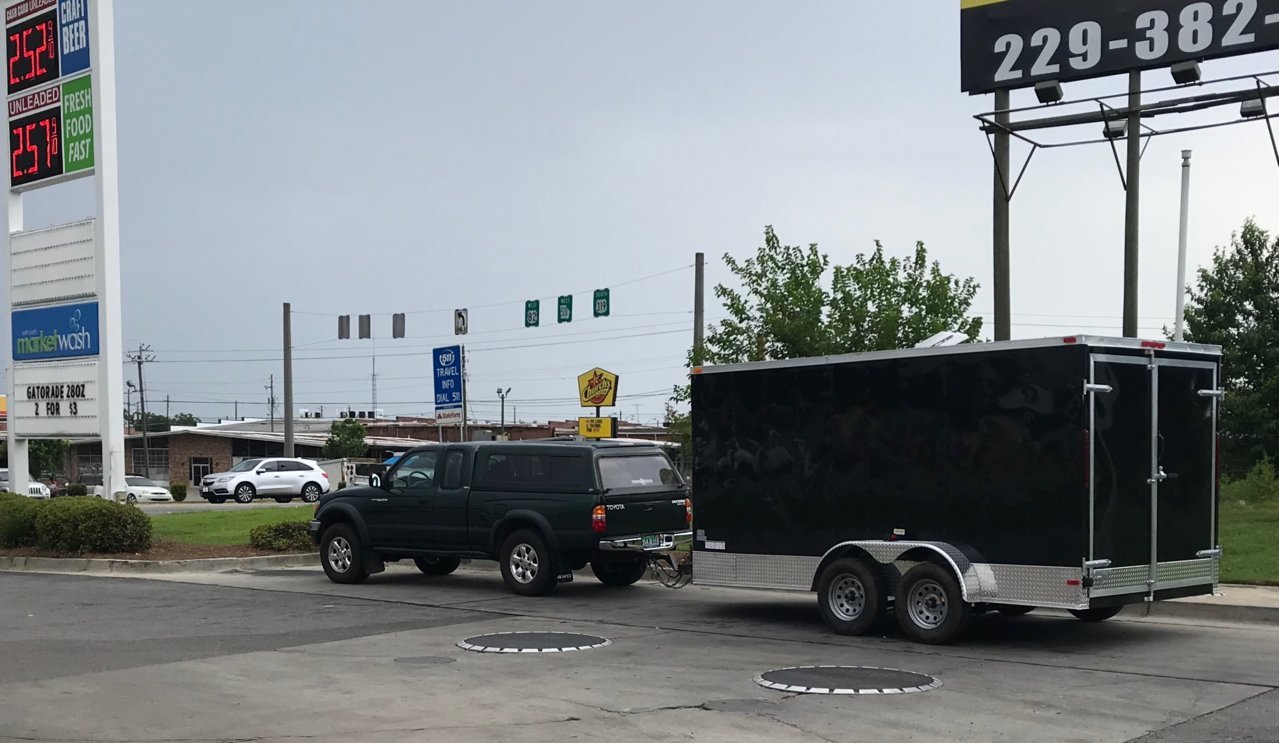

    I installed one on my 2001, and it wasn't difficult at all. You do have to go thru the firewall with a couple of wires however; still easy. I bought this one, and it worked perfectly!
    https://www.etrailer.com/Brake-Controller/Tekonsha/90195.html
    I used to have a F350 4WD Diesel Ford for towing, and it had a factory-installed trailer brake controller. This Tekonsha did everything for me that the Ford controller did; was 100% satisfied with it, and I REALLY liked being able to completely remove it when I wasn't using the trailer. I mounted it at the bottom of the dash, just in front of my left knee.
    I pulled this 14' x 7' trailer 4,300+ miles in 2 weeks from Michigan to Georgia then thru the mountains of Colorado (Rocky Mountain National Park - 12,000' !), and this controller rocks!IMG_1894.jpg
