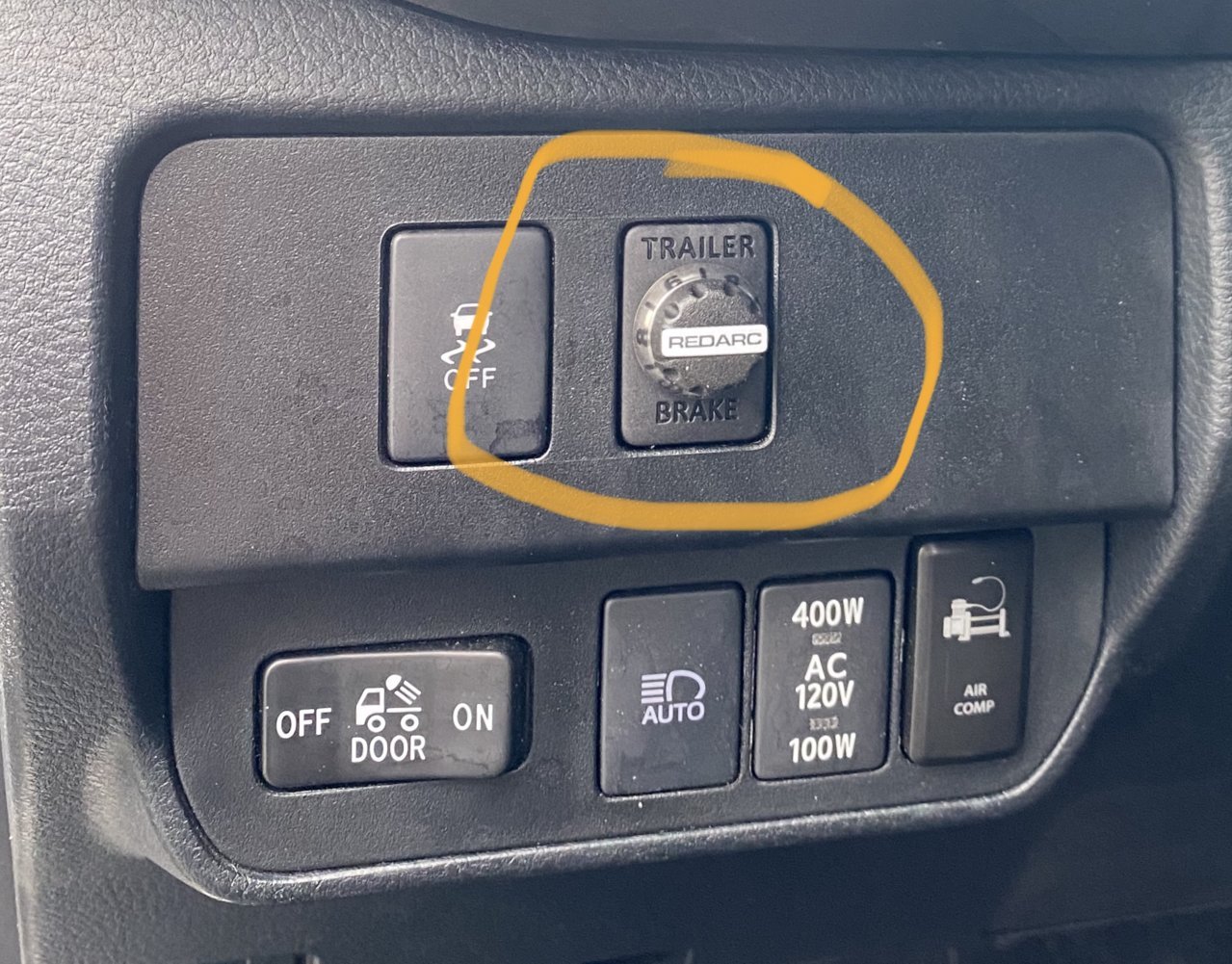

    I couldn’t be happier with my redarc elite. The box hides behind the dash and leaves you with just a knob on your dash. The only solution that looks factory

    I installed a Redarc elite in my 2020. It works well and is a SUPER clean install.

    That looks so good in the panel and so much like an OEM set up.
    I been struggling with how to mount my Tekonsha PrimusIQ so that isn't in the way of the knee air bag or my knee getting in and out. I decided it's not really worth my time messing with locating a cubby from a 16-19 and fitting it to my truck. Decided to look more in to RedArc. I found they have a new model called the tow pro Liberty. Its more for highway towing, does one to two Axel's. It's sets up the same as the elite and classic did with just a knob visible. The best part it's just $135 for the unit it's self. Since I tow a pop-up camper, borrow a utility trailer and will likely never get a much bigger camper this product seemed like an excellent fit for my needs. The elite can do three axels and is better for off road towing if you overland but those features are likely not any I'd benift from. So I ordered the Liberty model from RedArc directly this morning with a factory harness and switch insert for Toyota.

    I switched to the Redarc Elite with the knob and it just makes everything more factory looking and confidence-inspiring, which is really one of the most important aspects of towing.
