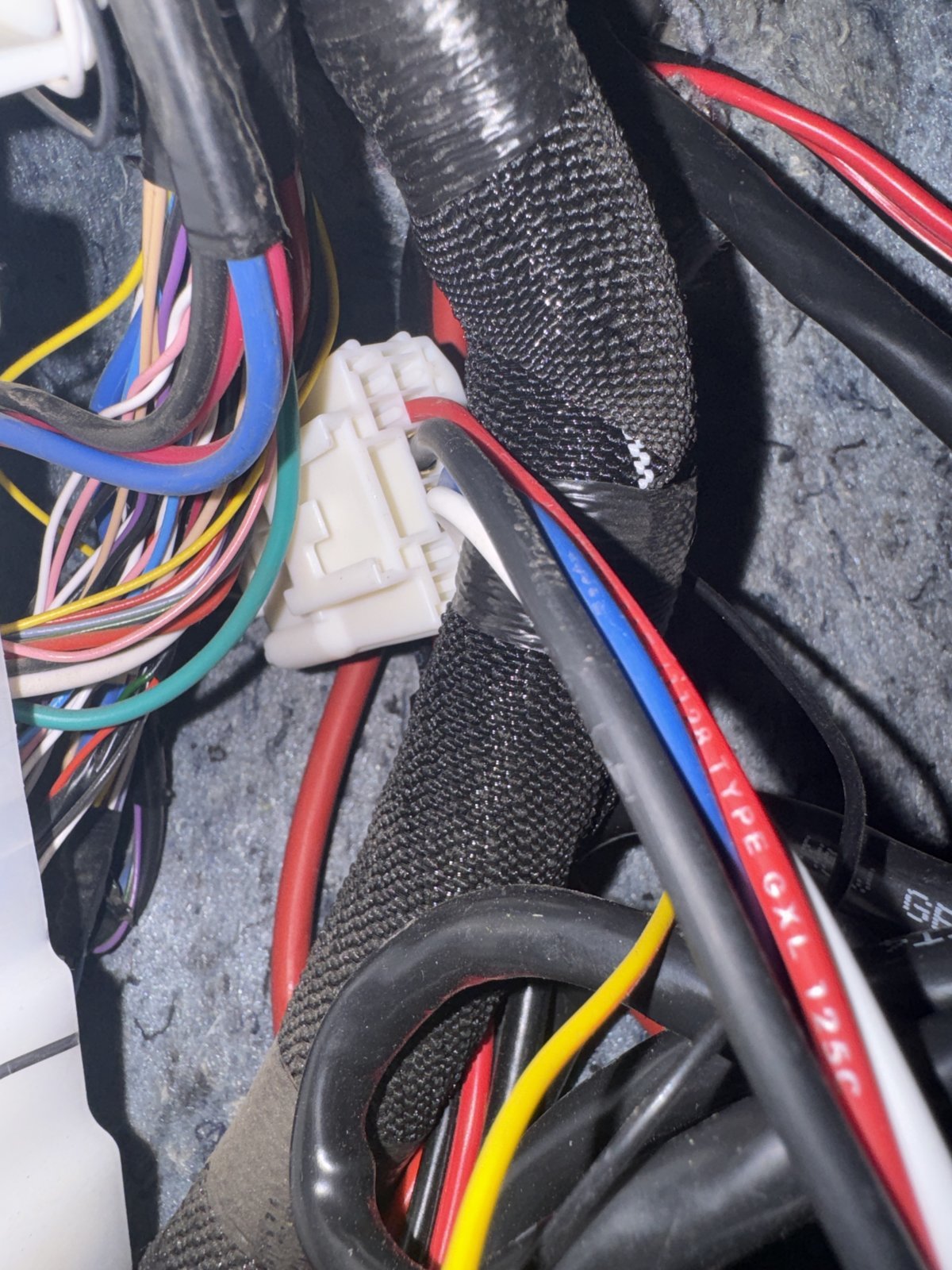

    Im looking all over my 2022 SR Ac2wd, cant come up with this plug. Do some Tacomas have this deleted? Ive got the kick panel and lower dash apart.

    See previous post. It's behind the left kick panel. You have to unscrew the little plastic nut and pull the panel off. There's a few clips also holding it.
    There is a bundle of wires way up to the left. The plug is a bit hidden you may need to feel around to locate it.

    I went with the Redarc Liberty and highly recommend it. And yes, the connector is tucked back in there. I had a hard time finding it as well.

    Lol, Im all up in there and not seeing it. I just ran thru my window sticker, nothing about towing on there. I think they saved a nickel on my harness!

    Im going back in. But Im upside down, ran my hand everywhere. I found a tiny black connector about 1/2"x1/2" but thats not it. Thanks guys.

    This kinda looks like a dead end connector but Im not ready to pry on the thing to pull it out just yet. Ive gone up n down ever wire in there.

    This is the only connector I find up in that nest. AF1657C7-44E1-4463-9311-4C80D5E44915.jpg

    White, blue, green wires to the black plug.... if thats it... I guess my Redarc isnt gonna be plug in after all. Lol. If anyone recognizes that as it I appreciate the guidance.

    Been a while since I did mine, but the plug should be white. Mine was close to firewall towards the bottom near the floor panel. It takes a little bit of digging but you’ll find it.

    That's not it. It's a wider connector than that. Mine was literally tucked back in there. Took me a while to find it.

    I pulled the lower dash again, ran my hands down all the wires and boxes. Still no plug. Drat. I can see everywhere except behind the white junction box thing and I can see the wires going down the back of that go into a plug in use. Drat again!

    Man that connector was buried in there. It took multiple days of looking and giving up. I found it behind the kicker panel, way up against the firewall, behind the large black wire harness and the white connector receptacles
