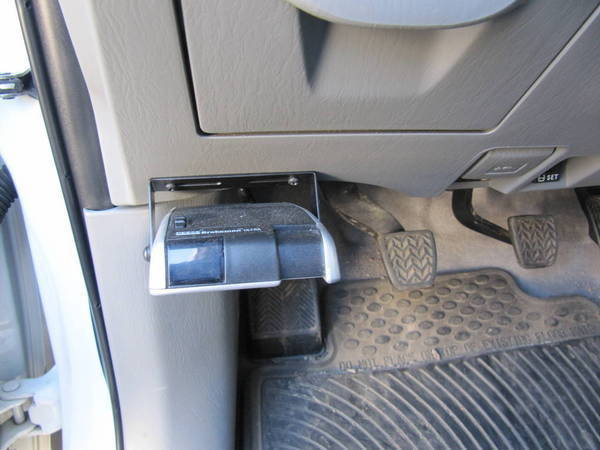

    Here is mine and where it is mounted. Works great for our 7x16 enclosed trailer with 4 quads in and gear. It is a REESE 835. Have one also in the Wifes Tacoma as well for her horse trailer. So far they have been great and we have had them for about a year now. Very easy to install and hook up.
