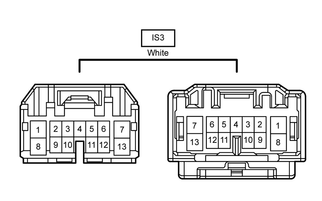

    Check this connector here (assuming you tapped into it):
    Make sure it's seated all the way and there are no recessed pins. I would also check the ground if that was removed as well.

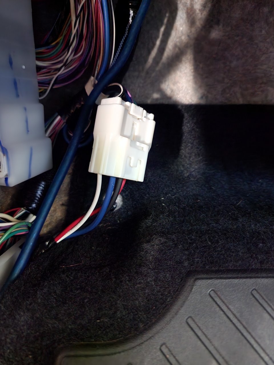

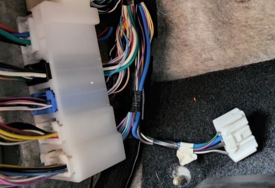

    Is this the pre-wired harness for the BC?
  4. Jul 11, 2022 at 9:38 AM
    caribe makaira
    caribe makaira Well-Known Member
    Feb 13, 2011
    #51121
    11,786
    Caribbean, Puerto Rico
    05 PreRunner TRD Offroad AutoTrans
    Hood Struts, My version Fogs always ON, Map & Overhead Light Mod,
    No, it is NOT.

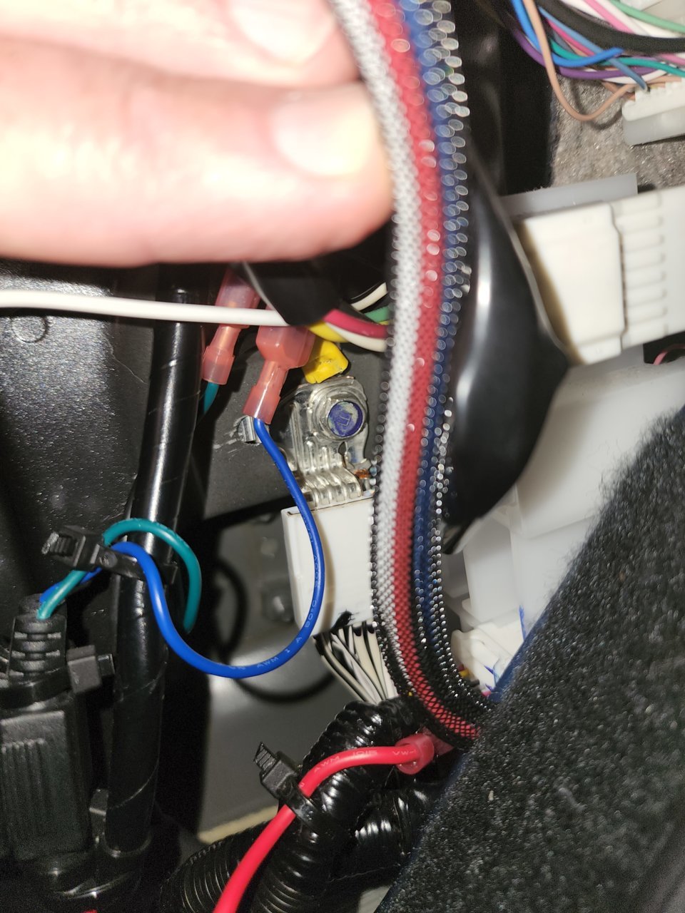

    That's what I'm plugged into.
    First image is the plug, the second is where it is grounded behind the kick panel. (Ground is the white wire barely seen)

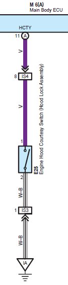

    IS4 & IS3 are on Passenger side kick panel...

    Mess with any grounds then?
  11. Jul 11, 2022 at 11:31 AM
    OkieJumper
    OkieJumper [OP] Member
    May 12, 2020
    #327862
    19
    Just grounded it under the left kick panel
  12. Jul 11, 2022 at 11:34 AM
    ktbell444
    ktbell444 One who throws exceptions
    Aug 8, 2017
    #226306
    2,969
    ᚺᛖᛚᚺᛖᛁᛗ
    I believe that's the same ground that the hood switch uses.

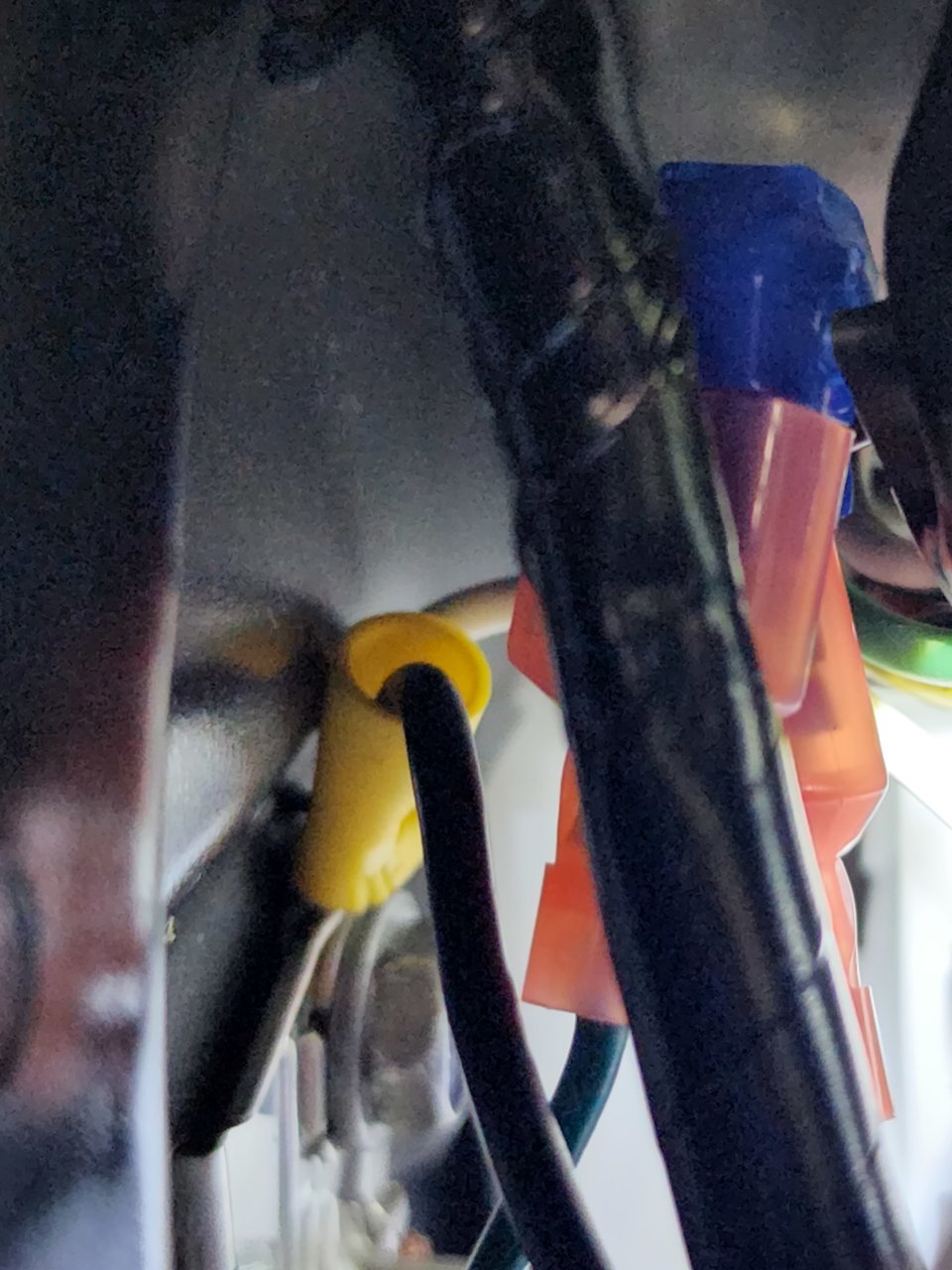

    This is where I grounded it

    Try this: remove the connector to the hood pin, place a small wire jumper on the exposed terminals inside the removed connector. Have someone verify if the indicator goes off.
  17. Jul 11, 2022 at 12:43 PM
    #17
    OkieJumper
    May 12, 2020
    #327862
    19
    I tried something similar with the old sensor wire. I snipped it off, exposed the two wires, twisted them together then plugged it into the plug attached to the truck under the hood. No difference. It stiĺl shows Hood Ajar. Is that similar to what you suggested or different?
  18. Jul 11, 2022 at 12:43 PM
    #18
    caribe makaira
    Feb 13, 2011
    #51121
    11,786
    Same.
