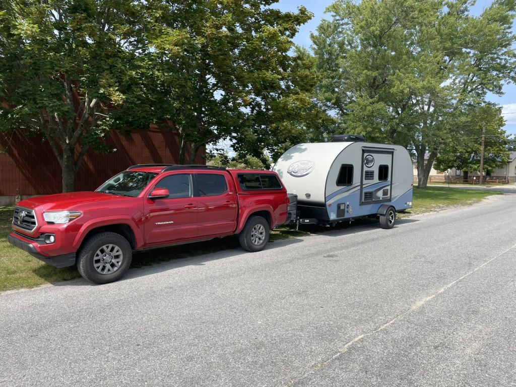

    It's a Forest River R-Pod 180 and it has electric brakes. I hauled it home yesterday without incident and it seemed to tow well and stop with no problem. I have a torsion hitch and, from what I understand, it can equalize the tongue weight on both axels. Truck and camper have a 7 pin connection. I'll start on the towing bible tonight, thanks for that. Any suggestions on a controller? Someone on another thread suggested a Redarc. I saw a
    REDARC Electronics CIKTP-NA-003 Liberty Brake Controller Kit Fits Select Toyota Tundra/Tacoma at Jeg's and it appears to be custom fit to the Toyota dash. A bit pricey though.

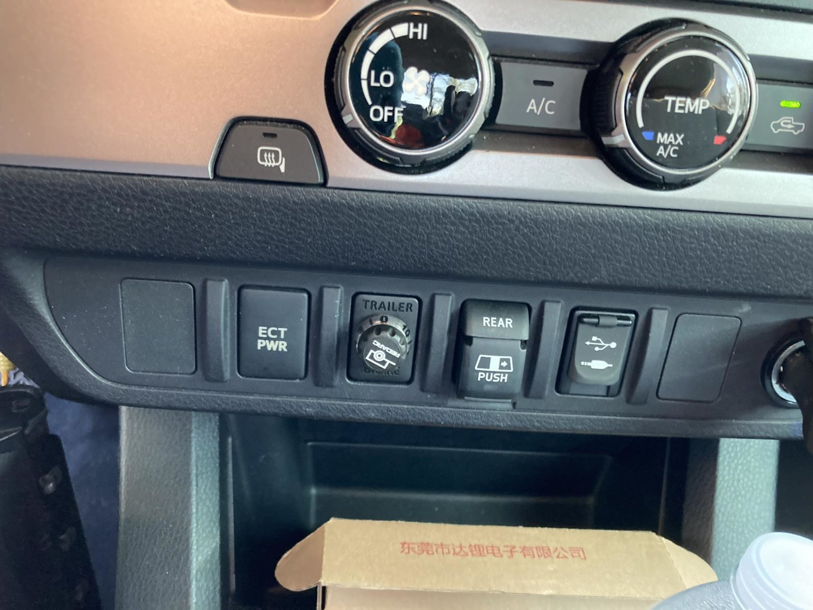

    Here will be the big difference. The Redarcs are going to only be visible by a single knob and will appear "factory." The Tekonshas and the Curts are going to look like this:
    Some people like me put them under the dash, other people have a custom panel made and stick them in that little tiny cubbyhole.
    Versus what you see on a Redarc [as posted elsewhere by another member]:
    And now the one, minor downside to a redarc: its not as easy to honk the manual brake button when you are fumbling for it. I have needed that button exactly twice while in motion, once in the Tacoma. Both times I was in the mud on an off-camber road, and the trailer wanted to hook me into the ditch. A quick pulse of the trailer brake brought it back in line.
    Other times, its damn convenient to use as a truck-starting device when doing maintenance or hitching the trailer - grab brake controller, push start button. :cookiemonster:
    ^^ both of those things are possible with the redarc knob, it just isnt as easy.

    Easy access to the unit's brake control is a huge plus. I'm always running hugely variable trailer loads, so being able to quickly test the brakes and adjust the gain is a big help. Not as big a deal when just towing one trailer that's about the same weight all the time.
    I'm not even sure how you use the brakes on the Redarc one.
    Rock Lobster[QUOTED] likes this.

    You push the knob, kind of similar to a power/volume control knob. My clumsy meathooks would not be able to find that blindly and push the button without rotating the gain. But again, I want to make clear that I'm picking at nits here. :D
