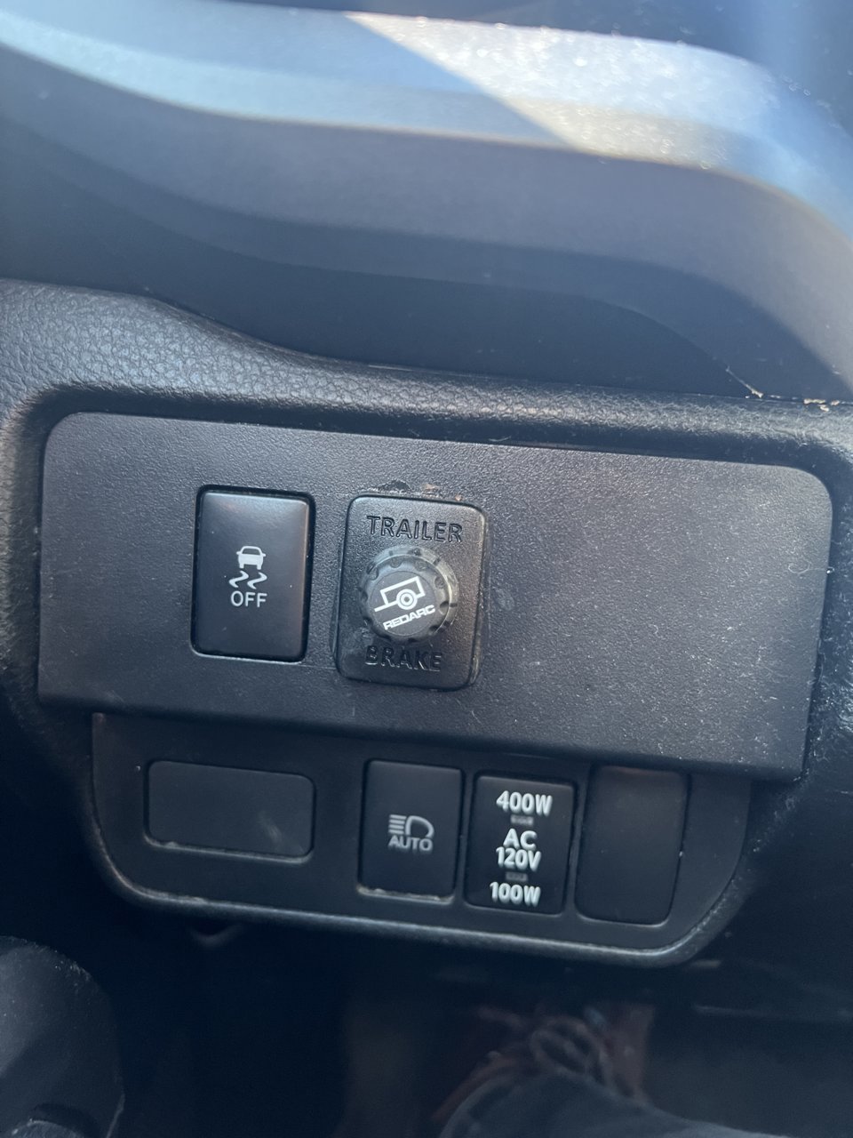

    You definitely need a brake controller. As others said the Redarc pro is the best one for the Tacoma. It has a way that it's installed that only the one controller knob is seen. Nothing to bang your knees on.
    There's a Liberty model and an elite. The elite can do triple axle trailers and has some modes for off road towing. The Liberty is made for on road towing of up to double axle trailers.
    I have the Liberty in my truck. I'm only going tow on the road so that more affordable model is perfect.
