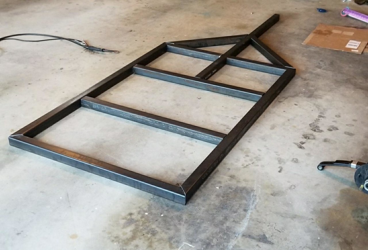

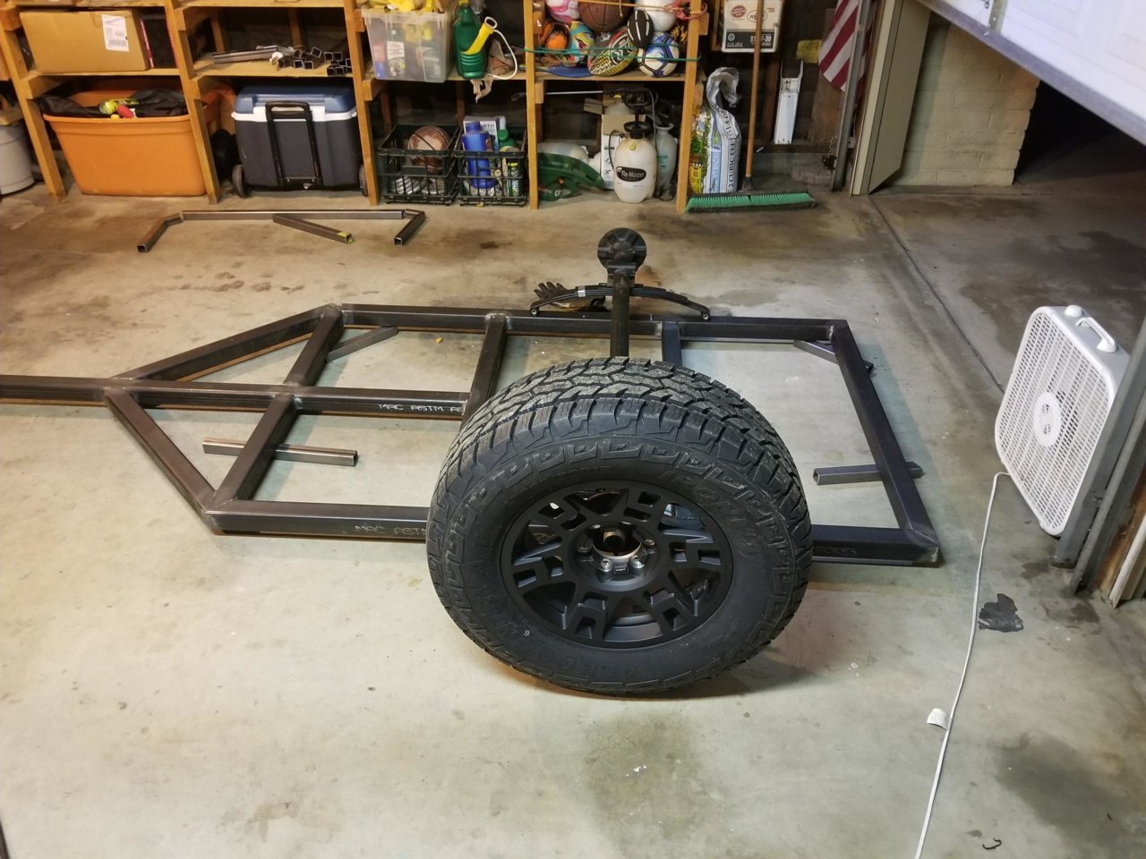

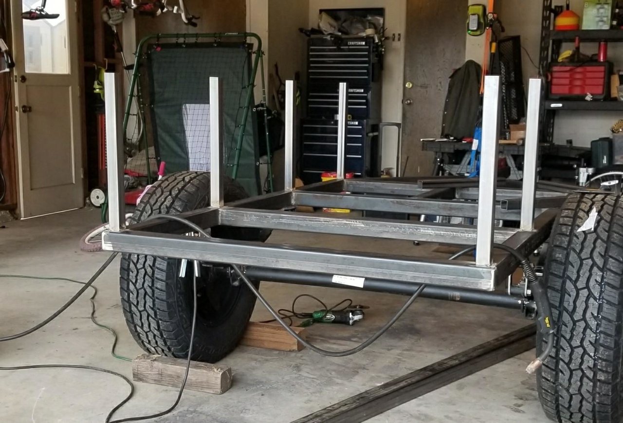

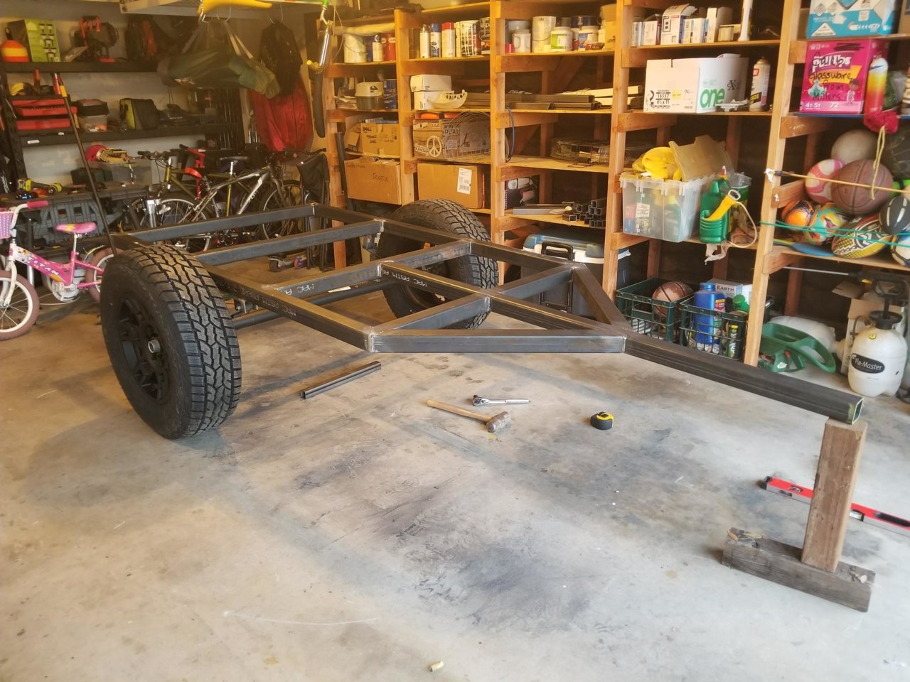

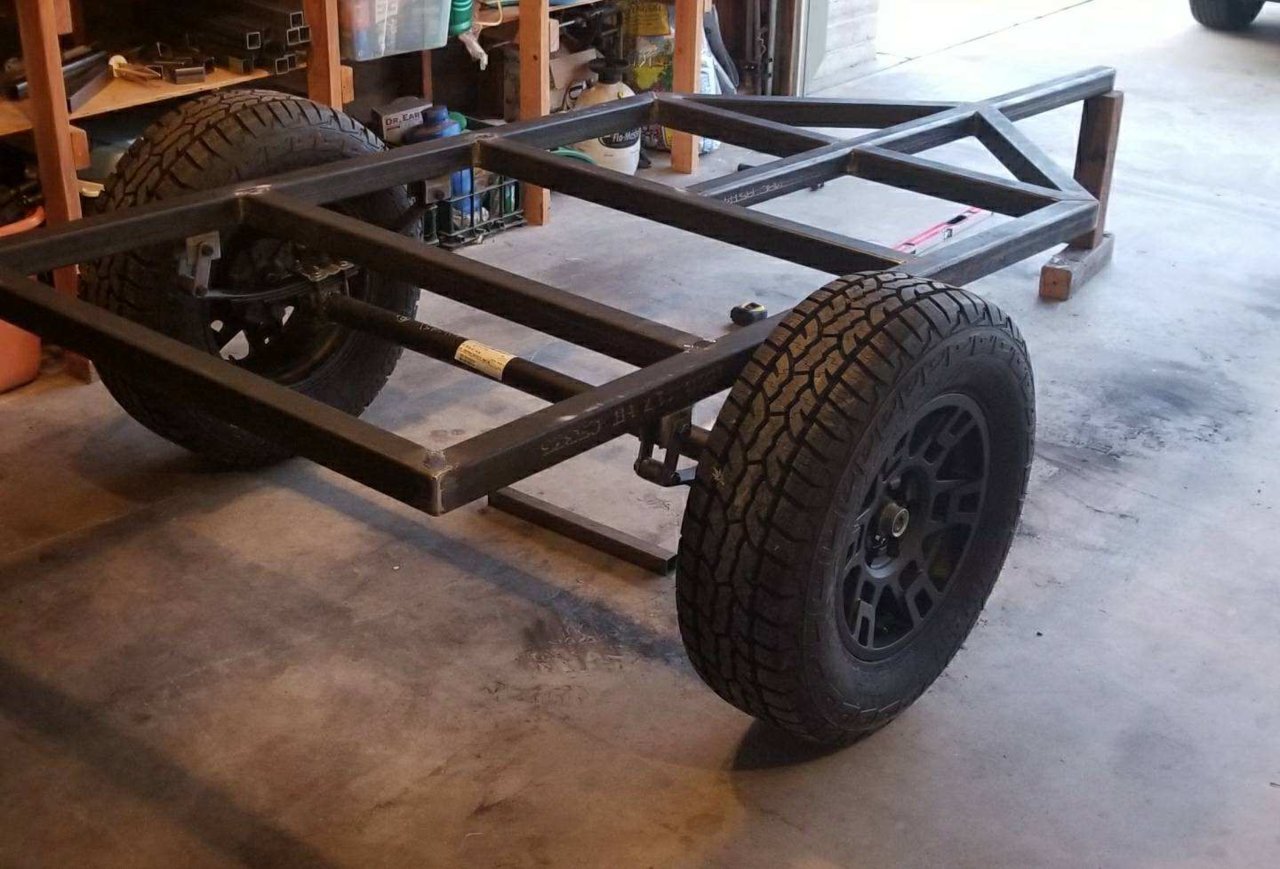

    This frame pattern seems to be the standard for most builds. Here it's all laid out ready to be tack welded.
    I purchased a 3500# Dexter axle without brakes. The hub has the same bolt pattern 6x5.5, so I won't have an issue if I have a flat. The TRD wheels were a big splurge. Here we're getting the perches and spring centers set. I flipped the axles to give it a lift

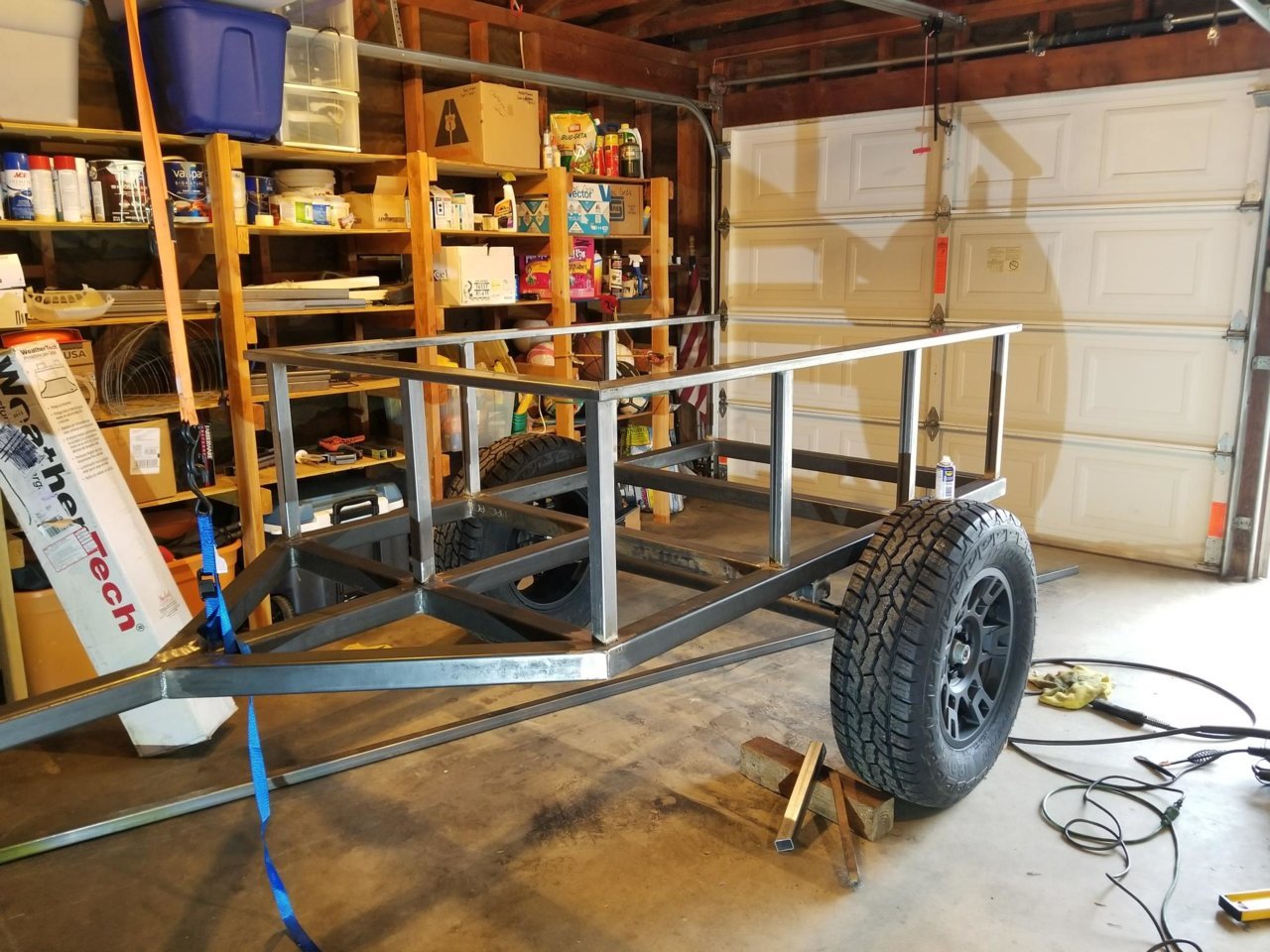

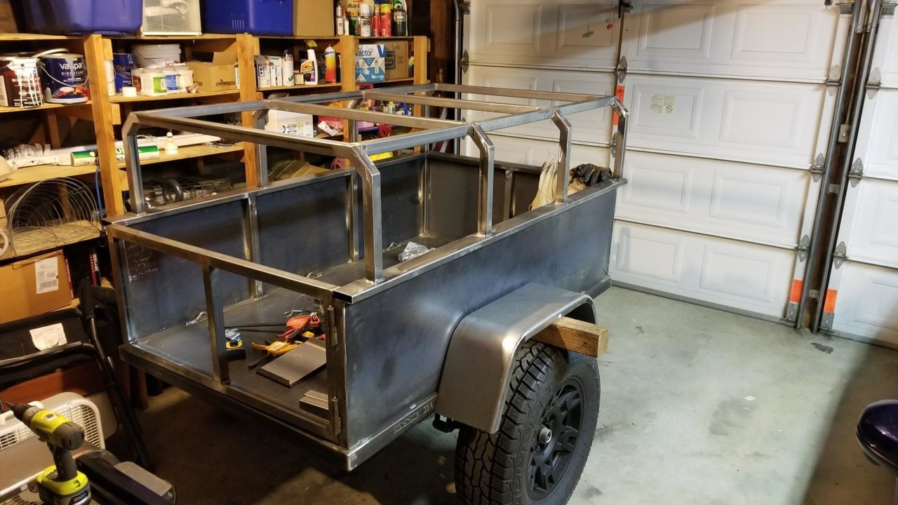

    Started adding on the supports. The sides on this will be around 20"

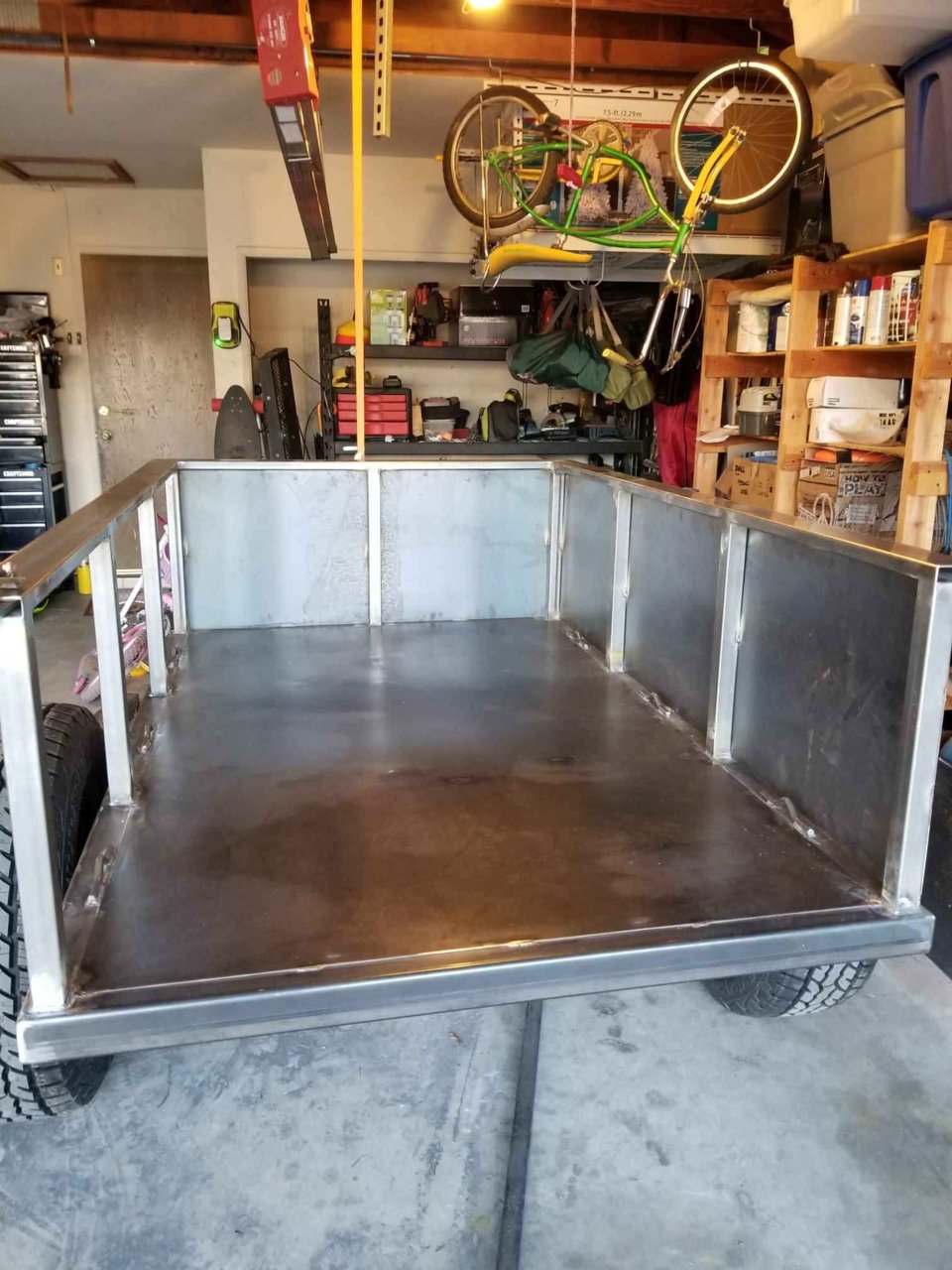

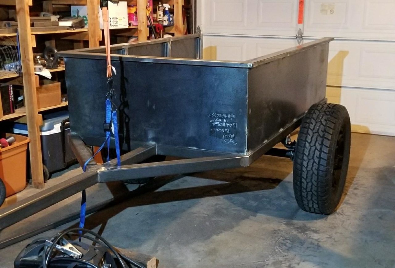

    Next part was to add the skins to close it up. At this moment I'm still planning to keep this trailer open. I added tie down points at the bottom.

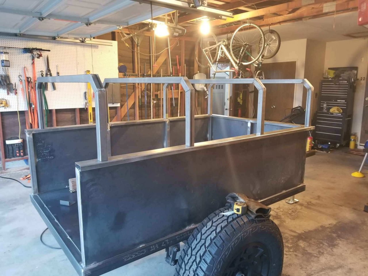

    The next stage of the build is to start on the rack that will hold my Tepui Kukenam Ruggidized.

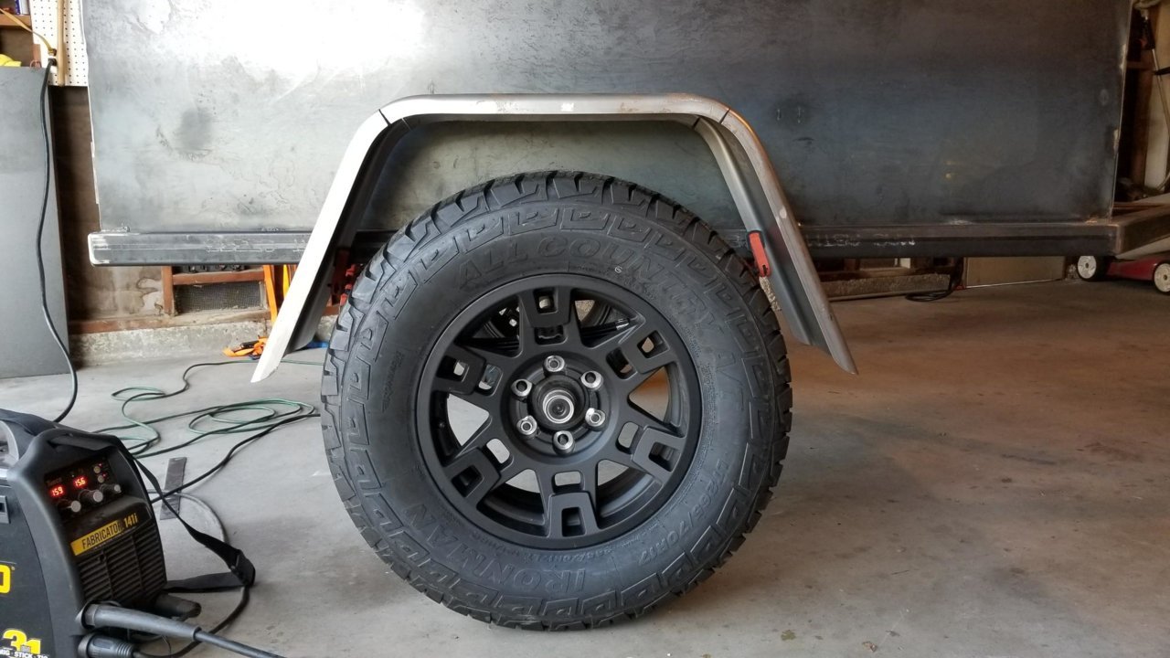

    Height of my rack should be the same height as my existing setup on my truck. It's time to fit the fenders on. This is the tricky part, since most larger tires won't fit normal trailer fenders. Here we just cut the fenders and spread them to fit.Resized952018022195163850958477.jpg

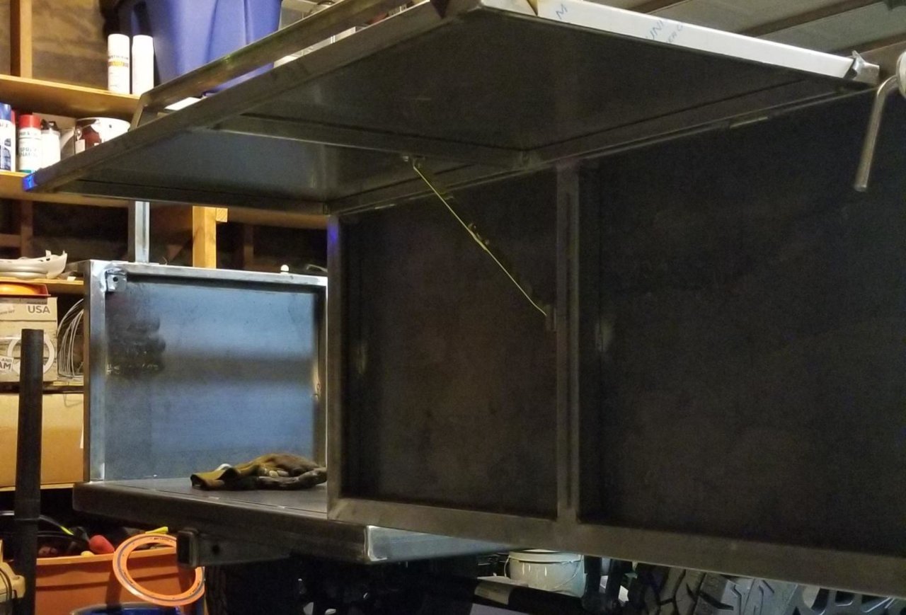

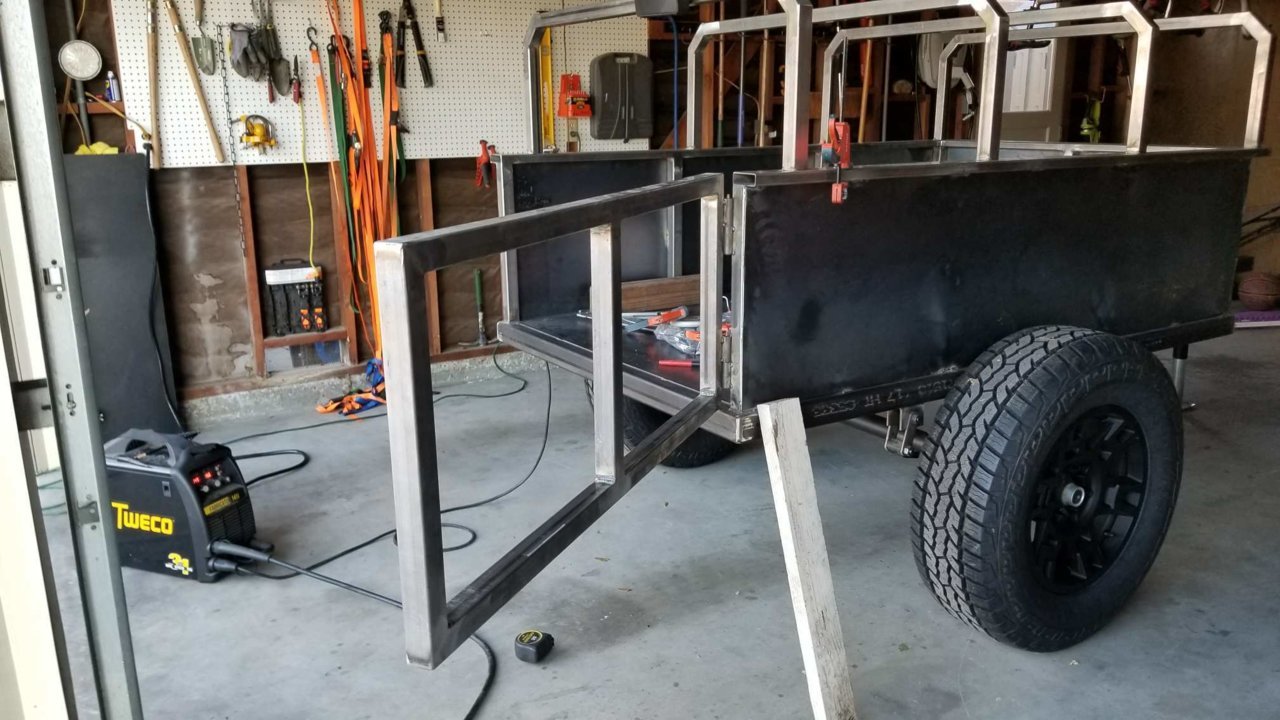

    The next part of the build is to start the removable swing out gate. The swing out gate will also hold a drop down stainless table.Resized952018021295163149955625.jpg

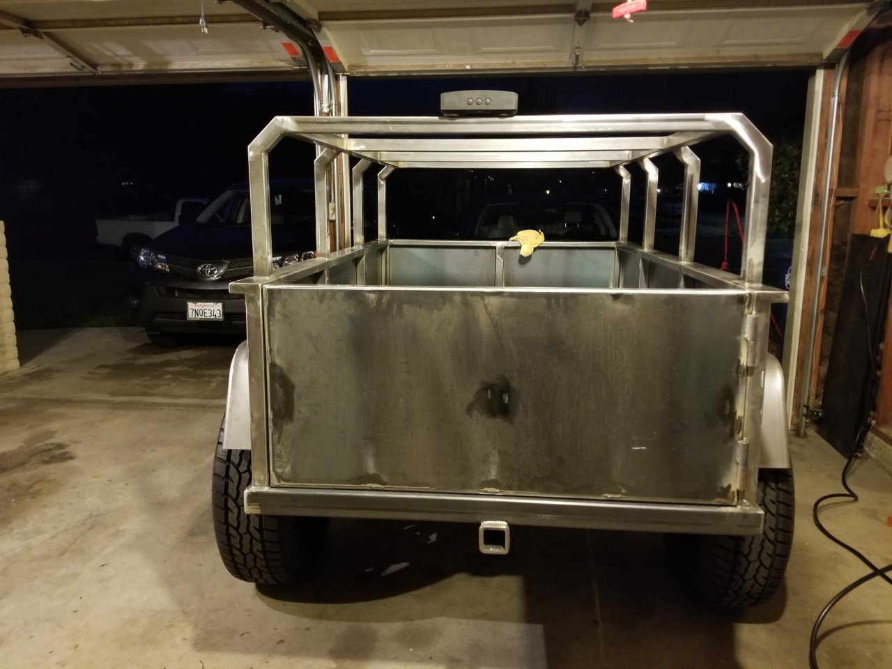

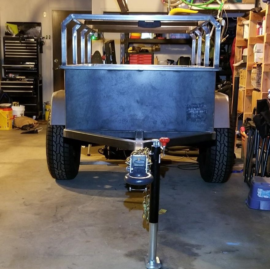

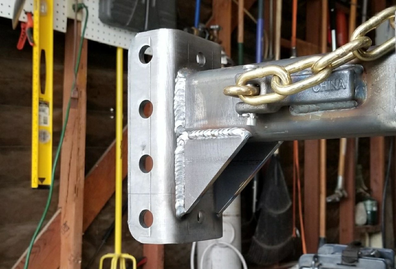

    The rack is all welded up.Resized952018030695201056955922.jpgThis may be a little overkill, but I know I won't have an issue with it cracking. I'm going to be running a pintle. Resized952018030995163332954073.jpg
    I did add a rear receiver to hold a bike rack if I want to.Resized952018032295194958956909.jpgI took this trailer out for a test spin. Everything seemed to track well. The pintle is a little more noisy, but nothing to bad. Once the tent is mounted the extra weight will smooth out more.

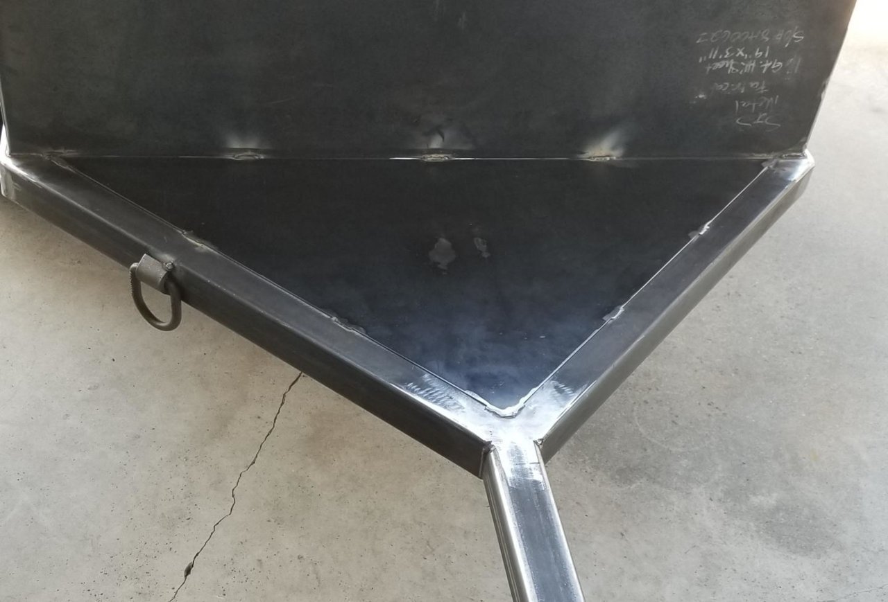

    Closed off the tongue, and added d-rings to the sides.

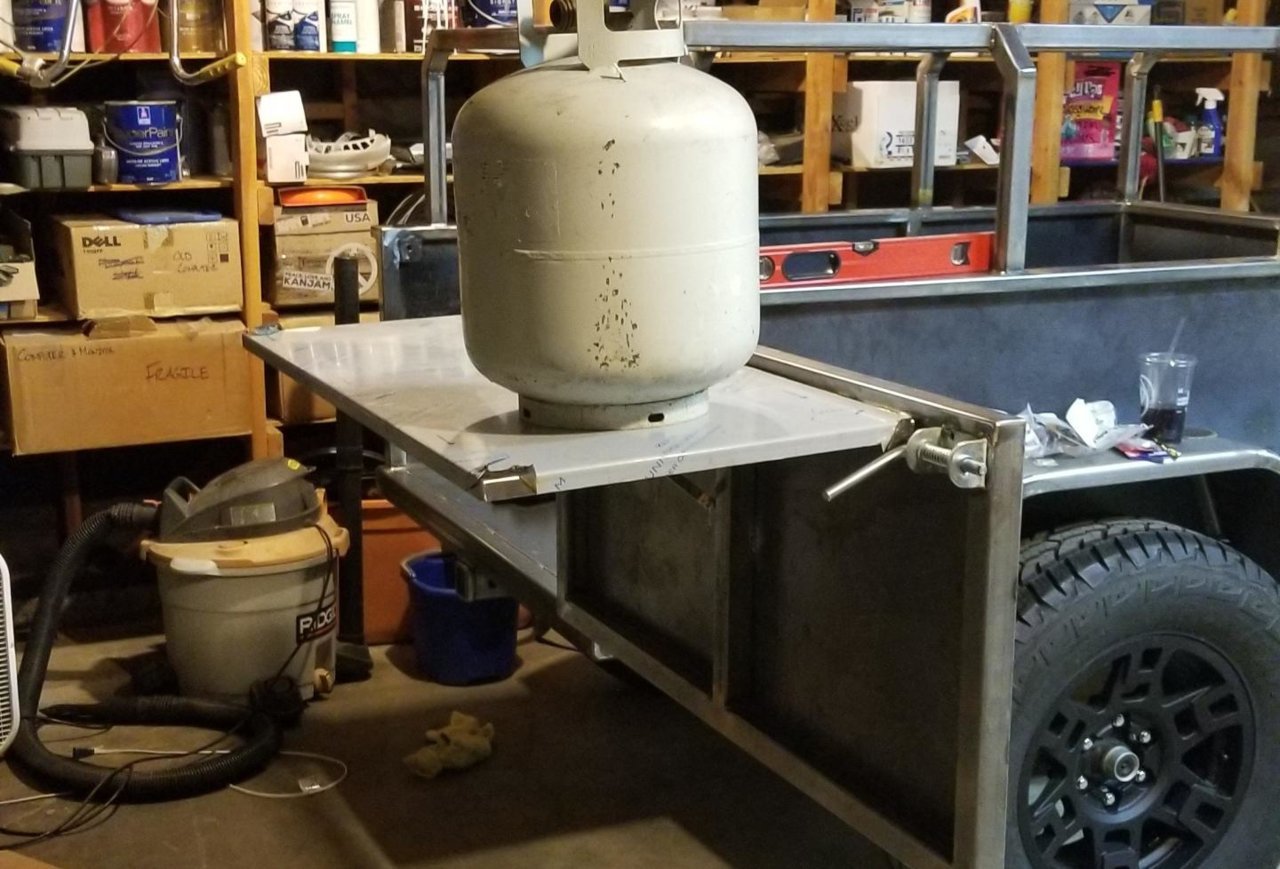

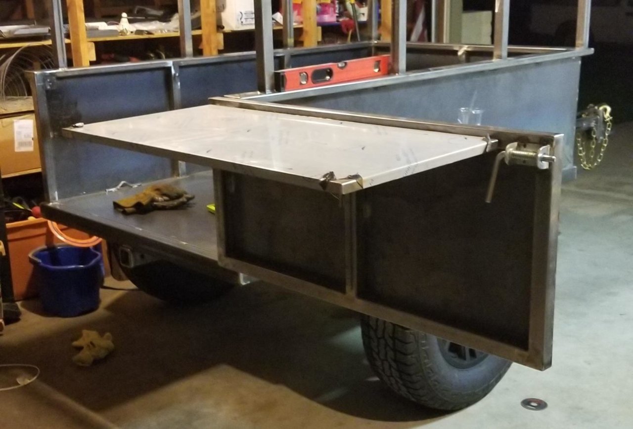

    Finished with the rear swing out door with pop up table.Resized952018033095213114955393.jpg Resized952018033095213121952835.jpgSturdy enough to hold a full propane tank.Resized952018033095213637958820.jpg

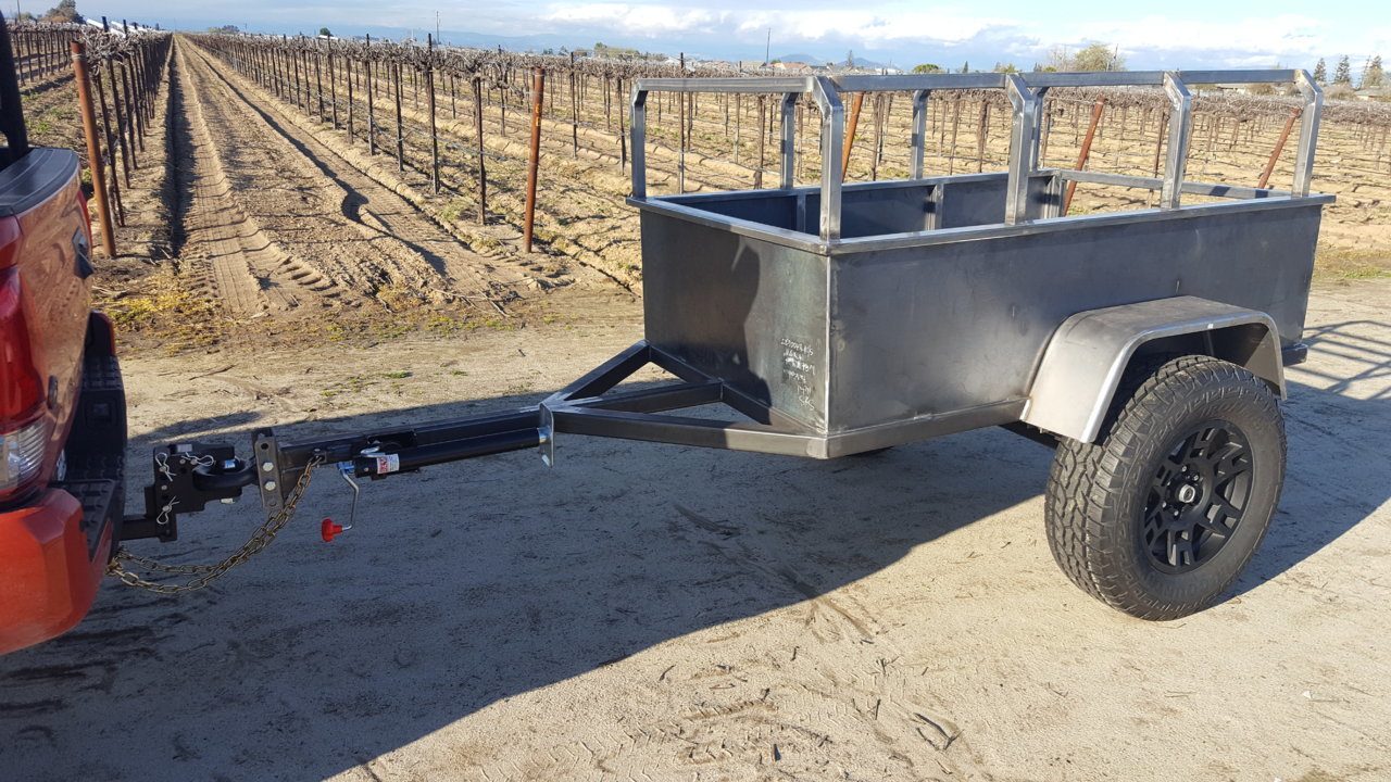

    My trailer should be done being powder coated this week. More pictures to come.

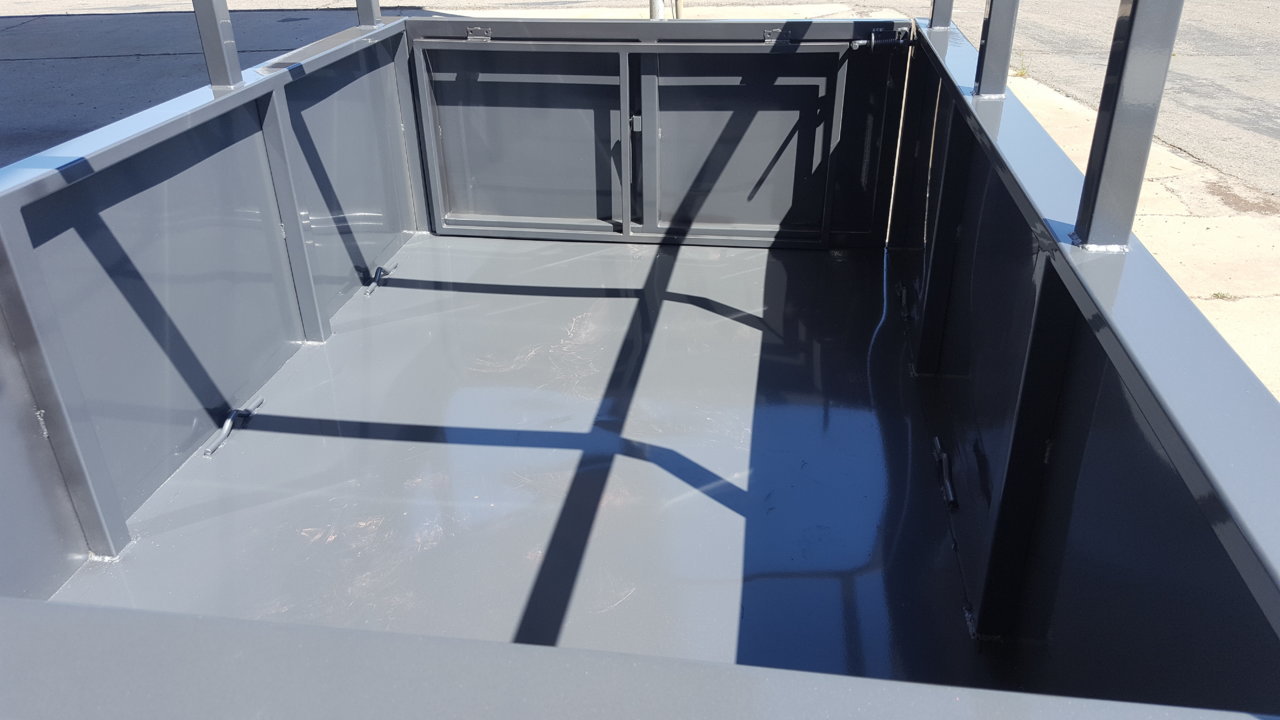

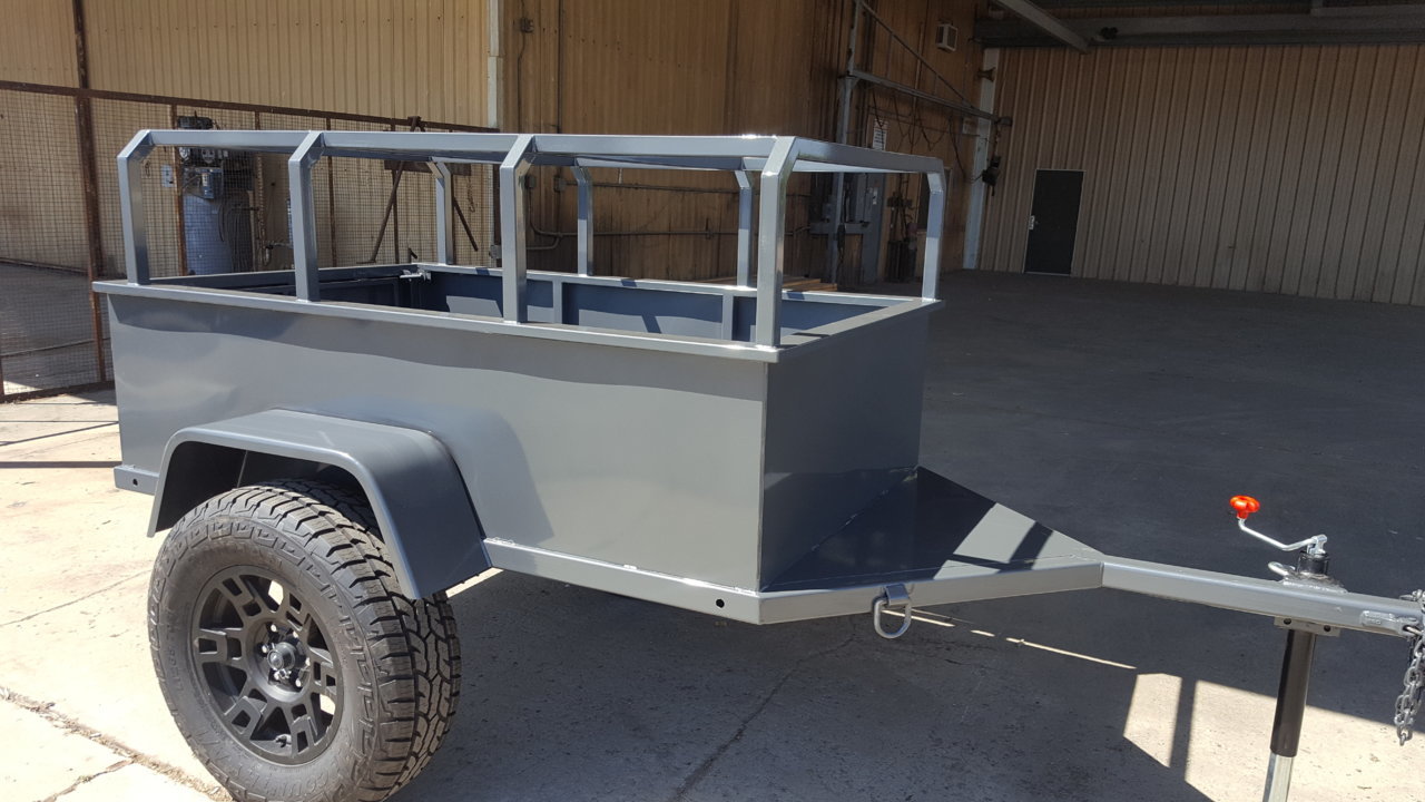

    208
    2017 inferno Tacoma TRD

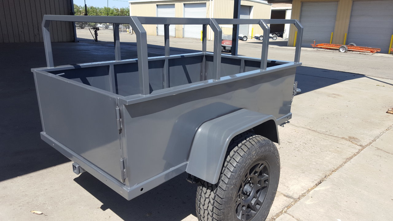

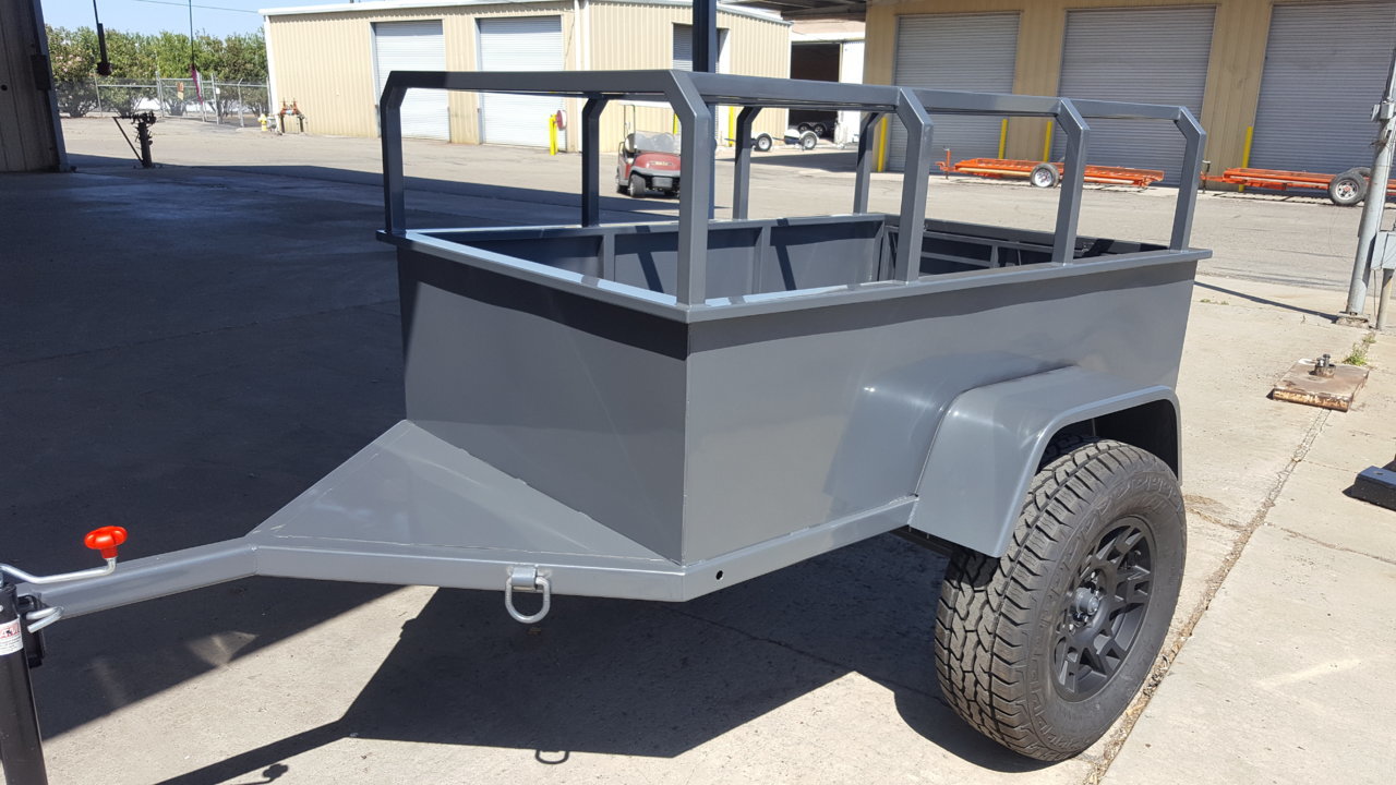

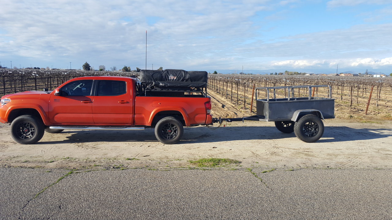

    I got my trailer back from the powder coated. I like it. Next step is to wire it up. Then off to the testing ground.20180420_144000.jpg 20180420_144010.jpg 20180420_144057.jpg 20180420_144104.jpg
