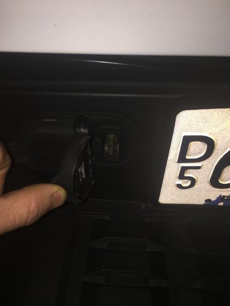

    In the good state of Oregon it rains alot. But have only towed a couple times since the rainy season. Anyone shove di-electric grease on the contacts? I know its good for keeping moisture but seems like itd be a magnet for dirt. IMG_0091.jpg

    I have, still looks good and clean.

    same here, remember a little goes a long way. I put it on with a q-tip if I remember correctly. I have also used fluid film int he past on other vehicles as it apparently won't hurt electronics.

    Dielectric grease is what I have used for years. A little dirt is far better than green corrosion. If you ever use metal valve stem caps use it on there too.

    It works very well, I use it for a lot of things in marine environments as well. Works great as an o-ring lube, helps to stop dissimilar metal corrosion, great for rebuilding rebreathers, helps somewhat maintain water resistance/proofness on some electrical connections. You can also pack it in shrink wrap around connections to help seal the connection up from water intrusion. I coat my dive knife with it as well to prevent rust from forming with salt water. I'm sure there are lots of other uses as well, its relatively cheap for a large tube if you buy it from Acklands Grainger/etc as well.
    If you get a small tube like the sell at some of the auto stores, just puncture the seal on the end of the tube (underneath the cap) and it should fit right over the 4 pin connector, give it a squeeze and voila. the 7 pin just put it on with toothpick or q-tip/
