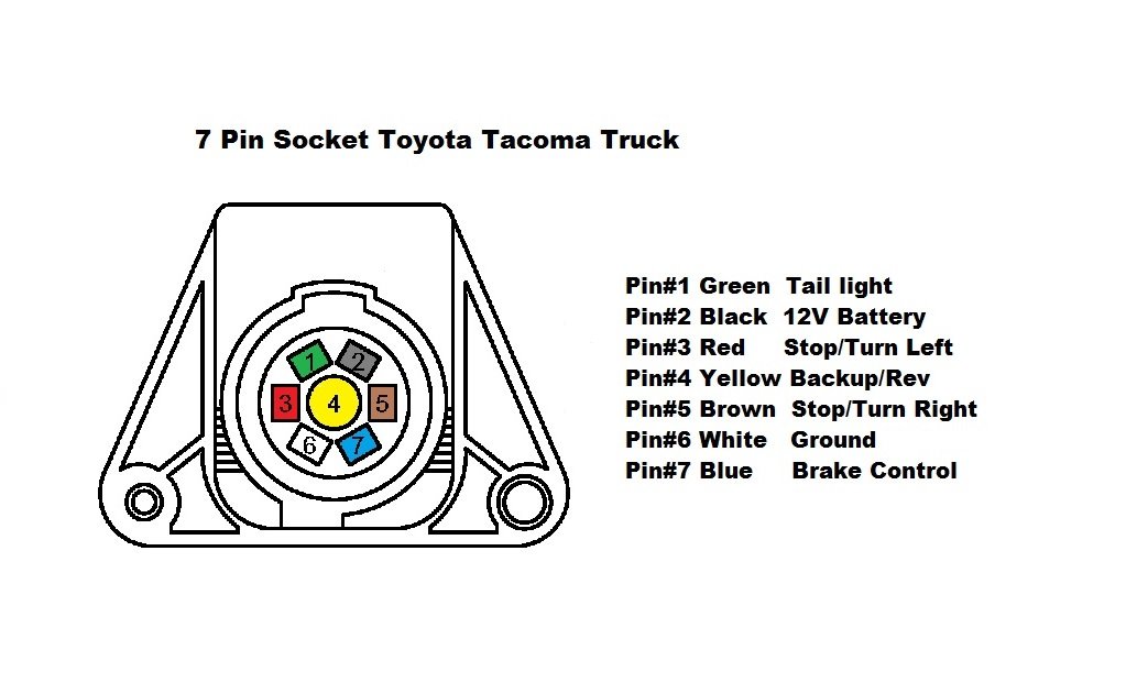

    This is the scheme that came on my truck - its a 2014 with tow package........
    Just sitting there with the engine running, it should have 12v power to pin #2 and the pin #6 should show continuity to the truck frame. Turning on the lights should add power to the #1 pin.
    When I picked up the truck - this silly socket was hanging out (exposed completely) on the bottom of the bumper. After seeing several dozen of them smashed and knocked off - I put a hole in the bumper and moved it up alongside the license plate. If yours has been dragged off at some point - suspect the repair job....

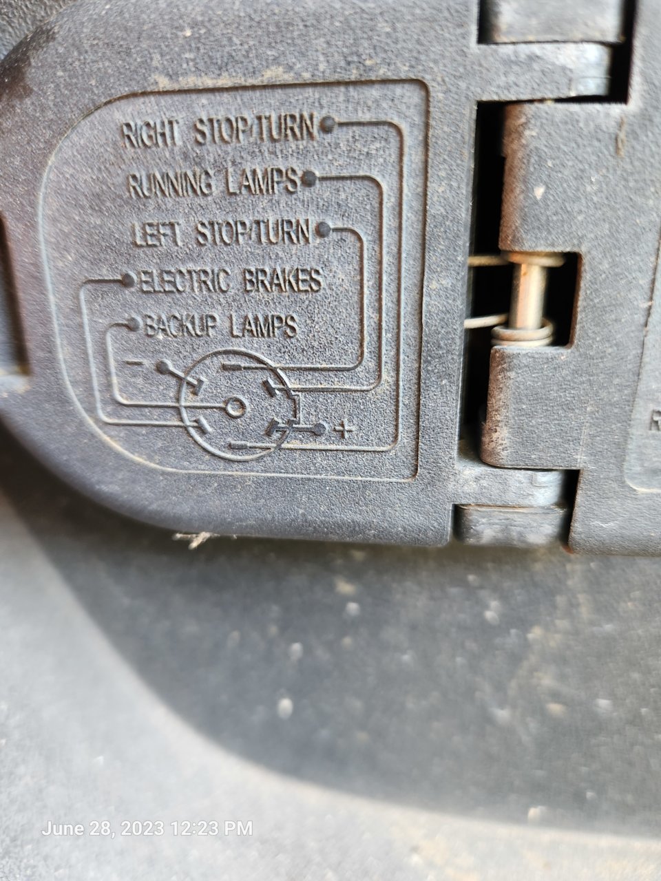

    Thank you for the diagram. Here is what I have. Picture of the connector. I have power to + and running lights. Nothing on the rest when circuit is activated. I will be double checking fuses.
