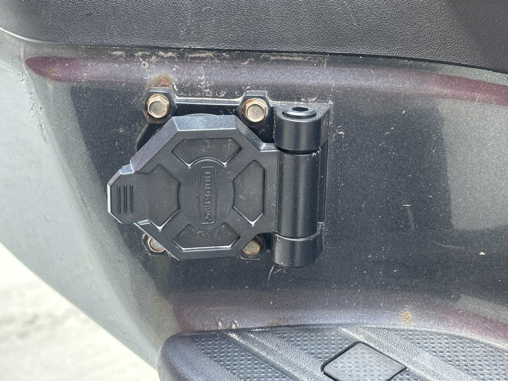

    I moved mine by the 5 hole method.
    And of course the first use needed a "4" type plug-in. So I bought a convenient adapter that plugs into the RV-7 pole when I need it. I've been considering a switched jumper from the tail lights or 12v power lead to the back-up circuit. Just installing the waterproof switch at the rear of the bed and then using it when trailering to temporarily light the area - without leaving the truck in reverse with E-brake engaged.
