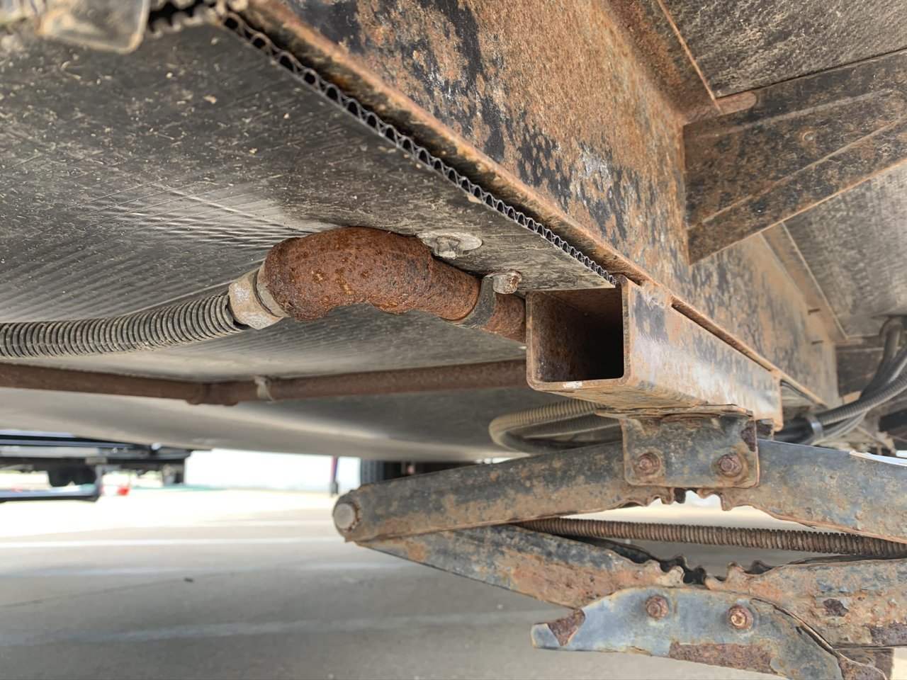

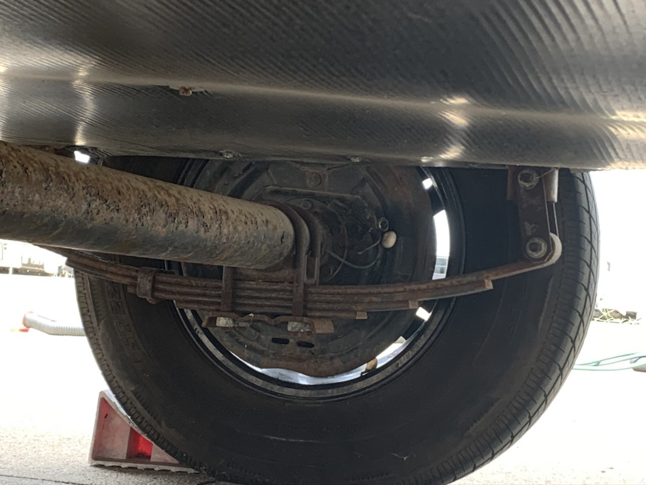

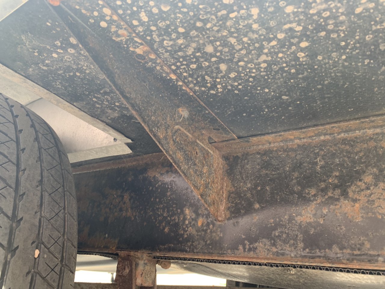

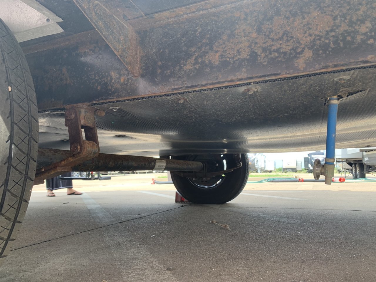

    We're looking at a travel trailer. overall it's in great shape but there is a bit of rust on the trailer, axle, leaf springs. I know rust is a big topic in TW so was hoping I could share a few pics and ask for your thoughts on the rust.
    I think the actual trailer frame looks OK. I could scrape and apply fluid film or other. I've replaced the leaf on my taco and assume I could do the same here if necessary along with some of the other basics. The trailer will sit in the side of our yard 90% of the time with a few occasional trips (making a bit more room).

    Honestly that looks mostly like heavy surface rust & would not concern me that much. That could easily be cleaned up with sand blasting & re-coated. Good looking caravan btw.

    Thanks for the reply. I agree I think I can clean up the surface rust and that will give me a better sense. I also think the parts that look the worst are replaceable fairly easy so I think I'm moving forward. I have a place that's going to be doing a full inspection on it so we'll see. THANKS AGAIN!

    Need to remove a few of the fasteners holding the corrugated plastic splash guards near the leaf shackle hanger and take a look inside.
    No shock absorbers on the axle? How does it avoid bouncing all over the place on the highway?

    You wouldn’t need do do nothing but keep it under coated with fluid film. Once you sprayed it, it would stop it from rusting and protect if from further rusting.

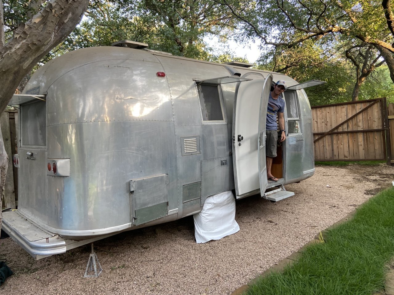

    Thanks for the notes. I wanted to close the loop on this thread. The deal for that first trailer fell through. She backed out last minute. Which is fine. Then this beauty fell in my lap and it’s now sitting in the backyard. 1965 AS globetrotter that’s pretty bare at the moment. I’m the 3rd owner and I’d say it’s in good shape and basically ready for me to do take in any direction I want. I’m looking forward to another learning experience with this rig, and I’m definitely ready to get out of town for a bit ...
