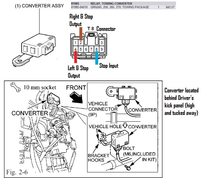

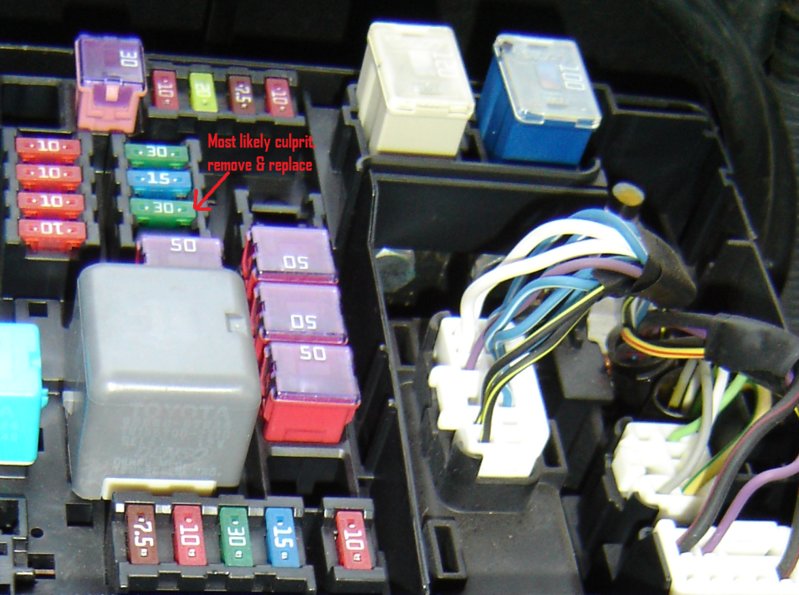

    Sounds to me like your towing converter relay is bad or possibly the 30 amp towing fuse

    Weren't some trucks missing a relay even when equipped with the tow package? I seem to rememebrr reading this.

    Thanks PSU, Ill use that to chase it all down. I think all of the fuses were good, but I didnt check the relay. Do you know if its possible for the tail lights to work, but not brake or turn signals with a bad relay?

    Yes that would do it. The tail lights are on a seperate circuit. The relay controls the brake and turn signals.

    Im not sure an easy way to test relays. Kinda throwing spaghetti at a wall at this point. Gonna try to replace the towing tail relay. I picked up a relay from local auto parts store, was the same as every other relay in the fuse box, not the one that I actually needed.

  13. May 14, 2016 at 6:57 AM
    Normantaco
    Normantaco [OP] Well-Known Member
    Oct 1, 2012
    #88100
    546
    Pensacola, Fl
    16 4Runner SR5
    Thanks caribe, Ill check those out.
