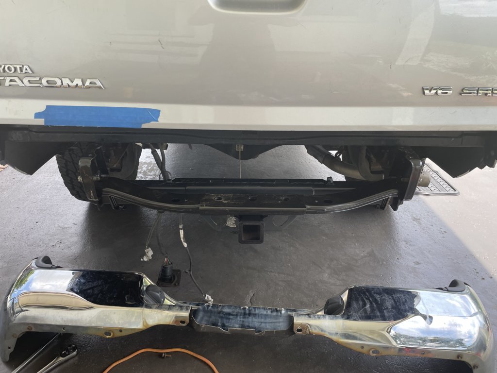

    Hopefully someone can help me on this old thread so I have 11 dbcb trd sprt and had my frame replaced 3 yrs ago. I've been restoring it as much as I can to like new condition bc it's cheaper than buying new and my e trailer I got seemed correct but my bumper brackets are welded to the frame and can't be removed to install the new hitch. Anyone else encounter this problem? Any help would be super helpful thanks in advance

    Could you post some pictures so we can see what you have. I have ‘08 and my bumper attaches to rear bumper reinforcement beam that’s a separate piece that is held by the the receiver hitch. I’m also assuming the ‘08 and ‘11 are the same.
    Here’s a picture of what I have:

    The entire rear factory bumper and hitch assembly come off as a single piece. If memory serves correctly it’s three bolts per side going into the frame.
    Edit: looks like five from this video. Super easy to tell if what you have is factory or not.

    Thank you all for the help, so I figured it out basically my new frame has the bumper brackets welded on to the frame so anything other than an identical match can't be used lucky I found some on ebay. Basically I needed no brackets on the hitch I'll post a Pic to show the difference just in case anyone else has my same experience thank you again!!!!
