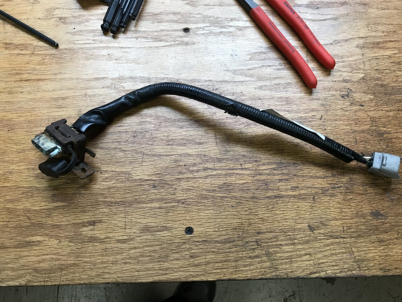

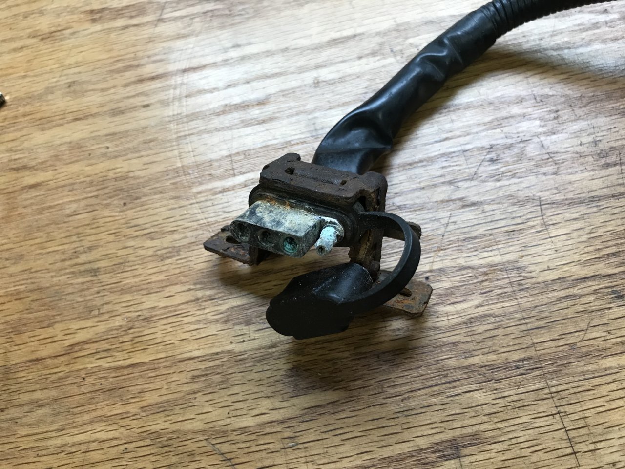

    I was planning on bolting my trailer hitch plug to the hitch today (instead of zip tied behind the bumper) and noticed the bracket was rusted and crumbling and the plug itself is all corroded. I’ve never used it before but am going to rent a log splitter from Home Depot soon so I need something that’s not going to turn to dust. I was looking for a part number from Toyota but only see the 7 pin connectors and nothing with this factory metal bracket.
    So either I’d like the whole harness to replace what’s in this picture or just a new plug and steel bracket and then I’ll splice it together. These wires and gray connector are in fine shape so that might be cheaper.
    Can anyone help? Thanks!

    Thanks a lot Sparky for the digging, unfortunately I don’t think the sub harness part number is correct. It all seems to point to the full assembly for around $100. I used your part numbers to leap frog to this Lexus part number: 08942-48870-BB. It has one end that’s wrong but the end that matters is right. Still don’t feel like spending $40 for this considering I’d have to cut it apart but looks like this is all there is. I was hoping to find a used one in decent shape for cheap. I might just end up buying generic aftermarket parts to splice in even though I hate that. Aftermarket electrical components are usually pretty bad. Thanks again! We got somewhere!

    I'm cheap. I'd use a copper cleaner and maybe a wire brush on the connector, use a wire brush on the metal bracket, paint the bracket, and use dielectric grease on the connector.
    I don't think that harness looks too far gone.

    Use a baking soda paste... Slather it on, rinse, repeat until it doesn't boil as it were any more.
    A toothbrush works well scrubbing and will get into the female sockets of the plugs.

    I’m cheap too so I have actually been in the shop cleaning it up, haha. Yeah I suppose it could be saved but I can’t remove the bracket for painting without breaking it. Also I took off the corrugated split loom and there’s already a few splices and one wire has the insulation worn away in a couple places. Looks like this has seen some abuse already. Maybe I’ll continue maybe I’ll get another one.

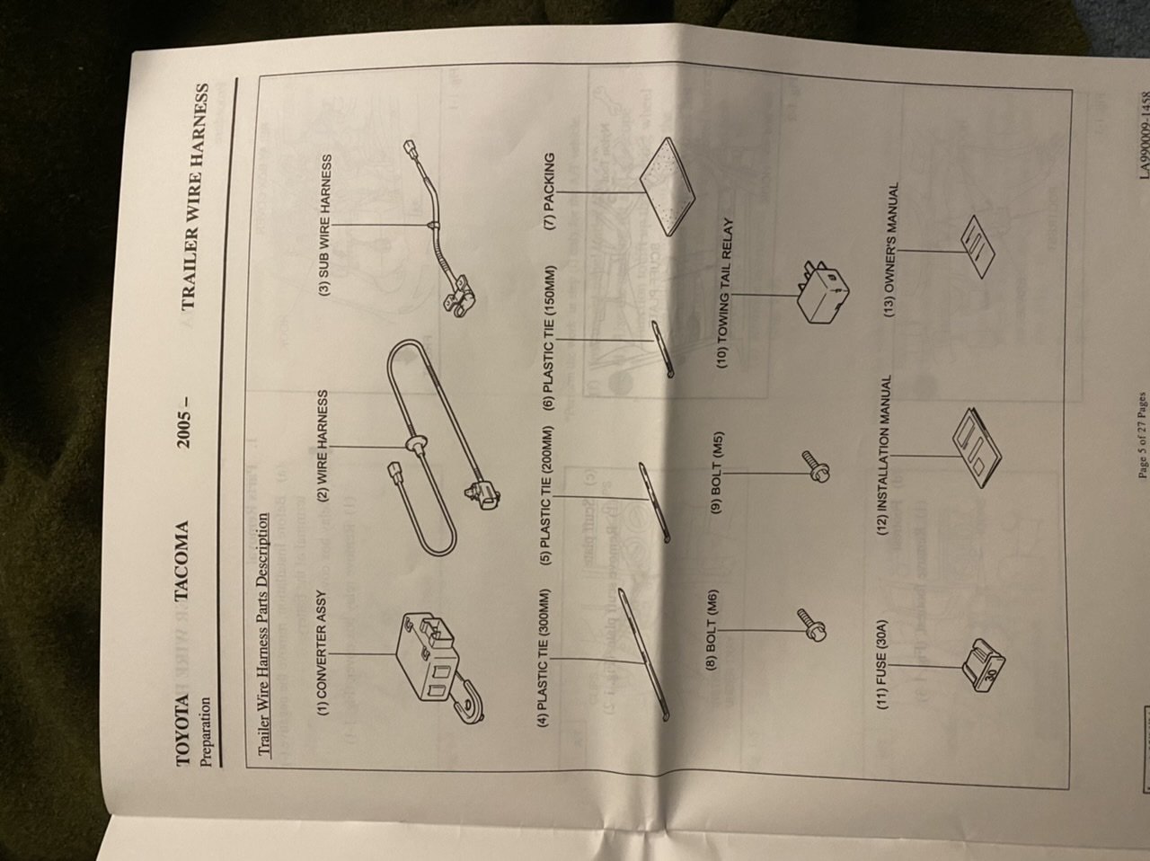

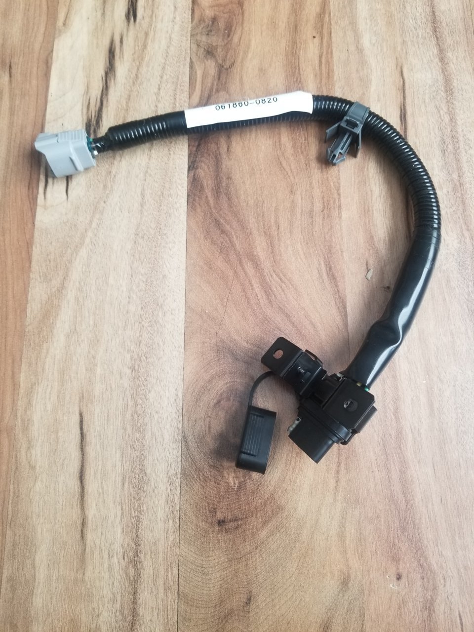

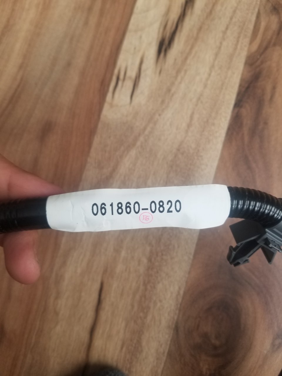

    I have that exact same part that I bought by accident trying to get the 7pin on the cheap, that is one nice looking bracket btw. That number is 061850-0820. The full wiring harness kit is PT725-35120.

    It was a typo sorry I'm on mobile . 061860-0820 is correct.
