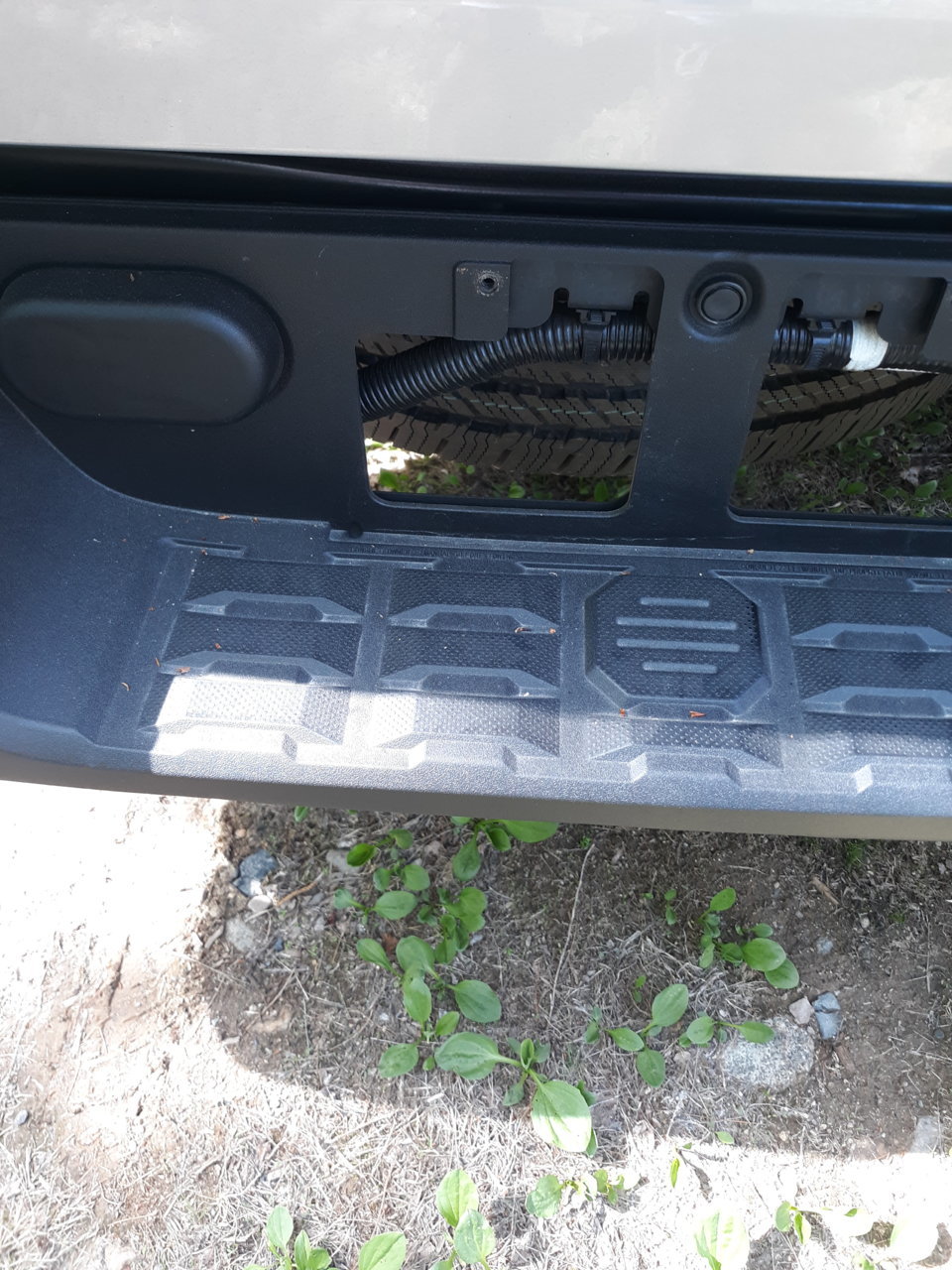

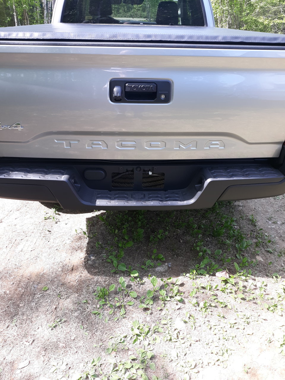

    2020 Tacoma hitch. Is frame the same size as the 2018 ? Didnt see any listed for 2020. Bolt on frame. No drilling. Found some online at good price. Any info would be helpful. Thx

    99.9% sure Toyota did not change the frame mid-gen.

    Everything I'm seeing has the receiver hitches listed as 2016-2020. Order away.

    What supports the bumper if you don't have a factory hitch? That was the only rigid part in the whole bumper when I changed mine out. The only other parts were plastic brackets and the covers.

    Thanks for info. Perfect..... No factory hitch. I see 2 bolt holes on each frame R&L. I also see wire plug for wiring. So I still will need that also. I would think they sell those online too. I bought a plain jane Tacoma. Like it so far . Thanks again. Will post pictures if I can figure it out

    I believe that the frame is the same for 2016 and up in regards to the hitch. The oem hitch is attached differently than the curt one.

    I see there is 2 different ones available. The bolt goes straight up. Not the side ones... Thanks. Figured I'd check before I ordered. I also messaged ebay seller with no responce yet.
