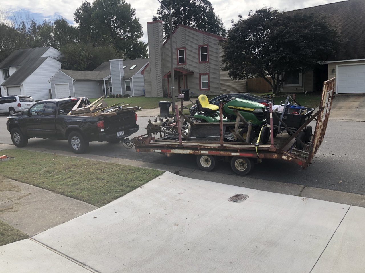

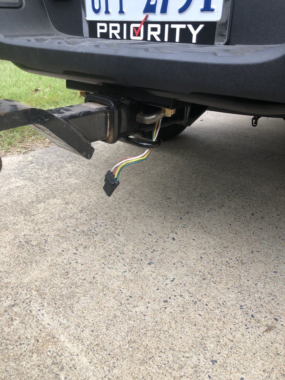

    added rear seats access cab LEER 100R Curt hitch receiver Curt trailer lights Carthart seat covers 255/85/16 Toyo MT for trails 265/70/16 W/ OR wheels for DD TRD PRO skid OR fuel tank skid Warn tubeless winch bumper Smittybilt XRC 9.5k winch HS 1/4 inch coil spacers RCI rock sliders Wheelers 1.5 AAL Bilstein 5100 rear Decked
    I installed the lights and hitch in about 1.5 hr on my truck and the cost was about $275. I installed it the day after I bought it. If u can turn a wrench u can install the hitch. If you can run a wire from the very back of the truck to the front you can install the lights. I pulled 3000 pounds with 900 pounds of that in the bed . The most id pull going any real distance would be 2000-2500.
