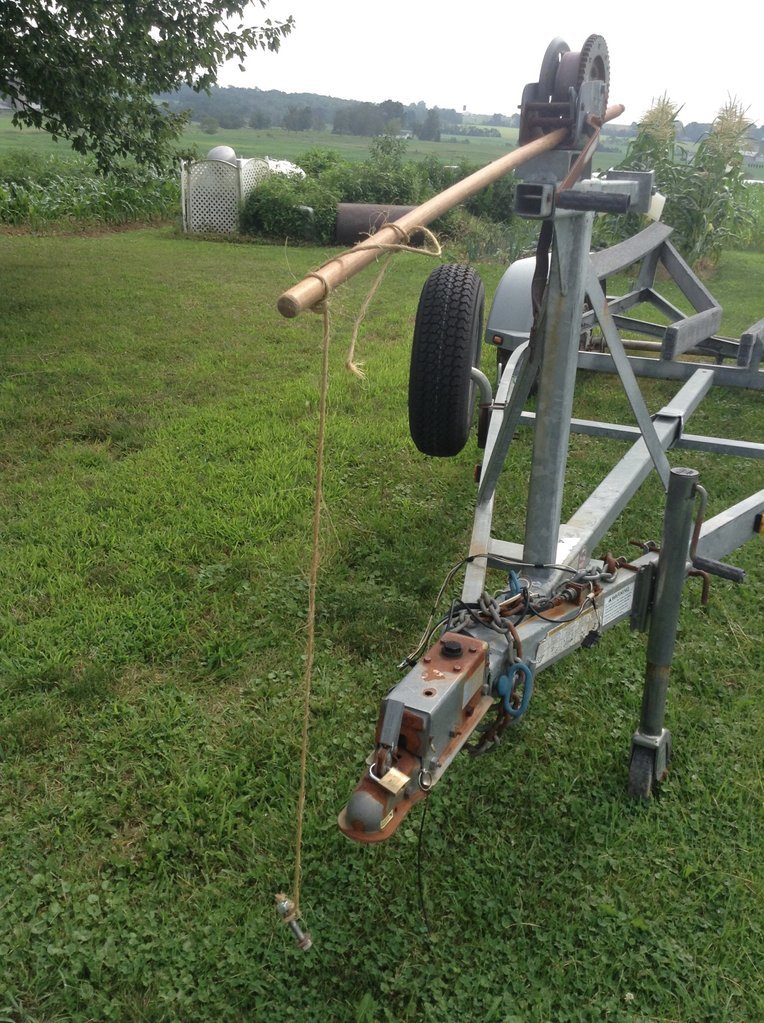

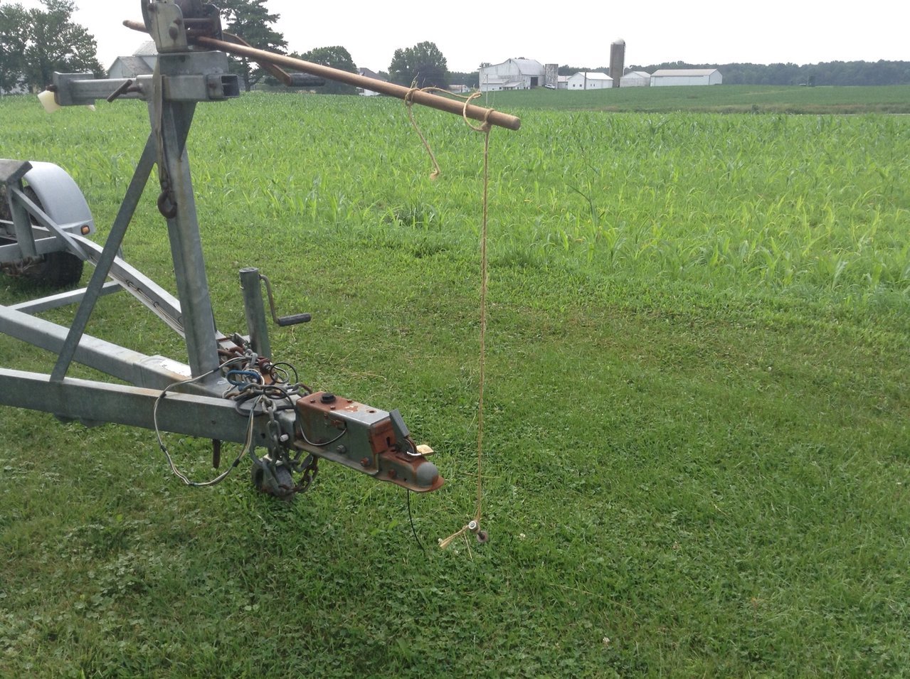

    Something cheap and easy I use to line up the hitch and ball. Old broom stick, string/ rope/ strap, something for weight.( I used a bolt and nut that I found unemployed in the garage) Put the string about a foot in front of the receiver,so you don't back up to far,and can check alignment. Soon as you see the string move , get out and check, notice how much more you need to align , then back up that much, stop and apply the parking brake so you don't limage.jpg image.jpg ose your position, and then put in park.
