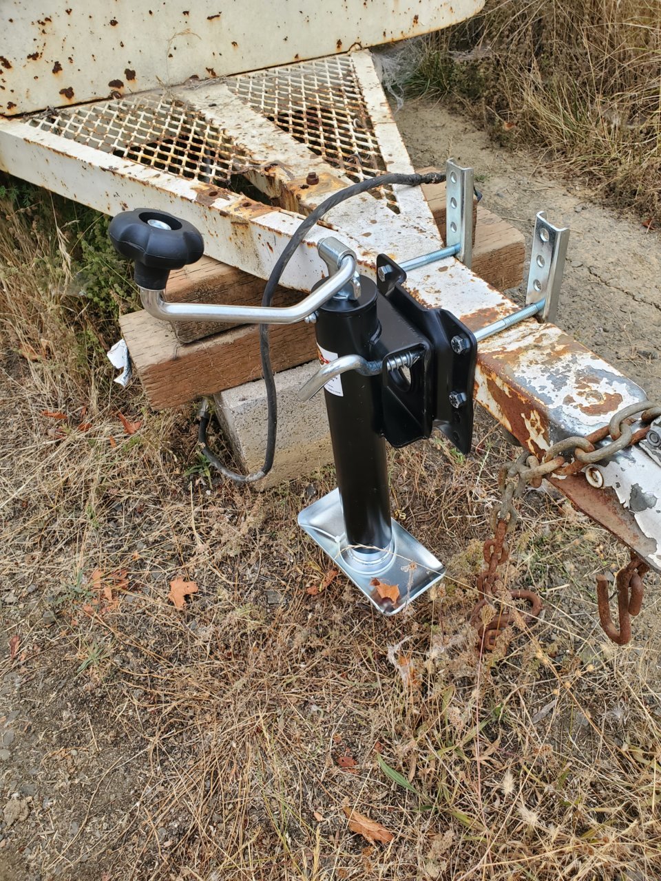

    Whats a good way of mounting a jack on this trailer in a safe and reliable way?

    Side mount swivel jack on one of the A-arms.

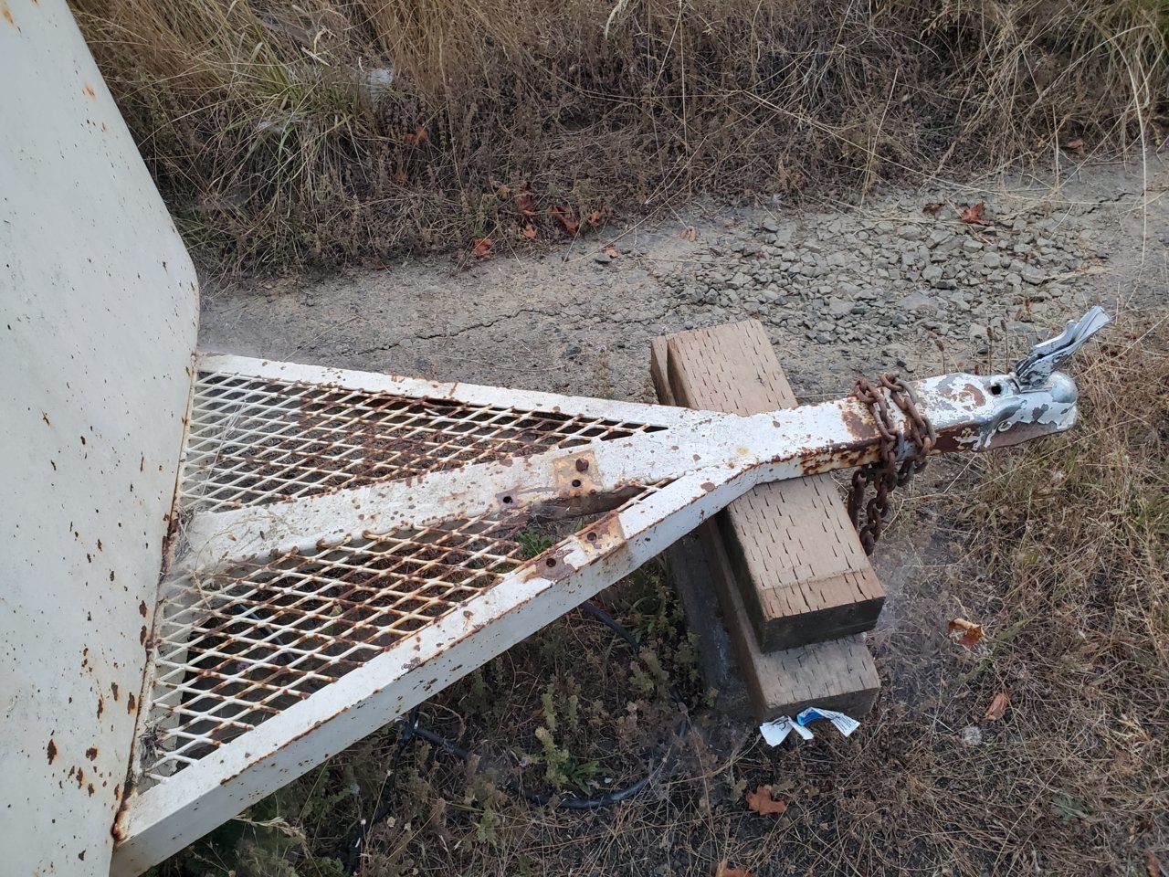

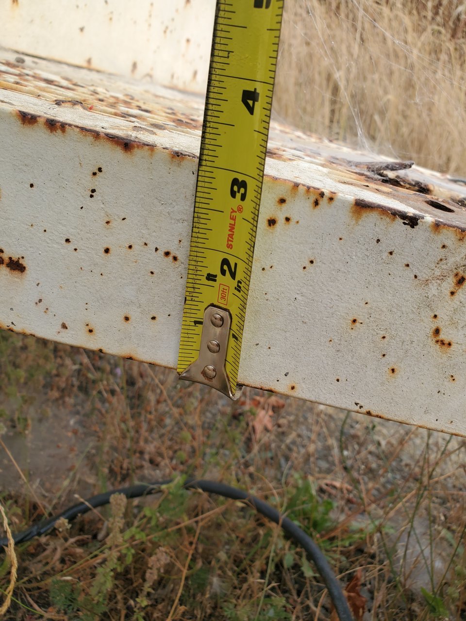

    Awe I see now. The arm is 3in and C channel

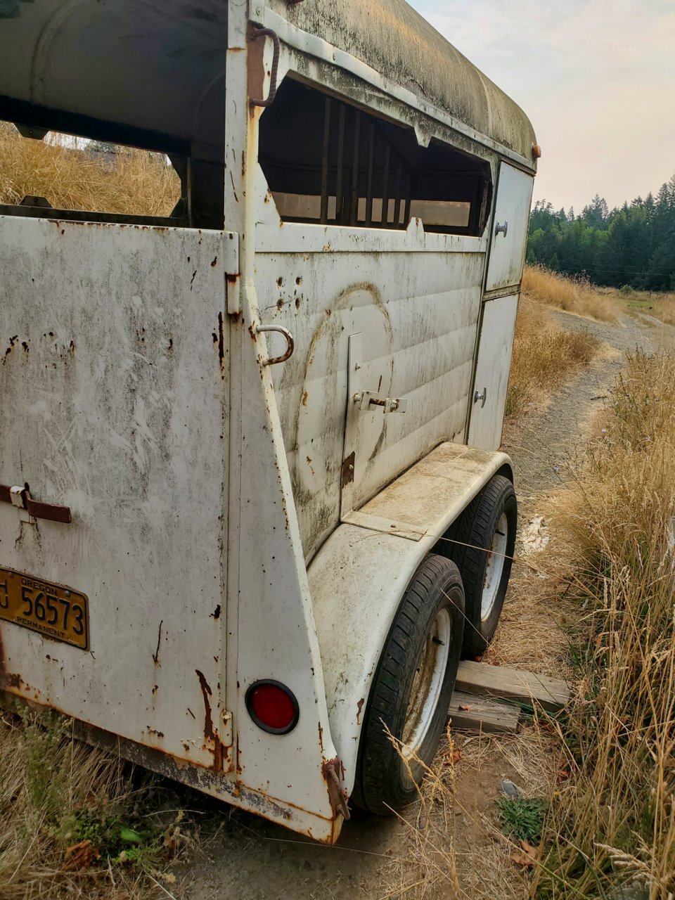

    And this is the trailer

    Maybe Ill try one on the mid section, the arms are only C channel.

    That's bigger than I thought. What's the tongue weight? Less than 1000 pounds, use the swivel jack.
    More than 1000 pounds, you'll need a drop-leg jack.

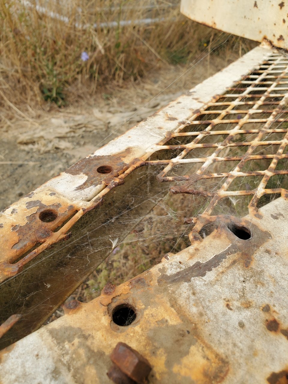

    It had a drop leg jack in it prior but it was Jerry rigged in there with a couple of steel plates between the center section and the right A arm. I bought another drop leg jack but im trying to find a better way of installing it.

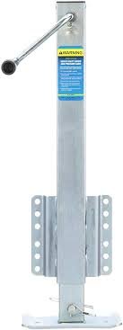

    Does it have a mounting plate? I'm thinking this, fastened with a pair of u bolts around the center member.

    Theres no mounting plate, im not really sure how a jack was originally installed. Ill have to keep my eyes out for a jack like that.

    One thing I worry about with the Ubolts is the leverage created by the jack.

    Should be stable to the jacks rated lift.

    Dude Thankyou. This is the final piece to getting this trailer going so I can use it without serious injury.

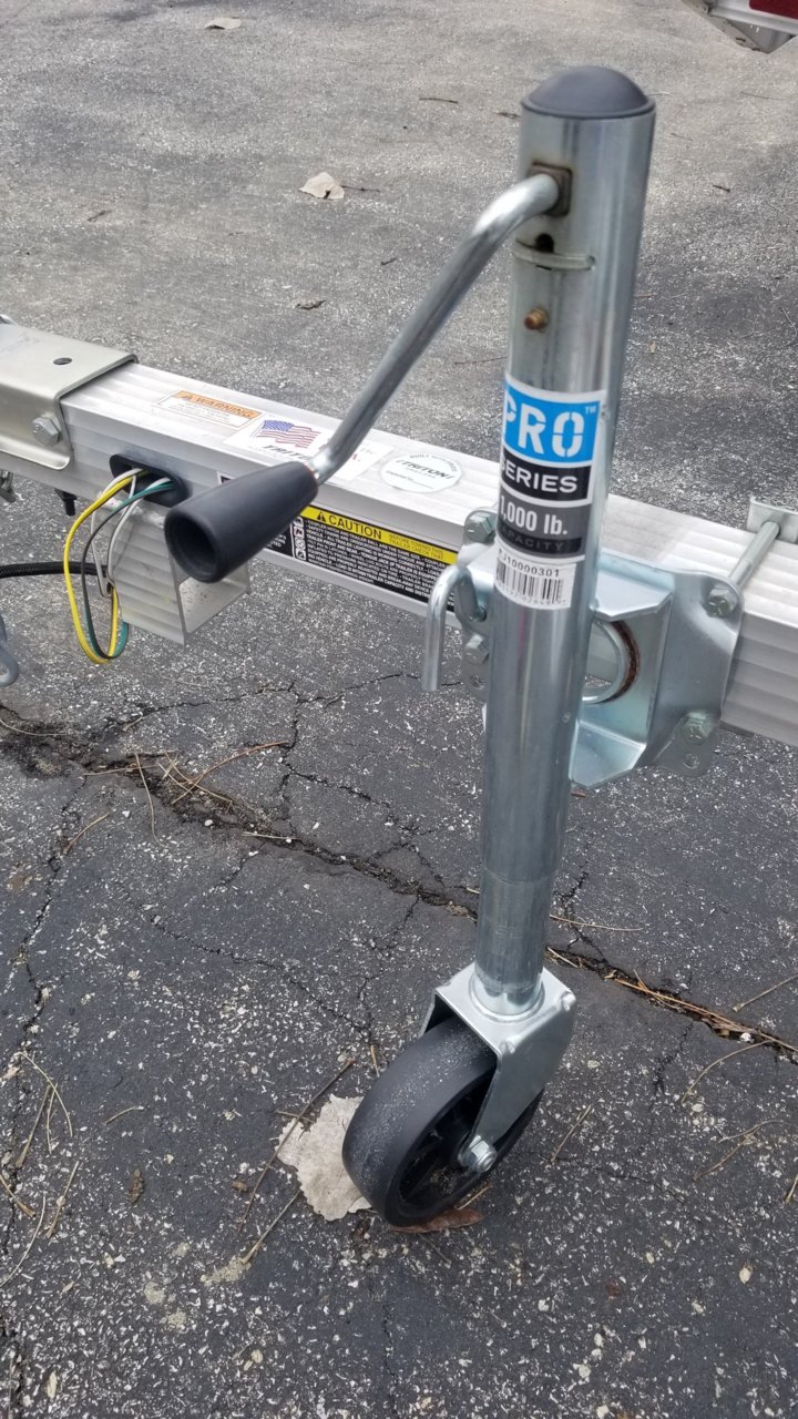

    I have a 2000lb version on my camper I installed after I broke the old one of. Works perfect. Easy install.

    Made this work, thanks guys.
