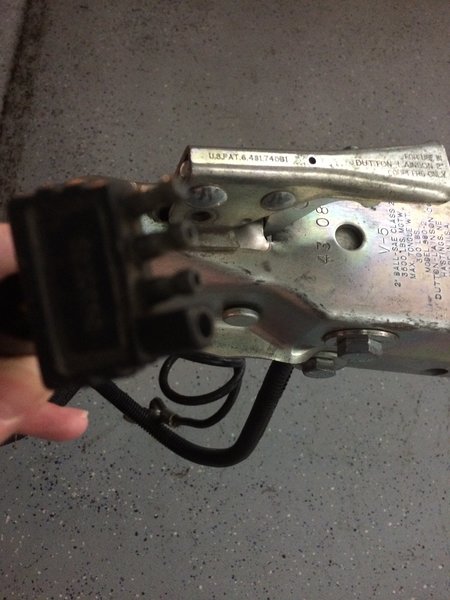

    2016 Tacoma DCSB 4x Sport MGM
    This is the plug that plugs into the receptacle on the truck.
    forty2 likes this.
