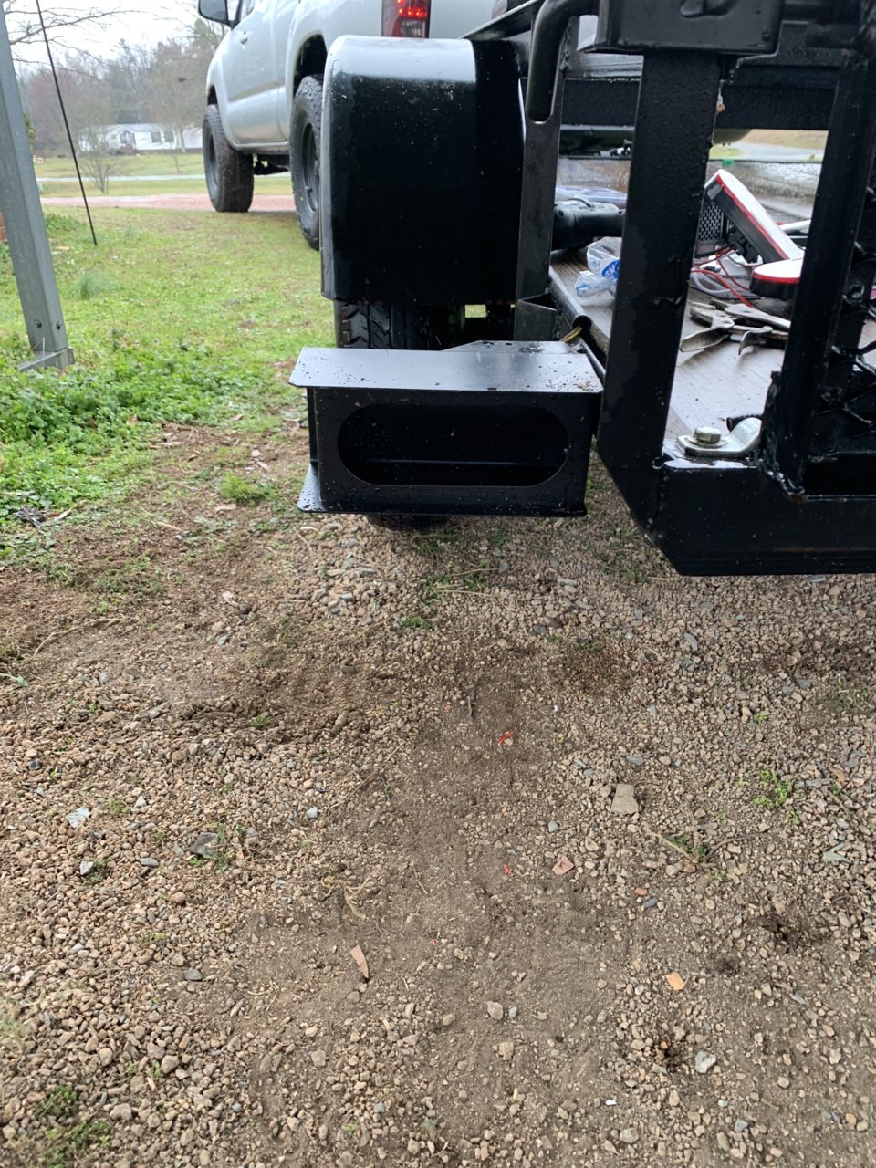

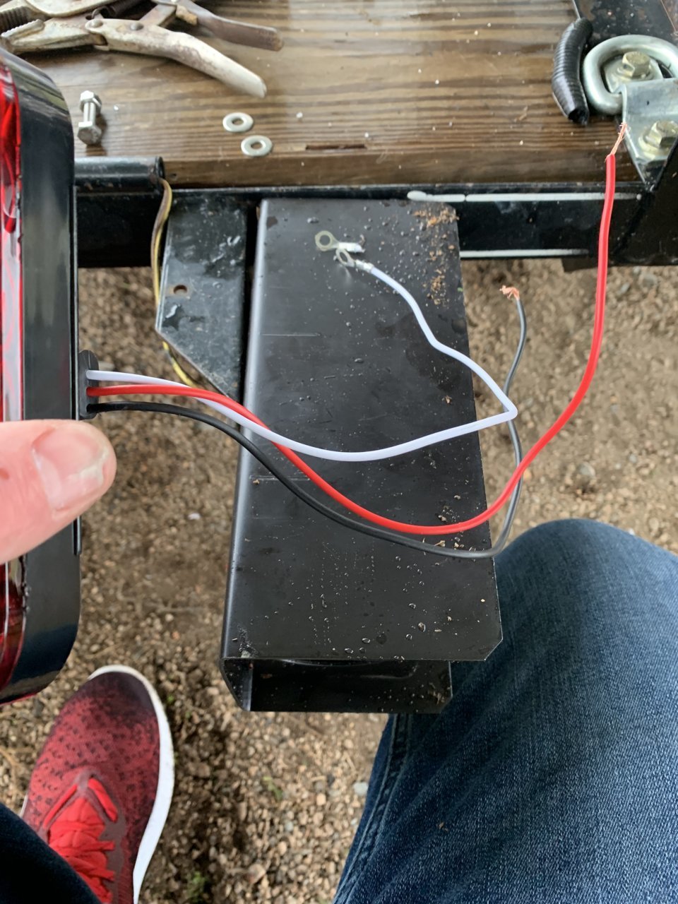

    Replacing the cheap plastic lights on my tractor supply trailer with some nice metal box and flush mount trailer lights. Can’t seem to get them to work. Suggestions on which wire goes where?

    I’m guessing White is ground and you need to screw it to the body because of the eyelet on it.
    red is likely Break and Black running.
    Those colors aren’t used for standard trailer wiring. Brown is usually running light and yellow/green are turn...but it’s been a while since I’ve wired a trailer.

    Take the loose light up to your truck battery and figure out which is the ground/brake/running

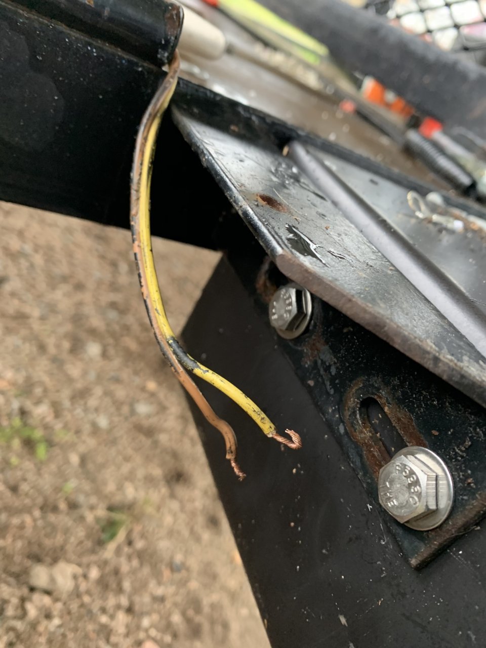

    Yeah white is ground. I grounded it to a bare metal spot on the light box. I got them to work but only as turn signals. Ideas? I have no running lights
    Edit: Think I fixed this issues. I had black hooked to yellow. Gonna reverse it and see
