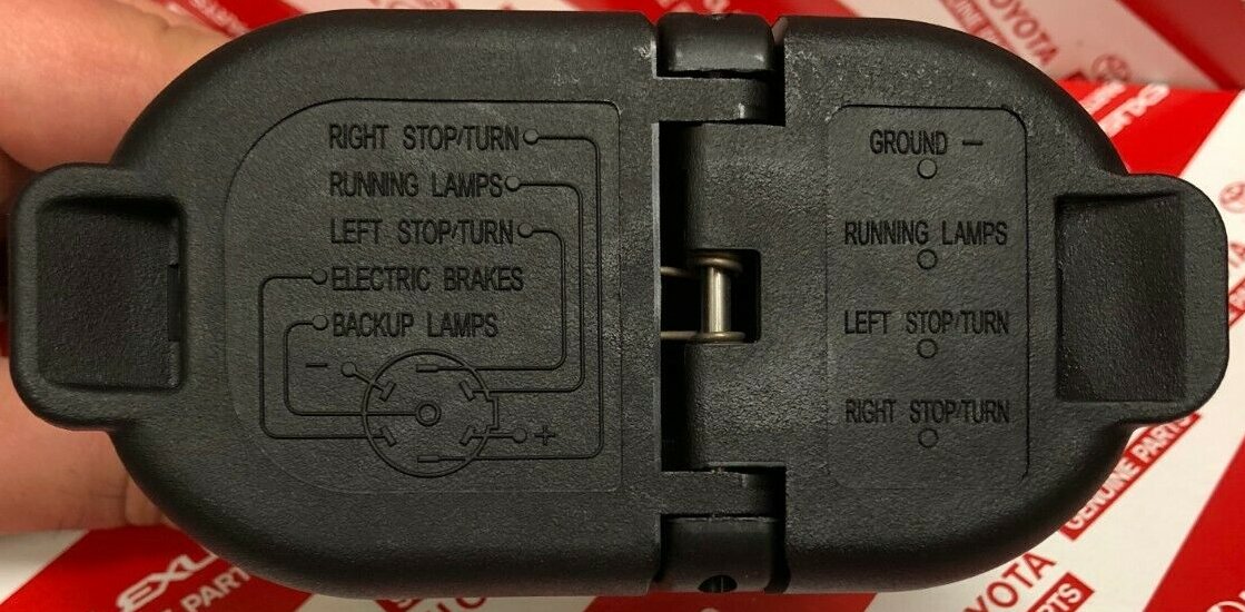

    Yup, either bad ground or the harness is shorted somewhere. Since you said you tried 2 different trailers, And I'm assuming it WAS working and nothing has been re-wired since, left blinker making both sides flash tells me the left blinker circuit is shorting to the tail light circuit. The fact that it's doing *something* tells me the fuses are good. Are they flashing dimly like tail lights? or brightly like your flashers are on?
    Also, are you using an adapter to go from 4pin to 7pin? maybe the adapter is bad. water or corrosion inside could cause power to bleed over where you don't want it
    An adaptor/test plug with indicator LEDs and/or basic $10 multimeter will tell you where the failure is. Test each function at the truck's plug and make sure the wrong pins aren't getting power for each one. Just be careful not to short any of the trucks pins to the ground pin, or you'll be chasing your tail a while before you find out you've popped fuses
    If the truck tests good, and you've tried 2 separate trailers with identical malfunctions, it's gotta be the adaptor you're using. To verify that, switch the multimeter to continuity/ohms mode and check that you have NO continuity between any of the pins on each side. I wager you'll find that pins 5 and 3 (which happen to be adjacent) are talking to each other when they shouldn't be.
