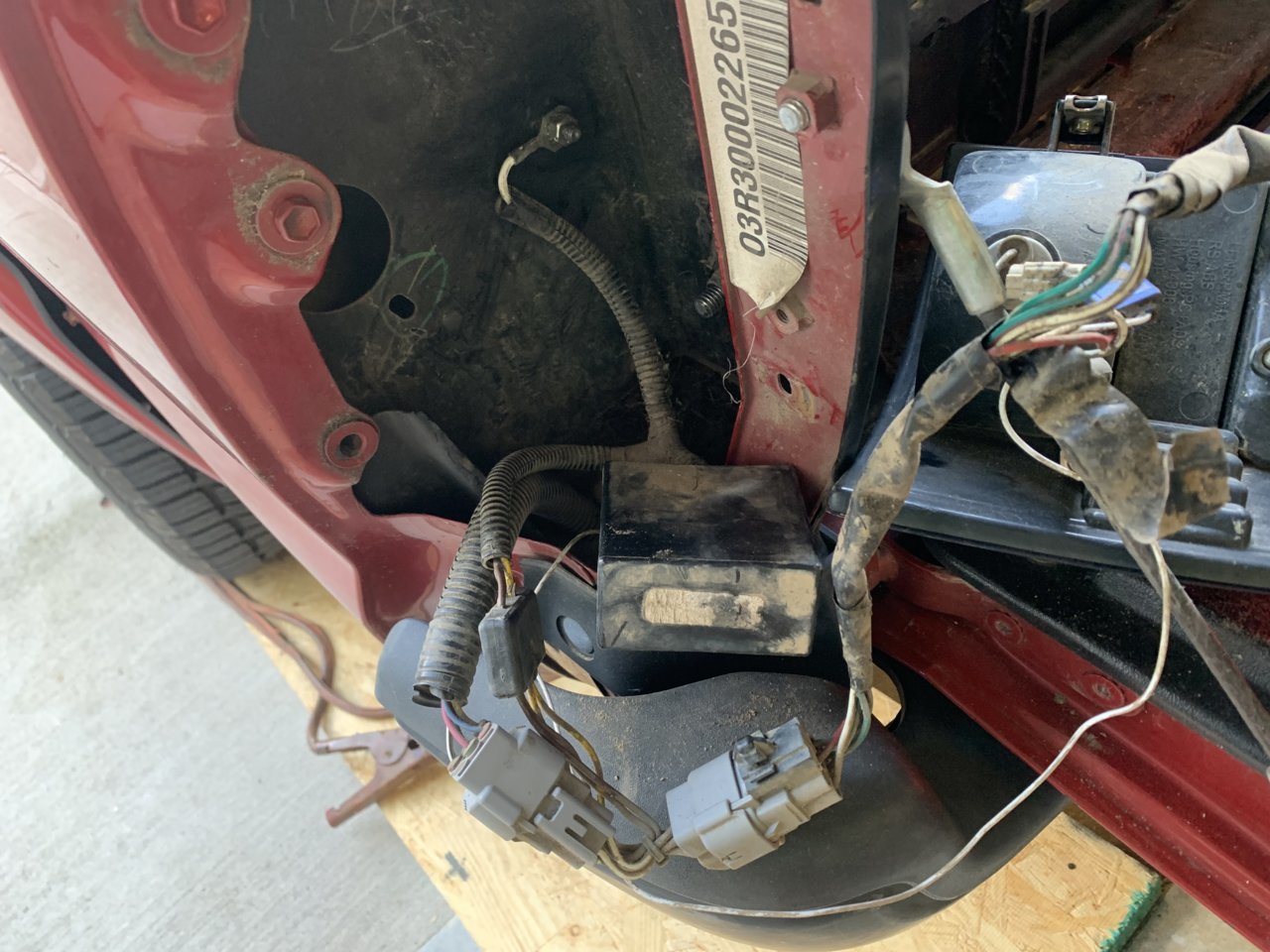

    I am having a similar problem. I have a 2013 taco with a factory tow package, (I believe)(bought the truck new with the hitch/etc on it) and it has 4 pin connector. None of the trailer lights work. They worked in 2022 for sure. Tail lights/trun/brake all work normally on the truck itself. I also have a tester, (Hopkins Endurance Easy-pull LED Test 4 Flat Trailer Side (12") in the Trailer Parts & Accessories department at Lowes.com) and none of the tester leds illuminate. Same problem with 2 different (boat) trailers. - no lights work. So, the problem appears to be in the truck. Tracing the wiring from the on-truck trailer (4 pin) connector I see the harness goes up into the left (drivers side) tail-light. Looking there I see a white ground wire that is connected to a stud on the truck bed sheetmetal. I removed the wire terminator eyelet from the stud, cleaned the stud and eyelet with a wire brush, applied some dielectric grease and re-installed the eyelet/wire on the stud. Still no money... Connected a jumper from battery negative terminal to the stud mentioned above (just in case there was a body (bed) grounding problem. Nothing.
    There is a black junction box right there in the trailer wiring behind the left tail light. It is about 1.25" thick, x 2" x 2". What is that?
    Any other thoughts?

    Here is a pic of the “black box” (near the center of the pic). Note the white ground wire in the upper part of the pic. AC982943-8A80-4D45-B52C-F545D1538138.jpg

    That's not the factory tow package, trucks with the factory tow package will have a 7 way plug and not converter box.
    If all the lights work properly on the truck odds are the power/ground (if it has external power/ground) to the converter box is bad or the box itself is bad.

    Thanks Dm93. Maybe the tow package is dealer installed. Like I said, it was on the truck when I bought it new, but again, maybe the dealer put it on. I will say that whoever did it did a nice job of putting the new wiring in wire loom, etc.

    It's definitely not a factory tow package, like I said trucks with the factory towing package have a 7 way plug with dedicated trailer wiring (no converter box) in addition to an engine oil cooler, larger alternator & battery, transmission cooler (A/T), and class IV hitch.
    I'm not sure if trucks without the tow package still come with a 4 way plug or if that is a dealer add on but I think it's a dealer add on.

    There are of course and input and output sides to the converter box. Use a DVM on the input circuit and run through all your lighting combos. If those are all hot, the box is probably bad. You can test the box outputs too of course. If they are good, you have a problem in the bit of harness from the box to the plug.
    My bet is the box has failed.

    I got the Kurt converter box/t-connect plug & play kit and it fixed the problem. Thanks much to DM93, clearwater and all for your help and mini education. This is a great place!!
