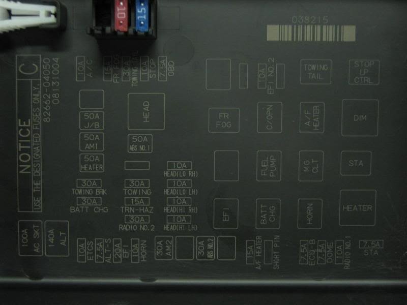

  9. Dec 7, 2016 at 3:40 PM
    Marcus Israd

    Check the trailer fuses first. There's a couple that control the trailer lights.

    This turned out to be my problem. Replaced and all is fine.
