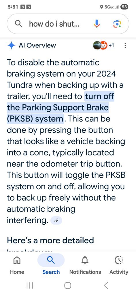

    Do you have a seven pin connection from your trailer. The seven pin contains the trailer brake wire which is what shuts off the auto braking. I know there is a work around without the 7 pin but I didn't really pay attention since I don't own a trailer without a 7 pin. If there isn't a solution here on tacoma world . The subject is discussed in several threads on Tundras.com I'm sure the work around is the same.
  6. Jun 11, 2025 at 5:52 AM
    dklehman
    dklehman Well-Known Member
    Aug 22, 2021
    #374961
    819
    Darin
    Eastern wa
    2021 TRD off road
    This is what Google says.
