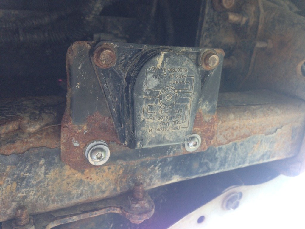

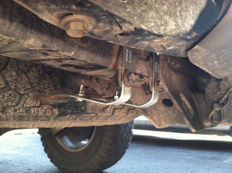

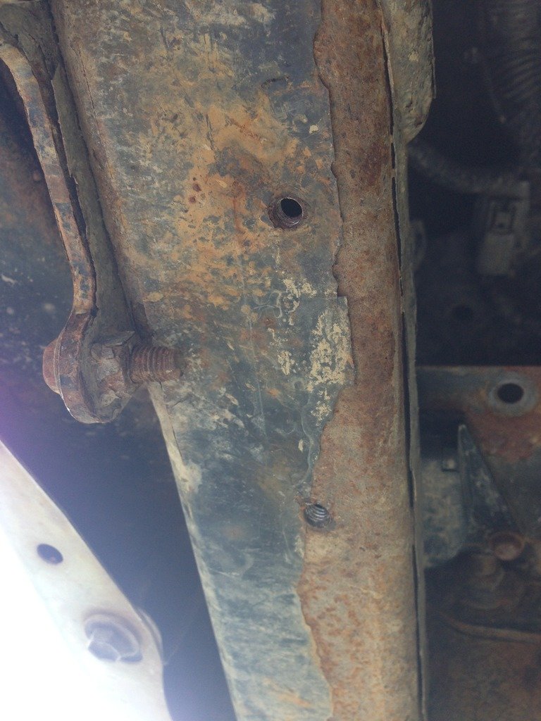

  15. Jun 6, 2016 at 9:58 PM
    #35
    steveo27
    steveo27 [OP] Ask me about my weiner
    Aug 12, 2013
    #110326
    5,992
    Steve
    Pittsburgh
    '11 TRD Off Road & 1992 VW GLI
    The same shit everyone else has.
    Well, I pulled the trigger and did it.
    Drilled and tapped 2 m6 holes and bolted it on.
    9A6E79E6-B8FC-4CA6-9EB0-F893008F1EA5_zps_7a2b160a5a2098b39d21ab167d707f2c0735eb6f.jpg
    B13AB0EB-60D4-4147-8CA2-D4368D34C4D5_zps_b7d3a0e562102c8fc125438cdda3b9eceee429e7.jpg
