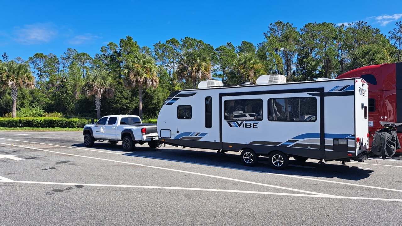

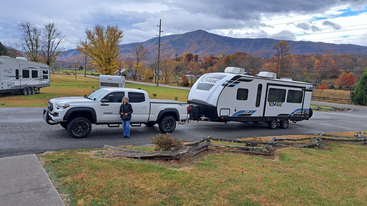

    I learned that if you do your homework, it will all come together with your Tacoma. We had a 25rk Vibe dry weight was 5988lbs. Then I traded to my new Flagstaff. Last year we went to Kentucky, and then to Virginia and stopped off in Tennessee. Traveling for over 4 weeks. I put over 4600 miles on my truck my gas average pulling was about 9.9 to 12.0 mpg. The truck did great. We will going soon to Texas on our next trip.
    mic_sierra likes this.

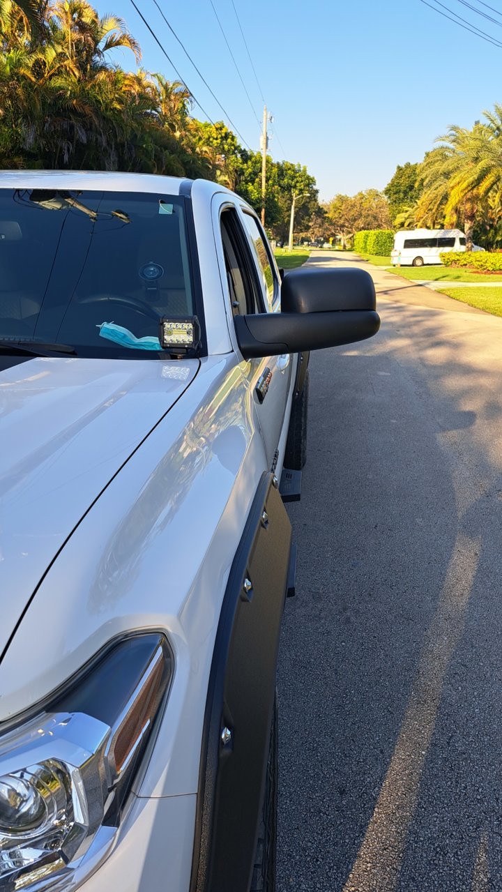

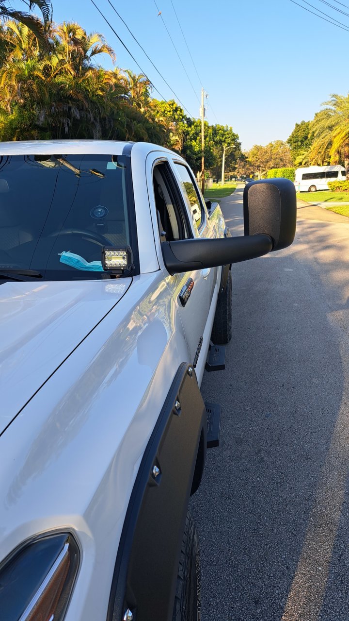

    Got these tow mirrors and they work great. They were under $300.00. You can get them on Amazon.20230227_080652.jpg 20230227_080701.jpg

    Thanks for letting me know, in case I tow someone larger in the future, the good thing about the GeoPro is that the width is around the same as the Tacoma. It might be a few inches more but I can still use my stock side mirrors while towing and changing lanes.

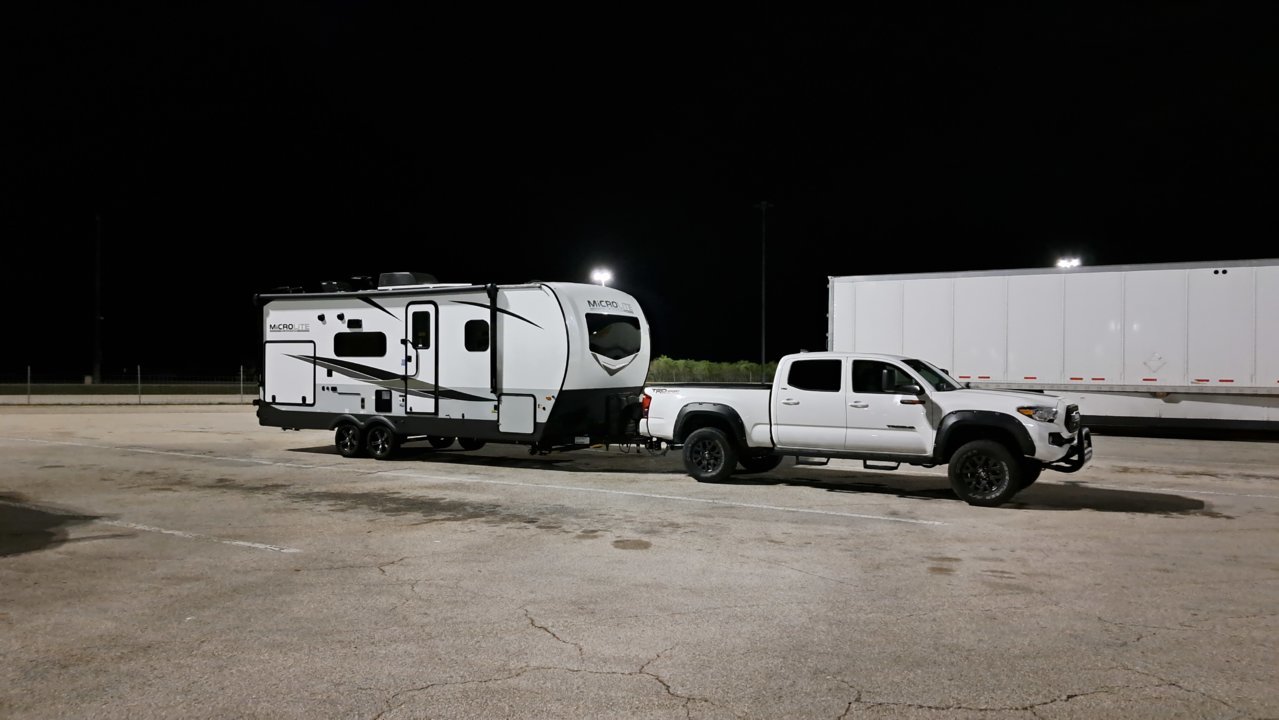

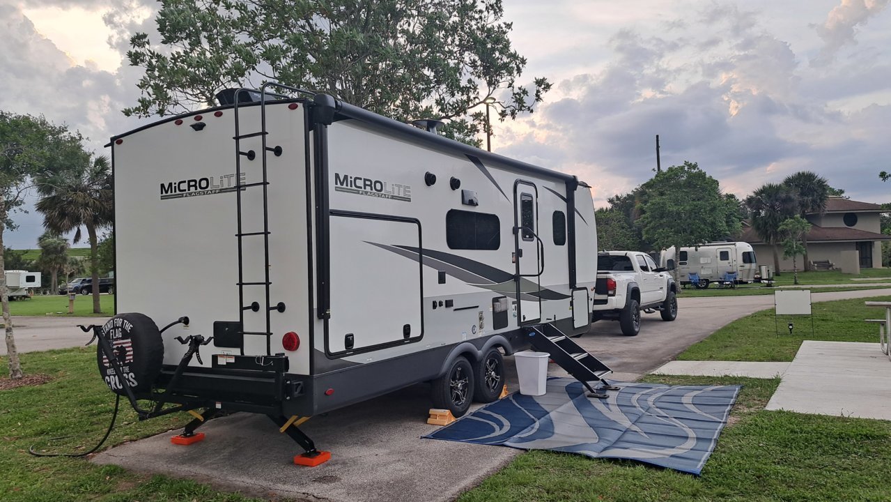

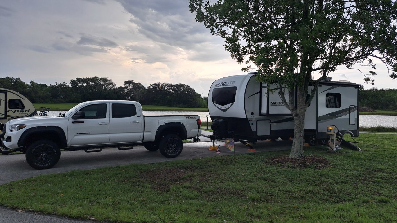

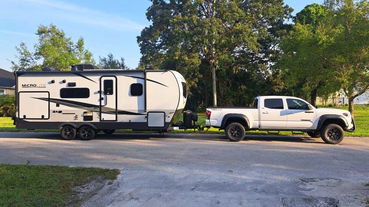

    Just got back from a 2700 mile trip with our new Flagstaff trailer. It pulled well and averaged 11.3 mpg. Hit some bad weather but slowed down in it. Went to Bald Mountain RV resort, Georgia. Pidgon Forge RV resort, Tennessee. KOA in Murfreesboro Tennessee. Fair Harbor RV resort North Perry Georgia. KOA Pensacola Florida. Then Lelynn RV Resort Polk City Florida. My 2020 Tacoma did very good.20230426_193927.jpg20230304_080341.jpg 20230430_082955.jpg
