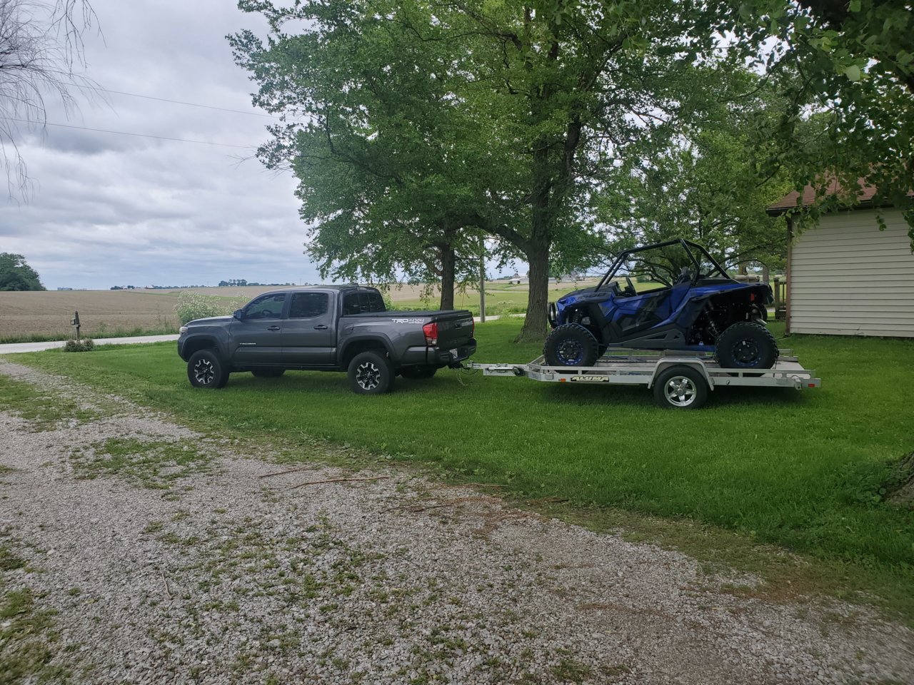

    I have a aluma 7712HTILT. Getting tongue weight right with a 2 seat rzr is a balancing act. I think a teryx 4 seater would be worse.
