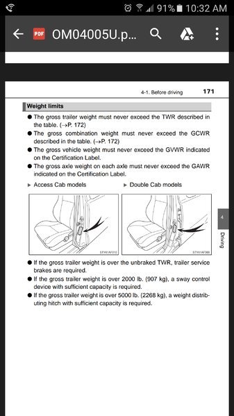

    I tow pretty much same exact size trailer. You definately want a trailer brake controller in fact most dealers won't let you leave the RV lot without one. Mount it somewhere you actually get ahold of the manual over ride controll if need be and not in the glove box.....
    I towed our trailer home with out a weight distribution system or sway controll due to the dealers ridiculous cost. It towed well without it but towed even better with it. I'm using passive friction sway device since the trailer is equipped with the active sway command system. The friction device makes a huge difference alone when getting passed by semi trucks. The WDH noticeably improves handling. I'm also running airbags which also help with handling and controll.
    With that said the brake controller is a must. Sway controll is highly recommended with a trailer of that size per toyota (see your owners manual).
    A WDH and airbags are not necessarily necessary but you will never regret using them.

    Toyota manual says sway control is required at past a certain weight.
