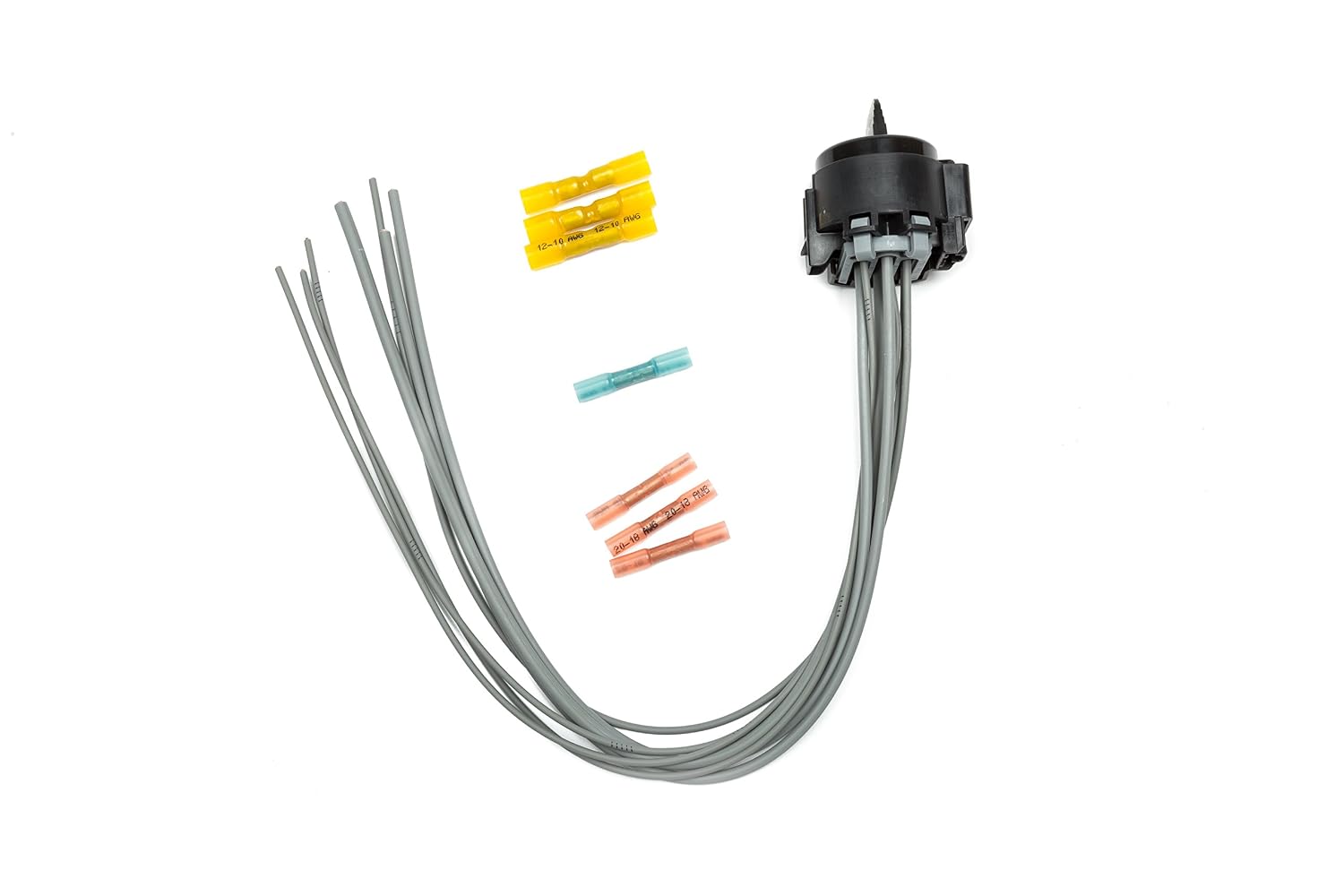

    I know this is a Tacoma forum (and I have one)
    but figured you guys might know, and supposedly the plug system works the same way on the Tacoma too
    it's on a GM; the trailer towing lights (brake lights/tail lights on the trailer) don't work.
    I found out the fuses are fine (checked them) but at the rear bumper plug, the connector behind it was loose. It doesn't lock in place fully because the locking tab on it is broken.
    The connector is plastic so it probably needs to be replaced (connector housing)
    eBay has one for $20 but the seller suggests it be crimped on I believe. Which seems not as good as replacing the existing connector housing (broken) and re-using stock wires, by de-pinning it.
    Anyone ever dealt with this?
    The broken connector is normally supposed to plug/click into this, the actual plug:
    (you can see where behind it)

    I think it might be GM oem part number 15306164,
    or AC Delco part number pt1322 "female trailer connector"
    which I don't understand why sales ads seem to suggest using crimps in their pic, instead of de-pinning it
    Here is an actual pic, which seems to look different from the $20 eBay connector
    the grey part behind the black main body of the connector housing protrudes farther on the vehicle than the one in the eBay part it seems
    the OEM one (if part number is correct) appears to have more stuff protruding from the black part

    7,489
    That does look very different than the industry standard parts that you posted in your 1st pic. Sorry, I can’t help you with that. Don’t know what your GM uses.
