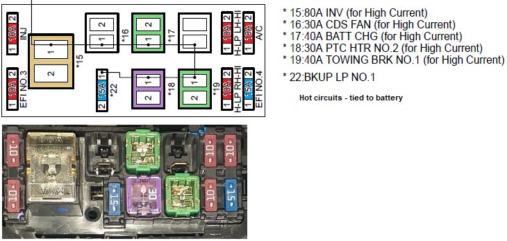

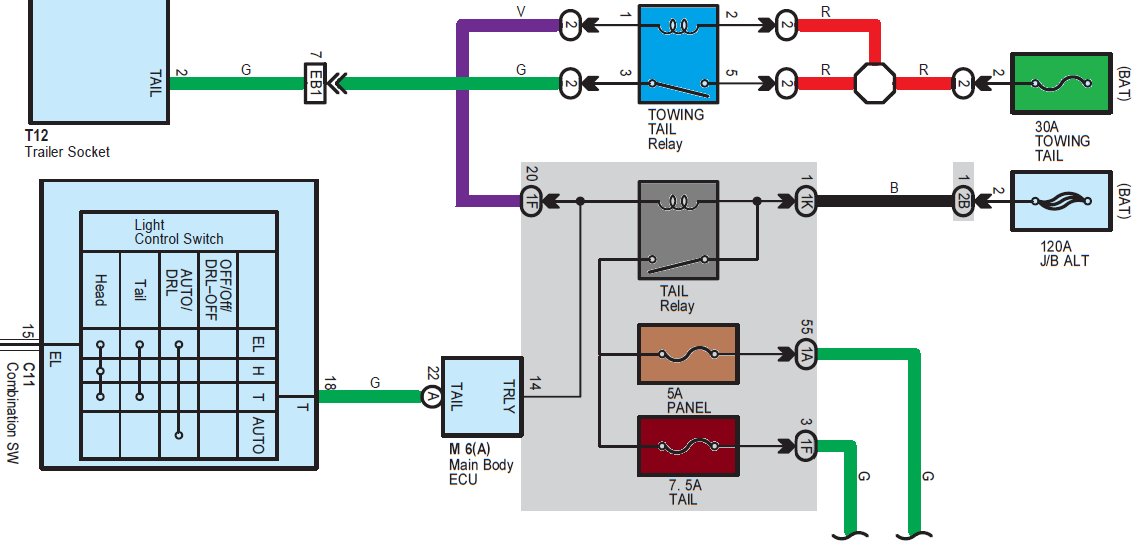

    1st make absolutely sure the 30A Towing Tail fuse is good.
    Do the tail lights on the truck work?
    I ask because the 30A Trailer Tow relay grounds with Tail Light relay for the truck.
    Take note here, there are 2 Tail Light relays. Tail and Towing Tail.
    If the truck tail lights work, you will need to pull the towing tail relay and check for power there.
    If the truck tail lights don’t work, we’ll it’s going to get a bit more complicated.
    BTW, you posted this in the 2nd Gen section.
    But we can surely help you figure this out:thumbsup:

    Maybe because the towing tail fuse is in the engine bay fuse box...

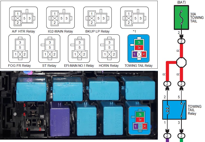

    Check all the places @caribe makaira said above.
    If the fuse is good, pull the relay.
    See if you have power to the relay. 2 should show power. (Pins 2 & 5 in the above diagram)
    If you have 2 showing power, you need to test the relay.
    If the relay is good, than you have a ground issue, a Body ECU problem (not likely), or a wiring issue from the relay to the Trailer Tail lights.
    You could ohm the wiring out (safest way) , or jump the relay (pins 3 & 5) to test the tail light wiring.
    DON’T jump the wrong terminals. As you risk damaging the Body ECU.
    @caribe makaira might have a Relay Pinout diagram.
    I know you said the fuse is good, but I’m still sticking with that for the time being.
    If that’s definitely not it, then the relay or wiring.

    Remove the relay, set it aside.
    With a multimeter, check slots for pins 1 & 2 with the light stalk turned to parking lights.
