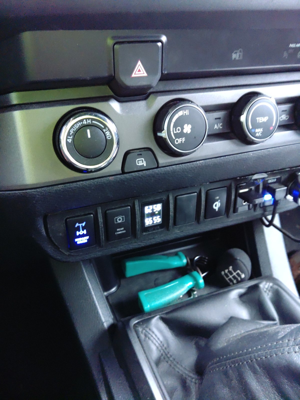

    I pull a trailer almost constantly for work and I was looking for a clean way to monitor the pressure of my Air Lift suspension. I haven't seen anyone else do this yet and it took a little research and figuring, so I thought I would share what I did.

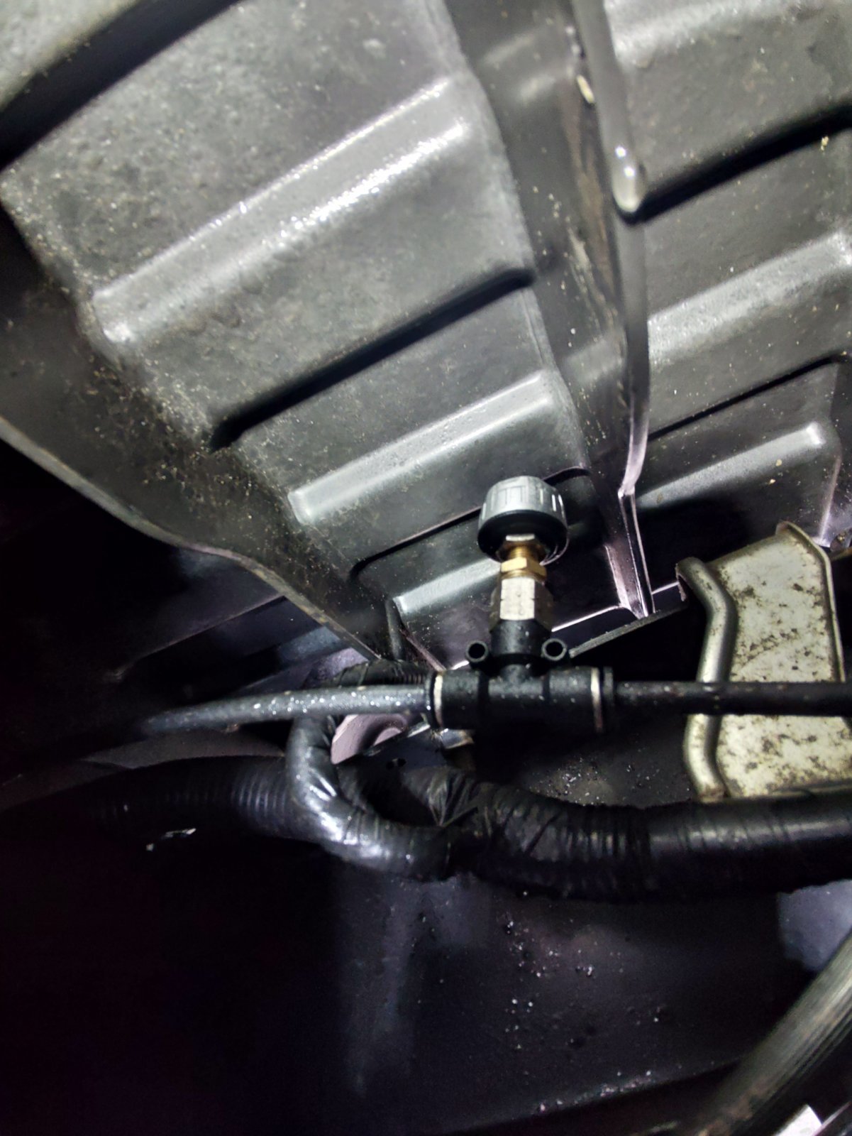

    I came across the Careud U912 TPMS that fits in a standard switch slot. I got the version that screws on to the tire valve cap, since my air bags inflate via standard schrader valves. I could only find that version through aliexpress, but it showed up and works just fine.
    I decided that the top two numbers would be for my airbags and the bottom two numbers would be for my trailer tires.
    Turns out that those valve cap pressure sensors are a pain to take on and off, and I kept losing a bunch of air trying to get it back in place. The airbags don't hold much air, so a little bit of air makes a pretty big difference in pressure. I wanted to add another schrader valve to the line, under the truck, to keep the sensor permanently mounted.
    After educating myself on schrader valves, Push-to-connect fittings, and NPT thread size options, and an epic internet search, I finally found the push-to-connect T fitting that would work with the correctly sized schrader valve that I wanted.
    That worked out perfectly. After confirming that the fittings were holding pressure and that the unit was receiving the information, I took off for work...
    ...and was rewarded with the very loud alarm sounding for the 7 hour trip!! :frusty: I knew that there would be an alarm for over pressure, under pressure, and over temperature. All of those can be set so that the limits are well outside of the working range to prevent the alarm.
    What I failed to notice in the instructions was that there is also a "rapid pressure change" alarm. That would be great for tires, as it would let you know within 3 seconds of your tire starting to deflate if you got a puncture. The issue is that the airbag pressure constantly changes every time I hit a bump, go around a corner, change lanes, accelerate, decelerate, etc, etc...

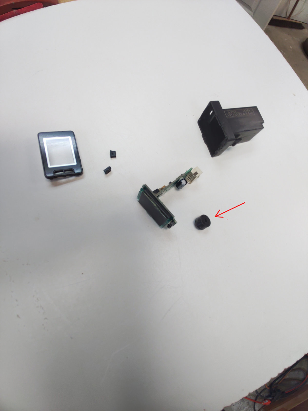

    I figured I had two options. Either figure out how to get rid of the buzzer or add a switch to the unit. Adding a switch would allow me to check the pressure before starting the trip and then turn it off to prevent the alarm. That would be a bummer not to be able to keep tabs on the system throughout the trip. I figured I'd risk it for the biscuit and worst case, I would just have to order a new one.
    Hot tip: Don't push this receiver into place until you are ready to have it permanently in the dash. It is a very tight fit and super hard to get back out. I popped the switches out on either side of it to reach in and press the little releases, but no dice. I ended up having to take the whole dash apart again.
    Tearing the receiver apart was another learning experience that I can get into if anyone else ever wants to try it. I ended up breaking mine open and gluing it back together afterwards. Removing the buzzer was straight forward with a soldering iron.
    It was a little more work than I expected, but I think it's a super clean solution.

    The airbags are actually on the rear axle of my truck. That keeps the truck level if the trailer tongue weight gets a little heavy. I am using this Air Lift kit.

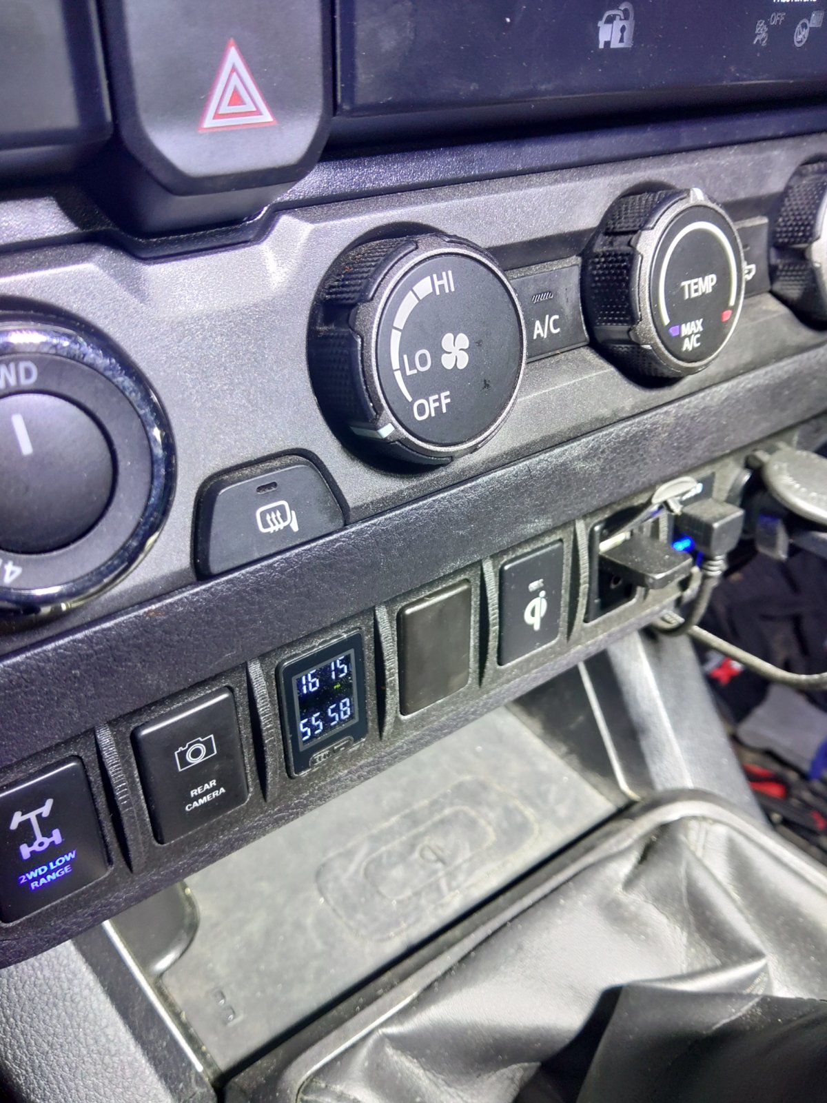

  6. Jan 27, 2024 at 7:53 AM
    ThisBen
    ThisBen [OP] Well-Known Member
    Dec 4, 2021
    #383754
    126
    Ben
    2019 Toyota Tacoma Sport - MT access cab
    Slightly better picture:
    TartanEagle likes this.

    Please do elaborate on the buzzer removal .
    I'm sure it's not rocket science, but I do have a thirst for info.
    If I do this, and I'm sure I will, that buzzer will be yanked
