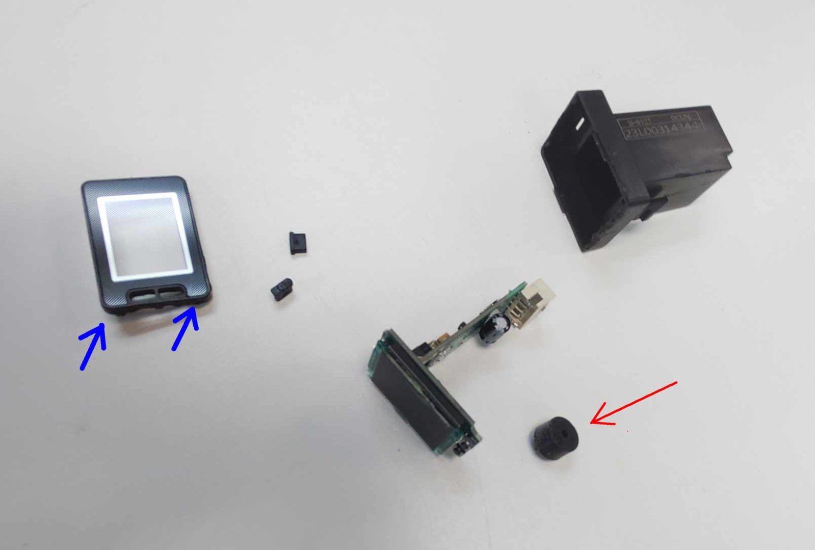

    I wish I would have taken a lot more pictures of this process, but I didn't think about it at the time. There MAY be some hope of not breaking this while disassembling it, but I would have some epoxy handy anyway.
    1) There are two tiny screws hidden by the site-glass plastic in the bottom corners (blue arrows below). You may be able to use a razer blade to peel that up to get to them. The top is clipped into place with two, delicate plastic hooks. You can see the tabs that the hooks engage on the top edge of the socket. If you get the screws out and gently pull the bottom of the faceplate out, I imagine the little hooks will disengage. If not, that's what the glue is for.
    DON'T LOSE THE BUTTONS. They fall right out and they are tiny.
    2) The white electrical connector socket on the back also has a little plastic clip that you can easily push to release the electronics from the plastic housing.
    3) The little piezo buzzer (red arrow) is attached by two little stubs through the circuit board. I put a fine point on my soldering iron and released the buzzer by melting the solder on each. I took a chance on that one too, hoping that the speaker was wired on its own in parallel instead of in series with some other feature. I guess we're lucky on that one. Everything still seems to be working great.
