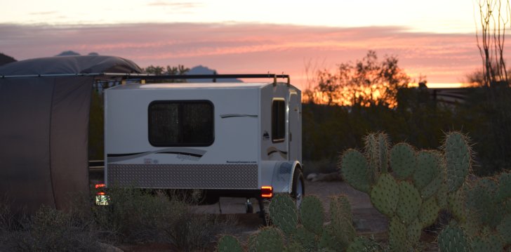

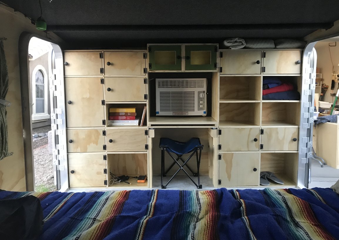

    I guess my 1,000 pound teardrop should be no problem 'eh ?
  14. Apr 5, 2021 at 8:10 PM
    #34
    USAFAMMO70
    USAFAMMO70 [OP] Member
    Apr 4, 2021
    #361654
    10
    2019 Cement TRD Off Road 6ft
    Backflip Mk4 Tonneau

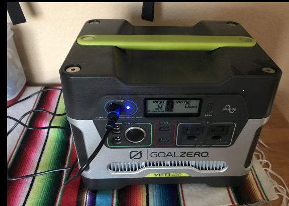

    Wow, what a beauty! What generator do you run the A/C with?
  15. Apr 5, 2021 at 8:40 PM
    #35
    2021SR5V64WD
    2021SR5V64WD Well-Known Member
    Mar 29, 2021
    #360995
    3,636
    2021 SR5 V6 4WD ACCESS CAB
    We plug into electricity where available... not into noisy generators, if no power then we go without.
    I use a YETI400 GoalZero coupled with a battery for other power, lights, cpap machine, usb plugins for phone charging.
    Solar panels live under the bed to recharge the GoalZero when needed.
    These thing come completely empty - and you can trick it out as you please.

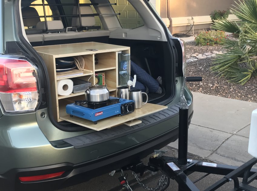

    The wife tricked ours out:
    The GoalZero lives on the left hand quadrant ( open space ) and back-up battery lives next to it in closed hatch with cut-out to pass-thru cables.
    She built this chuck-wagon-box we carry in the back of the Subaru (soon to be carried by the Tacoma) so we can pull
    over and make a quick cup when on the road. Give me coffee or give me death. I roast my own beans too.!!
    Action shot in Grand Canyon:.. home-made awning system works on either side depending on where we land.
    Action Shot in the desert:
    All the comforts:
