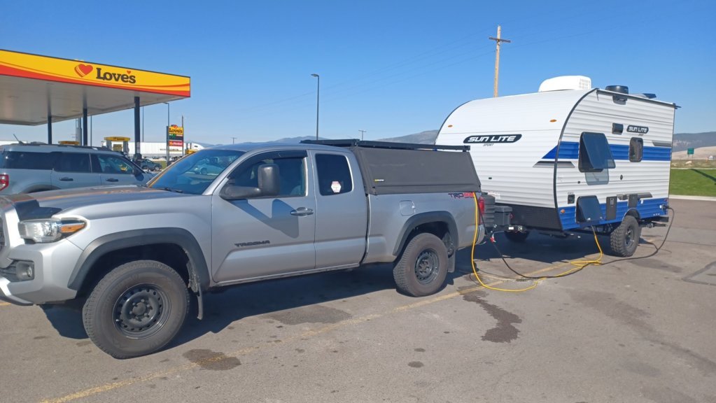

    Started full time RV'ing end of September '24 with a 2017 TRD Off Road - purchased July '24 (just under 70k miles at purchase) and 2025 camper 16.6' with empty weight of 2,650lbs. I have not scaled the setup, but guesstimate total weight with gear in camper & truck bed is around 3,300lb. I added Airlift LoadLifter 5000 bags to reduce stress on rear suspension and installed Scangauge II for monitoring transmission temps.
    When I installed the Scangauge II and left on my trip, I had not done any research, did not know TF2 is the TC temp and TF1 trans temp. I learned this in the forums here.
    While I logged over 1 million miles driving CDL before hanging up the keys, towing a bumper pull trailer long distance is a new experience.
    Started in S.W. Michigan, went to Missoula, MT, then to Quartzsite, AZ to hibernate on BLM LTVA (Long Term Visitor Area) where I've been off grid since mid November '24. Still in Q when created this post.
    While getting familiar with the handling characteristics of the setup I only drove 55mph. Ended up doing 55 the whole trip.
    Initially I used ECT and sport mode 4th gear. I have not noticed any difference with ECT on or off. I still use 4th gear, as 5th gear trans constantly hunted between 4th & 5th, trans constantly over 200 degrees, torque converter over 210 degrees.
    On level ground, trans & TC will stay around 185-195 at 55mph 4th gear. If any sort of head wind or cross breeze, transmission frequently drops to 3rd, even on level ground, trans & TC jump over 200 degrees. On long climbs the TC could climb over 230 degrees, trans around 210 depending on grade %. The worst was the westbound grade on I-90 around Butte, MT - TC went over 250, trans 230. I pulled over a couple times to let trans cool down. There were other instances when I pulled over to let trans cool off but do not remember where, mostly when TC went over 230.
    Unfortunately I don't remember engine RPM at 55mph, maybe 2,200 - 2,400. When dropping to 3rd I believe it was around 3,500. Averaged 10 mpg overall trip.
    After researching the forums, I'm going to pin the trans thermostat before I leave Quartzsite heading north. Hopefully that will help trans temps stay lower and not need a bigger / extra trans cooler.
    While I'm a fan of Toyota & Tacos, this rig has been frustrating due to trans constantly downshifting in a breeze even on flat level ground, sometimes when getting passed by big trucks. I found out that stabbing the throttle will make it upshift - most of the time - but then might downshift again. Multiple times it dropped to 2nd gear & engine nearly redlined.
    The steel rims & new Firestone Winterforce tires where on the truck when I bought it, dealer mounted the tires.

    The V6 needs RPM's to make power, the transmission is downshifting to do that.
    Of course another part of the equation, often overlooked, is the amount of wind resistance a TT is adding.
    Also, I would run it over a scale loaded, added weight adds up awfully darn quick.
    I think it's great you are retired and out seeing this beautiful country though! Leave it in S4, park the right or middle lane, and have a fun and safe trip!

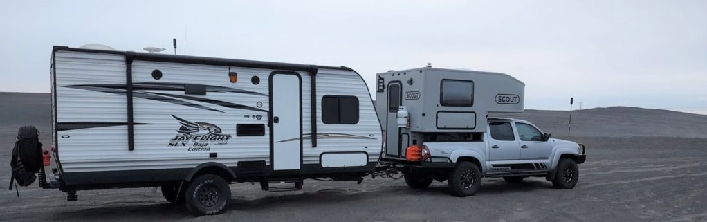

    Back before I had any camper setup, I towed my open car trailer quite a bit with a sxs and atv on it. Totalled around 3600 pounds. Adding a canopy, like yours, was able to get some of the air up higher or something and improved my mileage about 10% while towing. This was a regular trip back and forth from Seattle, over the Cascades, to Moses Lake, WA and back. Repeated results, so wasn't just a 1 off. With that, I'm curious if a high top camper shell might help you a little to get air up even higher on your camper.
    Towing the below actually barely changed my mileage compared to my open trailer. The wind resistance was negligibly different thanks to the Scout already being that tall. I'll also add the heavy-@$$ truck makes the towing nicer, in my opinion. The trailer doesn't bother the truck as much as a similar sized trailer I had pulled when bone stock. Mileage now is in the 8-9 range when towing 4000-4500 (open trailer) behind my Scout and keeping it to 60-ish.

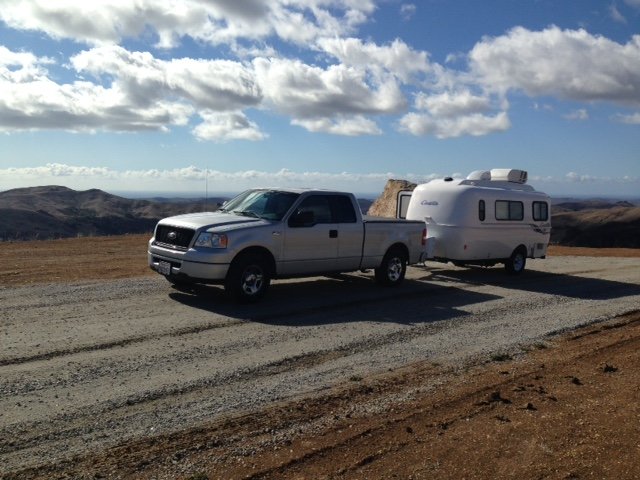

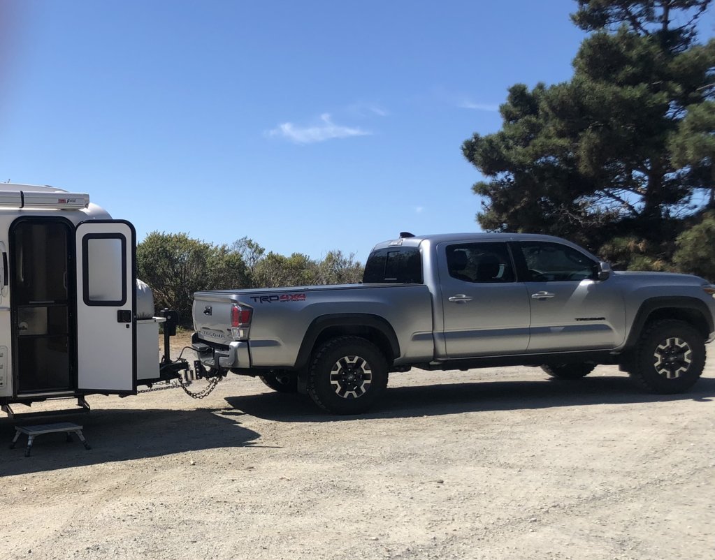

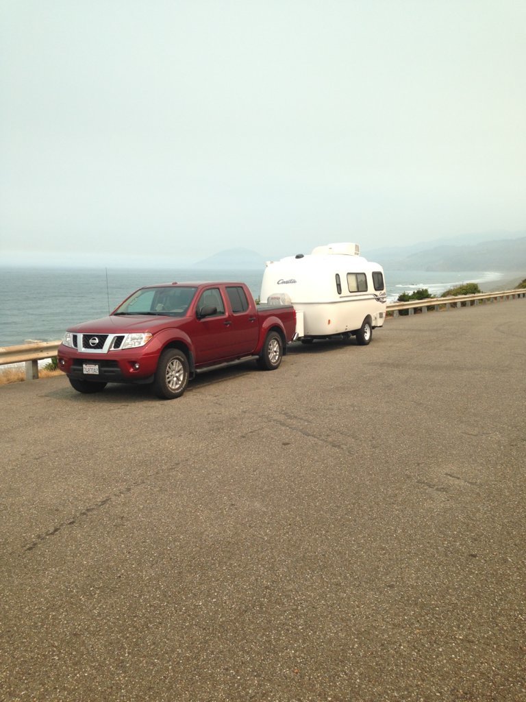

    My trailer is about 2,600lb dry and somewhere north of 3,000 lb loaded up for travel
    I have pulled it with my V8 F150, my v6 4L Frontier and now with my v6 23' Off Road Tacoma.
    No question my favorite TV is the Tacoma. I use ETC and S mode and often times shift it myself. I even use the cruise control on long flat runs without a headwind. I find the ETC makes a big difference when towing just by raising the shift points.
    I did add an Active Suspension rear system and I use a WDH.

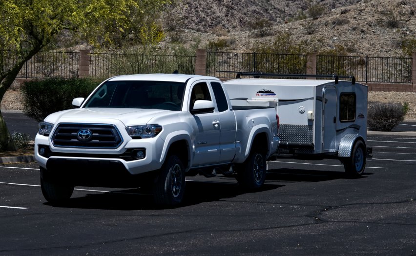

    Yea I'm not that impressed with the towing capability even with my dinky little teardrop.
    This thing weighs in at about 1000 pounds. I figure with the bed loaded with other gear add another 500.
    Not that much weight.
    The wife's Subaru Forester runs about the same as the truck with the V6 but gets way better gas mileage.
    The truck itself is heavier than the Forester but still.
    I run ECT and mode ( 4 ) and have found myself at times shifting down to 3rd in incline situations.
    And I have pushed up to 5 on nice flat areas or declines.
    I will say on flat-areas I can hardly feel it but gas mileage does drop to 10-12-...16 mpg depending.
    If you find yourself heading North out of Phoenix be prepared for inclines that will test your nerves.
