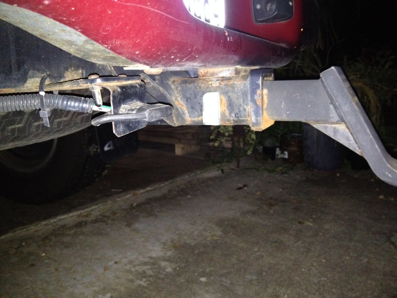

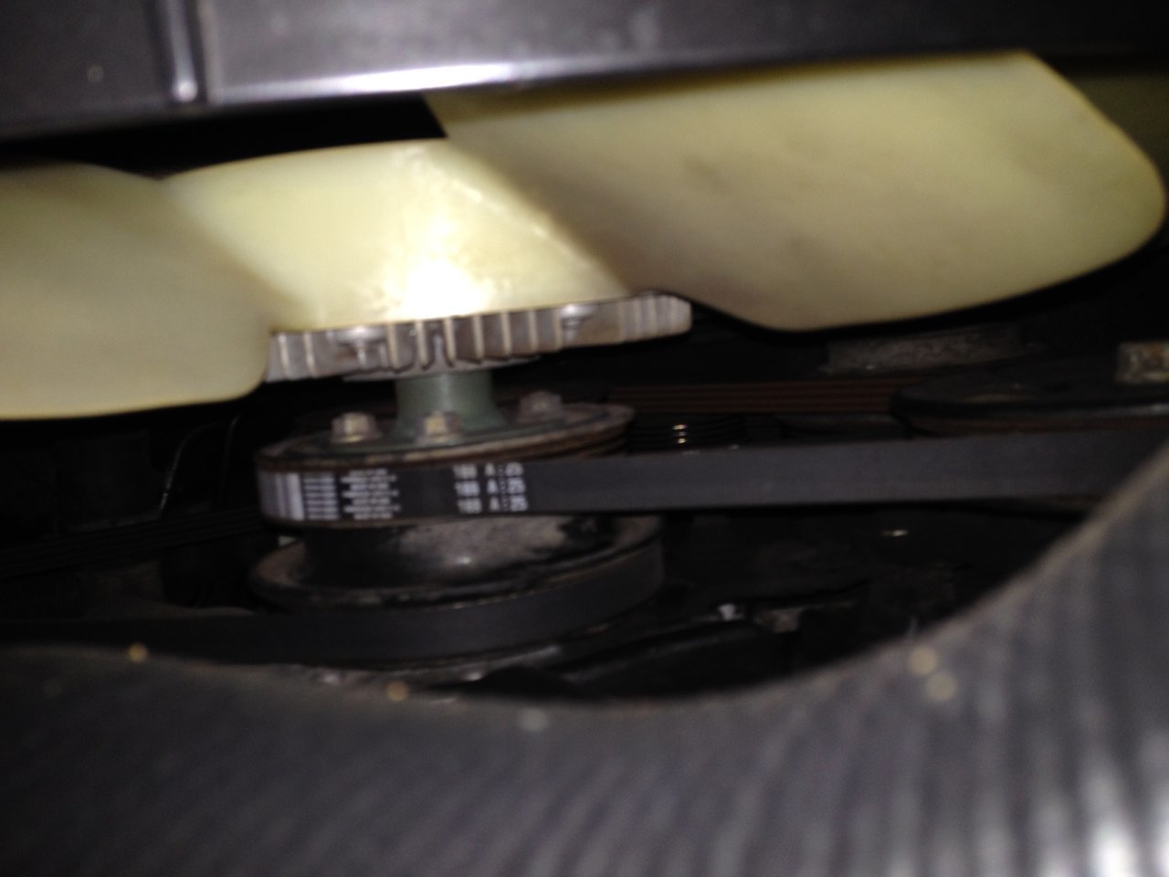

  5. Sep 24, 2017 at 12:07 AM
    paulwal
    paulwal Well-Known Member
    May 24, 2017
    #219871
    80

    I had thought the trailer Towing package was a dealer added option in those early days .
    Pretty sure they did not include a 7 pin plug
    The real question does it have a Auxiliary Transmission Cooler??

    A true factory tow package will have the small aux fuse box mounted to the back wall of the cab. Behind seat. Most were dealer installed. Never seen one woth an auxiliary trans cooler. Not saying its not possible. But never seen one. 4 pin connector only supports lights. Thats all the Tacomas came with.
