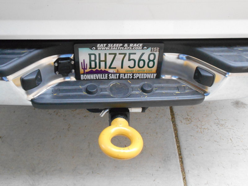

    Is this the one you ripped off? I put a hole in the bumper on the driver side of the license plate....... with aftermarket socket - but I think you can get the same part as the OEM from Honda.

    I like the mount how did you cut the bummer?

    Milwaukee bi-metal hole saw will do it. I've got an adapter to use with smaller 4 pin.

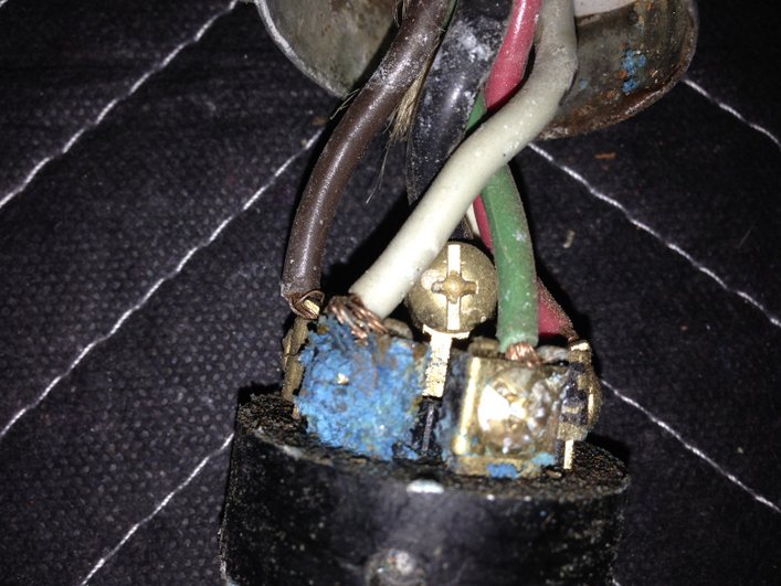

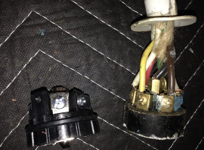

    inspect those connectors regularly and keep them greased. I had to replace my 7 pin b/c of corrosion.
