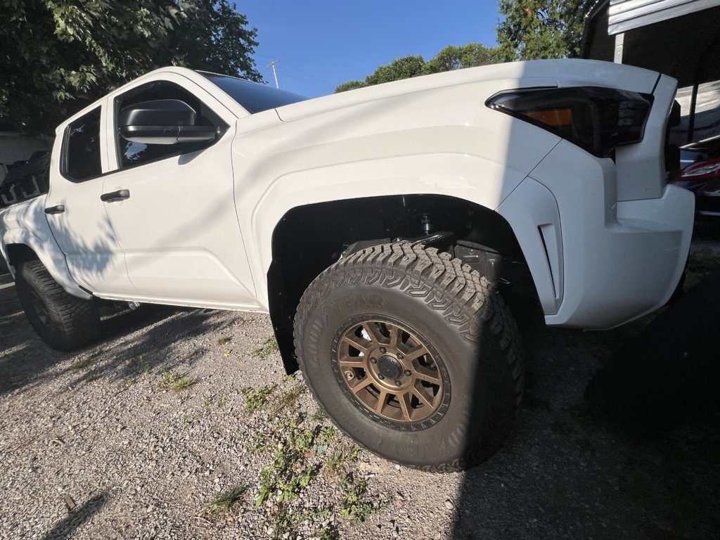

    Icon 2.5 suspension 35" tires 17x8.5" rims +35 offset
    315/70/17 +35mm offset 34.4" OD, This pic is prior to the icon 1.75" shock install IMG_6575.jpg

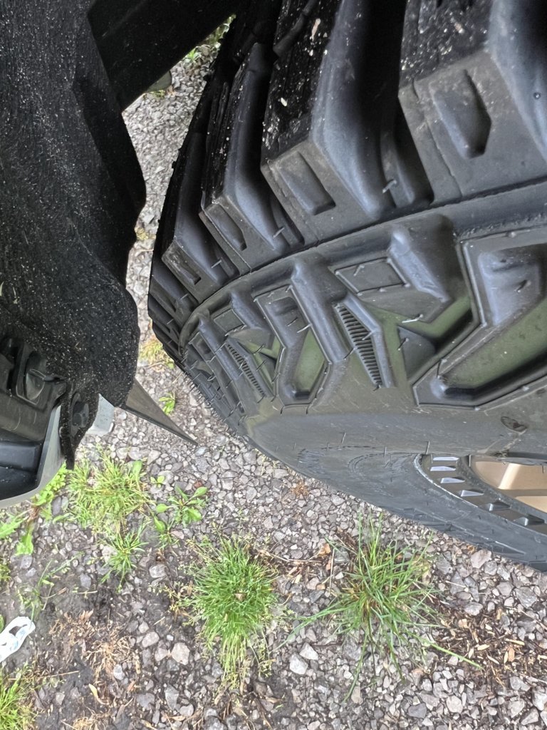

    Sean
    2024 Tacoma trd sport
    Icon stage 3 lift, icon wheels with Toyo open country 35” tires, addictive desert designs bumper with warn eco 10s winch and Baja designs 20” light bar. Prinsu pro cab rack with Baja designs 40” light bar, Baja designs ditch lights. AFE rock basher exhaust system, k&n intake.
    Currently running a readylift sst 2.5” kit and allowed me to run 35x11.50 toyos on mine. I have zero rub currently and it’s only gonna get better as my icon stage 11 kit gets installed in 2 weeks!IMG_1027.jpg

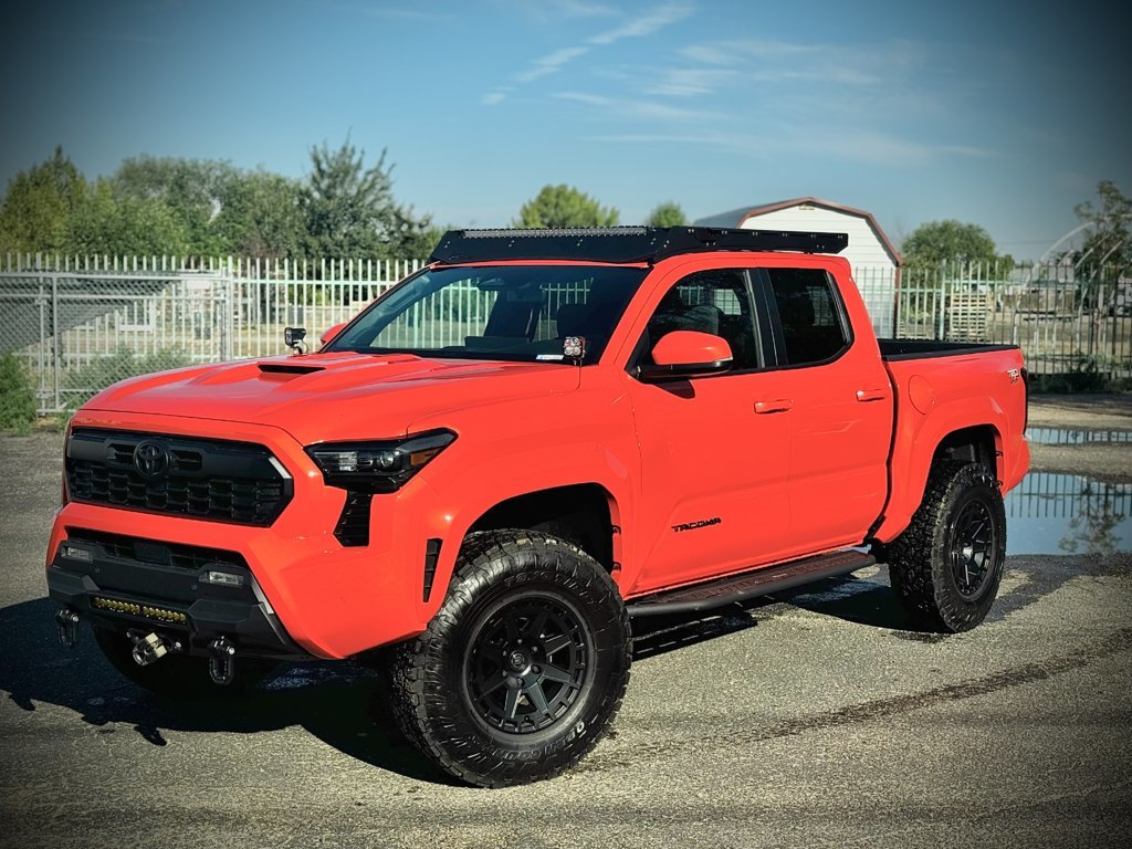

    Montana
    2024 TRD Off-road
  16. Sep 5, 2024 at 12:48 PM

    63
    None of these are trailhunters (with OME suspension).
