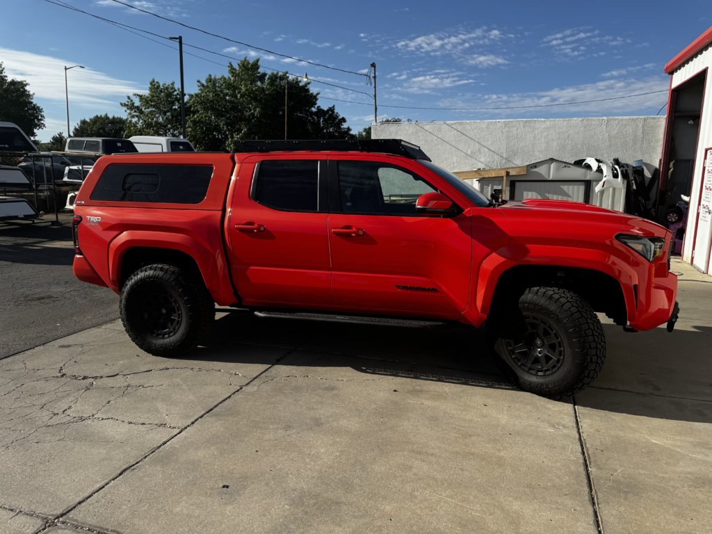

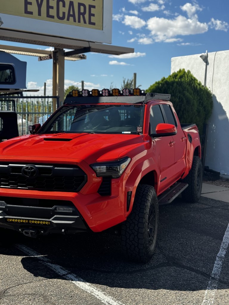

    Icon stage 3 lift, icon wheels with Toyo open country 35” tires, addictive desert designs bumper with warn eco 10s winch and Baja designs 20” light bar. Prinsu pro cab rack with Baja designs 40” light bar, Baja designs ditch lights. AFE rock basher exhaust system, k&n intake.

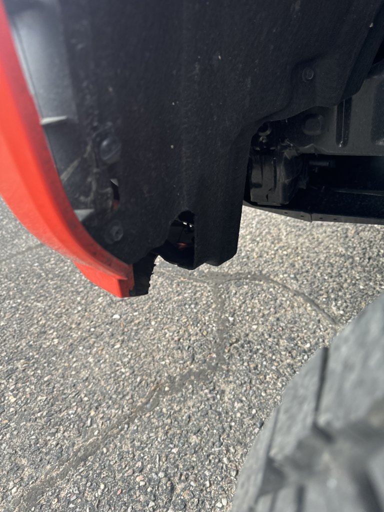

    IMG_1183.jpg IMG_1107.jpgMines been on 35x11.50s since April and I’ve put over 3k miles on it including serious off roading and I have zero rub issues at all. I did remove the factory frame horns and mudflaps to make space. Otherwise the only trimming was a small bit of the front fender liner. Full compression on road or off I’ve not rubbed since.

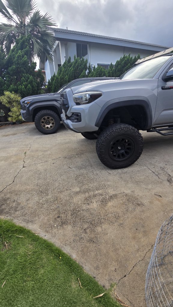

    My trailhunter with 35x12.5 Toyo MT

    Tell us more please. I have a pro and want to put Nitto 35x12.50's on it, like I had on my jeep. The Nitto's are 13.5" wide. I am afraid they would rub when stuffed.

    Remove the safety bracket in both front fenders and it will fit. Minor rubbing sometimes at full turn. You can trip some plastic or run a small spacer
