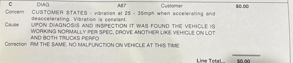

    I have a stock 2025 TRD OR with a 6ft bed and only 800 miles on it and am experiencing vibration issues around 25-35mph. It's not very noticeable when you accelerate past 35mph but when driving at a constant speed in that range it can be very annoying. It feels like something is reaching a natural frequency and inducing a vibration (tires, cv joints, driveshaft, etc). When slowing down to a stop it's also noticeable. I took it in today and the dealer drove my truck and another Tacoma (without me) and claimed that vibration is normal as the other Tacoma did it as well. I hopped in an SR5 with the service manager and we were unable to detect the same issue. The dealer did nothing other than a test drive of my truck and another truck. I am taking it back next week and dropping it off for an extended diagnosis and they stated they would open up a complaint with Toyota.

    Similar to my experience. LTD HV trim. Dealer claimed they couldn't reproduce. Did a service ride with the technician driving and called their attention to it. They confirmed they felt what I was talking about. A day later they diagnosed it as "normal". I was pissed.
