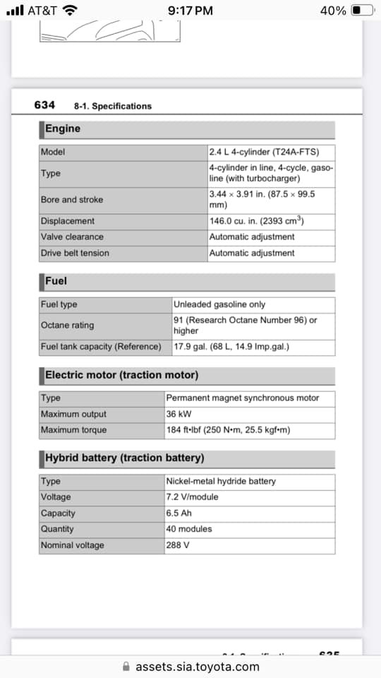

    Is there a reason why two vehicles with the exact same powertrain are recommended to use different grades of fuel? This would definitely cause me to wonder whether the '24 Tacoma should also be running premium gas.

    The Tacoma shouldn’t be running premium or else that manual would specify that. A simple change to the ECU tune is all that’s required to make the Land Cruiser need premium.

    Pssh. I have no idea. I thought it was regular until I actually had it in front of me, with the manual.
    I think the question he’s asking is if it’s that easy, and the power train is exactly the same, and the power train specs are the same…why would they? And idk
    It could be a detergent thing. It could be a knock thing. It could just be tunes for a more precise detonation…
    but again, then why not do that on the Tacomas premium trims? If it isn’t necessary, why allow consumers to waste money?
    those kind of questions.
    https://fueleconomy.gov/feg/Find.do?action=sbs&id=47762

    omg i cant, it says for optimum performance/fuel economy use 91+, its not required

    It boils down to tuning. I can have my supercharged taco run on regular with the right tune. That’s all.

    So you’re saying to produce the same amount of horsey’s and the same amount of torque using the same engine and same general platform, they had to tune the landcruiser to use premium gas…?
    Which component caused that?

    Yeah, that's the conundrum. It's not like the situation before where you had the same 3.5L in the Highlander and RX350, with the latter asking for premium and making more power.
    Maybe the published numbers are off? Or maybe the claimed Taco numbers are only attainable with premium. We'll probably never know, but this will be a good 4th gen topic for years to come.

    Yes. The computer caused that (designed by the engineer). You can have two cars with all components being the same but tuned for different gas octane.
    It’s not new to Toyota. You’ll find variations of the 3.5 that only take premium such as the GS350 (pushing over 310hp stock/naturally aspirated) and super charged lotus Elise. While the taco and sienna minivan take regular stuff. All 4 examples will have different hp/torque curves.
    The taco has to take regular to stay competitive in the truck market, so a tune that optimizes for regular at the expense of ____ (power, longevity, efficiency, or whatever Toyota decided). LC owners won’t exactly be crying for regular gas IMHO. So yes this is totally possible.
    On the flip side, I’m sure the folks at hp tuners are working to unlock this Toyota generation (if they haven’t already). Then you’ll find tuners around the country who will try to take a crack at optimizing for fuel efficiency, power, track time, etc. Then at that point anything is possible.

    the land cruiser has this marketing gem as a selling point:
    Emission Rating
    Ultra Low Emission Vehicle BIN 125
    My guess is thats why they add that blurb about using a higher octane for optimal economy, the tacoma doesn't have that same emission rating.

    I think you may have found the answer. Higher octane does indeed reduce CO2 emissions if the engine is tuned for it.
