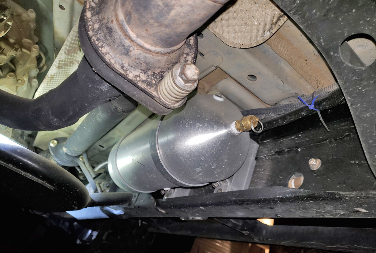

    I mounted mine on the bumper crash bar with the compressor (Viair 444c) where the bin was behind the rear driver side seat. I had the tank underneath.
    On my Tundra, I have dual 444c compressors mounted in the bed on the front wall (have a canopy), with 5 gallon take on pass side of bed above wheel well and 2.5 gal tank underneath. Horn will be mounted on passenger side inside frame rail. Installing single Hornblasters "Safety" Horn using 1/2" air line.

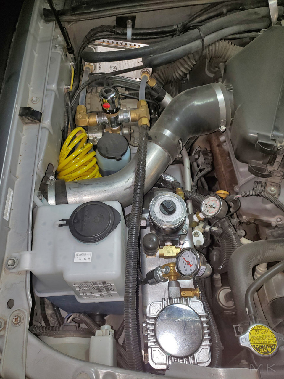

    I love train horns, and have collected a few, but I would like to make it clear that it is selfish and unacceptable to blow train horns from passenger vehicles in traffic, or within earshot of unwilling participants. They are dangerous and illegal.
    If that's you're plan, then you're an ass hole.
    That said, there's plenty of space to mount air compressors and reservoir tanks on these trucks. I fit a >5 CFM air compressor in my passenger-side engine bay, and mounted a ~1.5 gallon air tank off the passenger-side frame.
    This is for the purpose of airing up my tires on the trail, and not for blowing train horns. I do not have air horns on my truck, or on any other vehicles. I like train horns very much, but if you plan to install one in your truck and using it to terrorize people, then please ignore these suggestions and go fuck yourself, because that's not acceptable. Sorry for the coarse language... I'm assuming you're a level-headed respectful enthusiast, in which case, high-five dude. But I have to cover my bases.
    1.5 gal reservoir tank...
    >5 CFM compressor
    If you want a cool horn you can use on public roadways, here's a legal and non-ass-hole option to consider: Install a 4-tone Cadillac horn. It is loud, unique, and gobs of fun. Plus it won't deafen anyone, or give them PTSD. I absolutely installed one of these on my truck, and I love it!

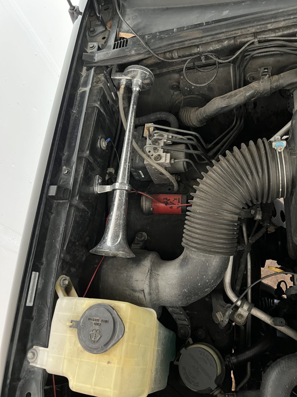

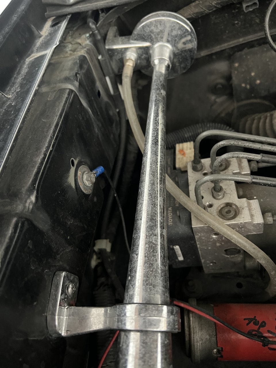

    My truck came with a single "train" horn in the engine bay. I'll snap a pic of it soon but it's great. It's much louder than any stock horn I've ever heard but not deafening - certainly gets people's attention quickly.
    This kit looks almost identical to the one that came on my truck - Audew 12V 150dB Single Compressor Air Horn | Audew.com
    It was wired directly to my steering wheel so functions like the stock horn. As far as legality, it passed a California emissions test, but the service tech definitely eyed it for an extra second.

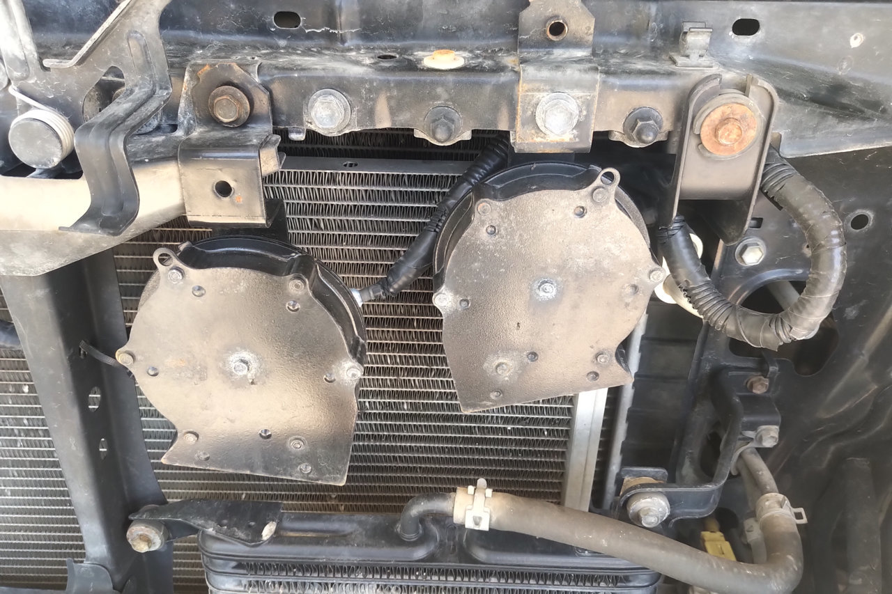

    "Park Avenue" ACDF horns

    Here’s the pic of mine and how it’s mounted as promised…
