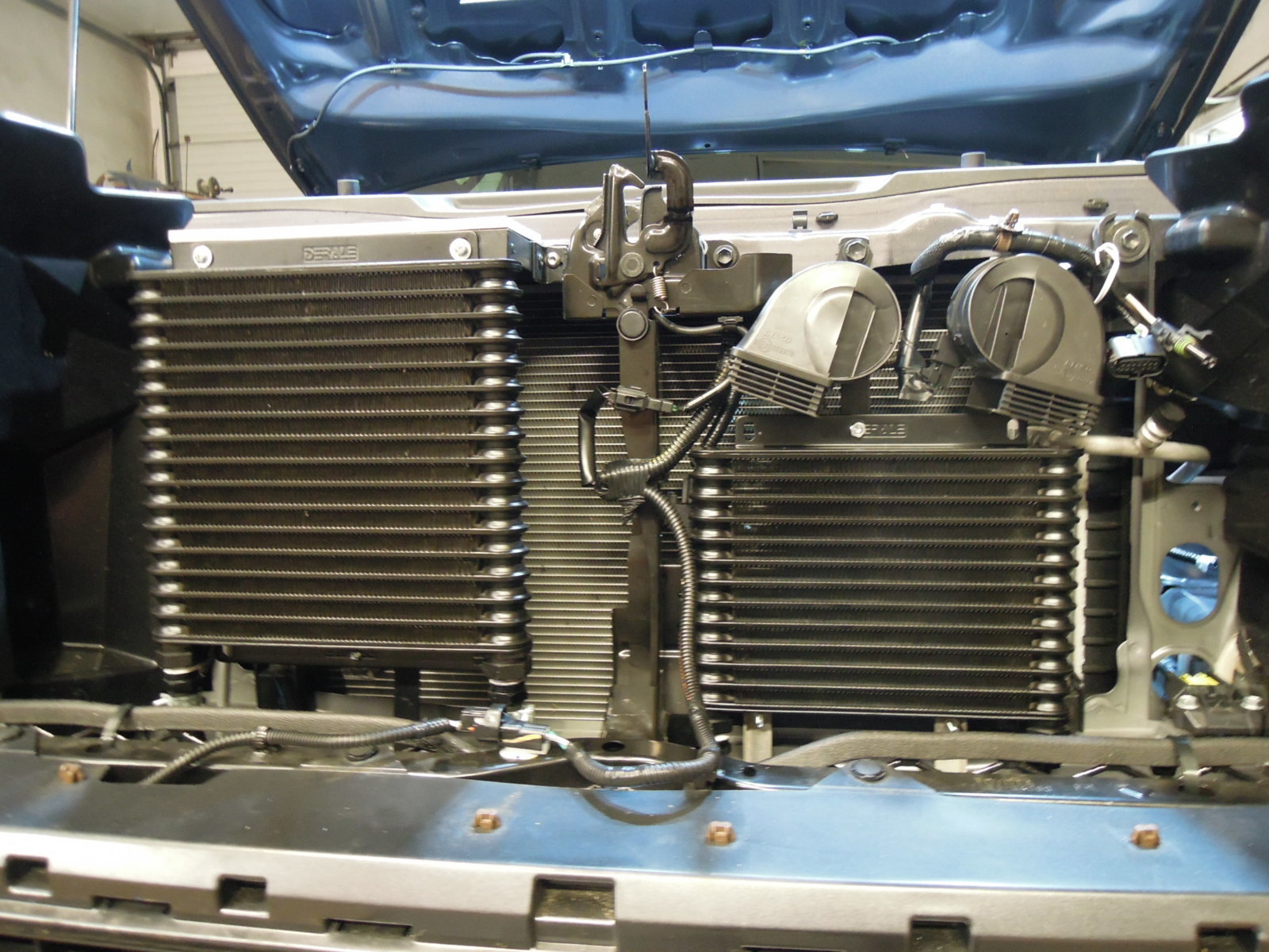

    I too was surprised that it was discontinued in my 21 Sport. But come to find out it was kinda useless anyway. I started with one large add on and then went to two. I am super pleased with the results. Maybe some helpful info. here. I bent up metal lines to the coolers and just used very short rubber lines to make the connections. All with double clamps. No worries towing a trailer now.
    https://www.tacomaworld.com/threads/easy-transmission-cooler-install.731014/
