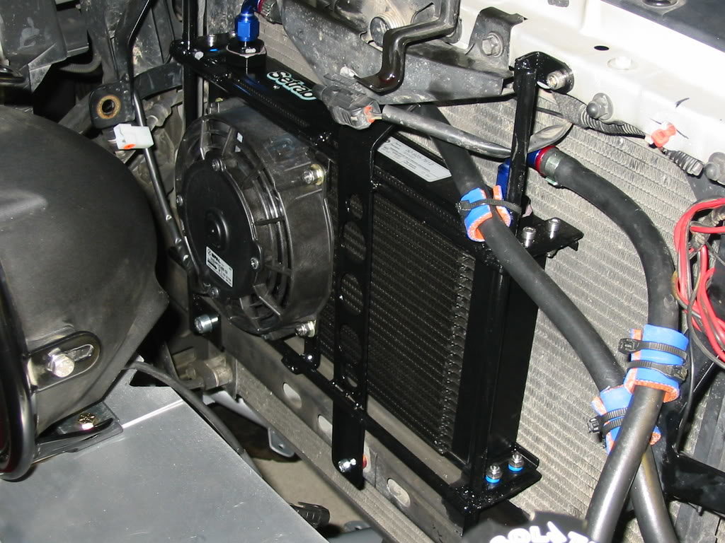

    Just go aftermarket its an easy install and greatly needed.haydons are decent , i used them years ago without issues
    i replaced the original sport tow package cooler with a large setrab cooler and fan. I then used the trd cooler as the power steering cooler.

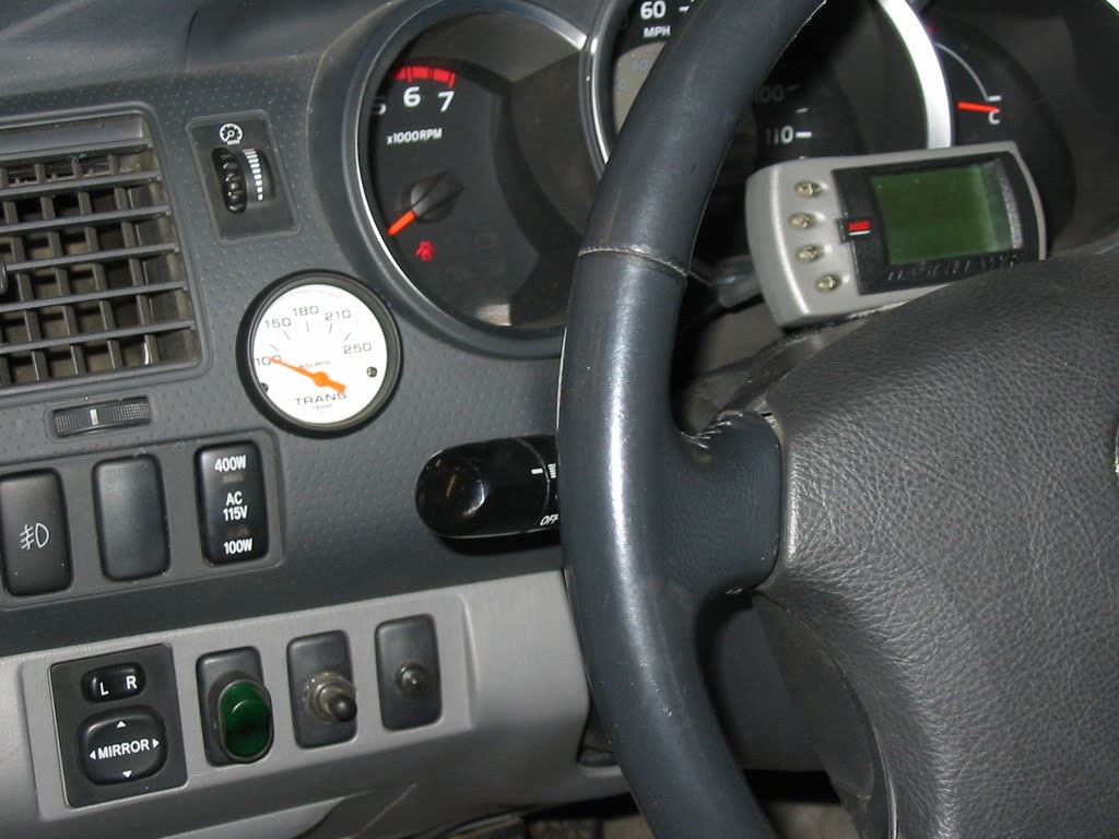

    its nice to have a temp gauge as well

    i still use the built in cooler thats inside the radiator. mainly to help with warmup of the trans fluid in cold temps. i have the hot line coming out of the trans to the rad/cooler then to the aftermarket cooler and then back into the transmission.
    just for comparison i took the radiator cooler out of the system to see where my temps went . it ran 10-20* warmer for daily driving and 30-40* warmer when i abuse it in the dirt up the local mointain.
    so untill i add a bigger or another cooler im keeping the stock cooler inline, ill take my chances with it failing
